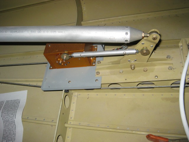

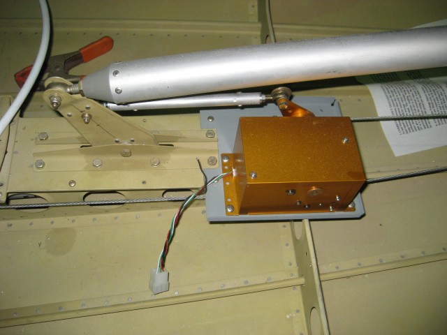

Finally downloaded my pics from the camera. Here's my install. The
plate has the left and right sides bent downward and the aft side is
bent up for stiffness. I used the 4 aft screws of the pivot plate, and
the one under the servo I countersunk. Any questions?

PostPosted: Thu Apr 30, 2009 9:42 am    Post subject: Re: RV-10 trio pitch servo install Reply with quote
Thanks Linn, looks good, what thickness of aluminum did you use for the plate?
Lenny

PostPosted: Thu Apr 30, 2009 9:58 am    Post subject: RV-10 trio pitch servo install Reply with quote
.060

PostPosted: Thu Apr 30, 2009 10:43 am    Post subject: Re: RV-10 trio pitch servo install Reply with quote
Dan,
Linn's photo is of the elevator mounting of the Trio servo.
Lenny

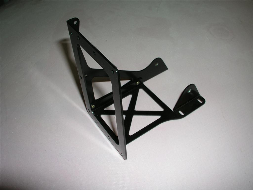

PostPosted: Thu Apr 30, 2009 1:40 pm    Post subject: Re: RV-10 trio pitch servo install Reply with quote
I'm not there yet, but they do sell a nice black anodized roll servo bracket.
I wish they would have given us a smilar bracket for the picth servo...
Lenny

Danny, Trio has a nifty bracket for the RV-10 aileron connection ......
saw it at Sun-N-Fun ..... and they wouldn't turn their back on it! It
does have a really short connecting tube.
Linn

PostPosted: Thu Apr 30, 2009 7:38 pm    Post subject: RV-10 trio pitch servo install Reply with quote
Okay thanks. I bought the complete kit from Trio (Hi Jerry!). It just seemed that the connecting rod was REALLY short. I want to get it correct before I put the last skin on the wing as it will infinitely harder to make adjustments once its riveted down. The mounting bracket is pretty nice. wish they had one for the pitch. However that will be relatively easy to fab. Dan
