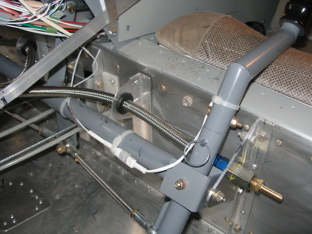

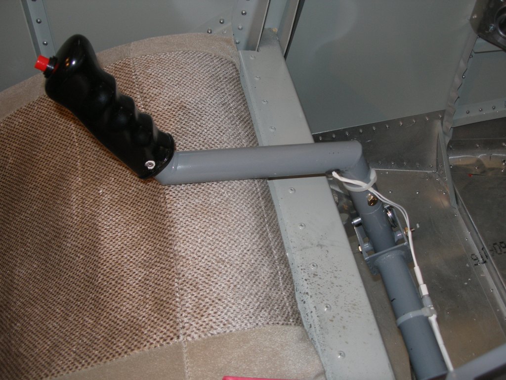

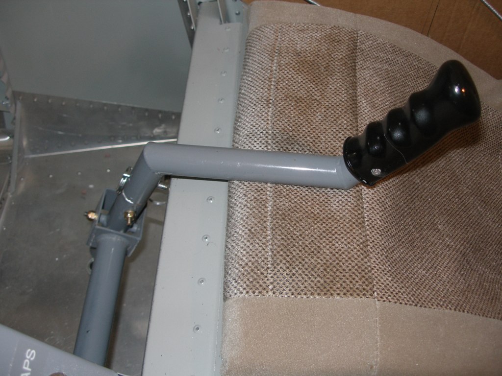

Jim,
I made both sticks removable. I wanted to be able to remove that right stick to prevent the accidental push or pull by my passenger. The other reason was for under-panel access. Some day, you are going to need to do some work in that cave and with a stick in the way, you are not going to get much done. I have already had both sticks off for that purpose.
I cut a piece of 4130 tubing for an inner sleeve. The top part of the sleeve is through bolted to the upper part of the stick and I fasten the lower part of the stick with quick-release pins. I had to do a little shimming of the joint to completely remove any "slop".
Jay Bannister
