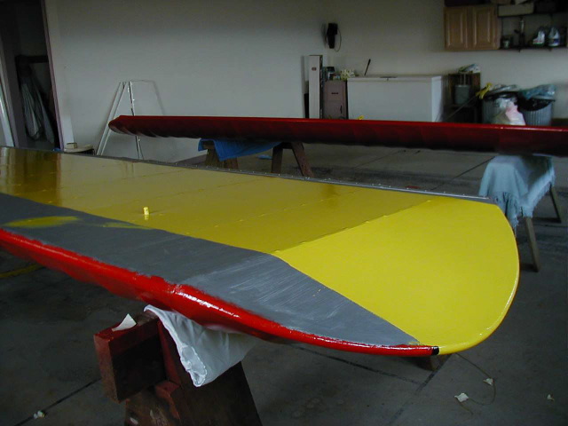

On Aug 23, 2009, at 9:30 AM, John Hauck wrote:
I have never flown a Kolb that could be flown with rudder alone, more than a very short time. When they begin to roll, rudder alone will not pick up tyhe wing. Because they lack any significant dihedral, if you lose aileron control, be nice to have a parachute.
John,
I can fly indefinitely and pick up either wing in a bank with rudder only in my plane.
I believe it is due to the Hoerner type mod I have done to my wing tips.
None of the other kolb planes that I have ever flown, have had that capability.
Gene Z

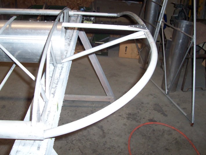

etzimm(at)gmail.com

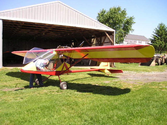

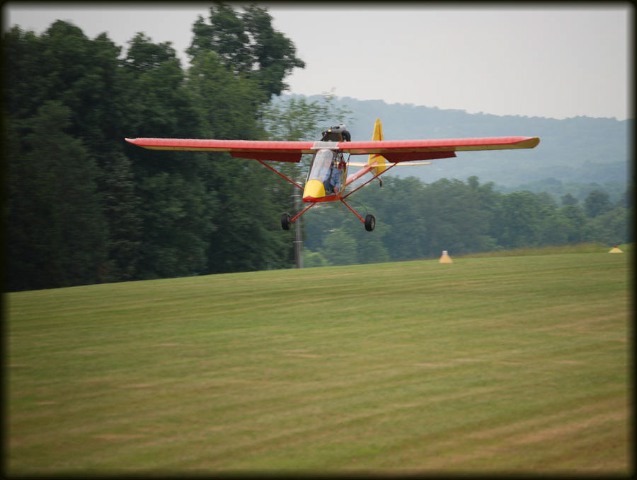

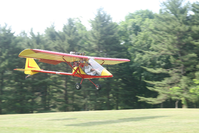

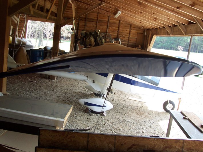

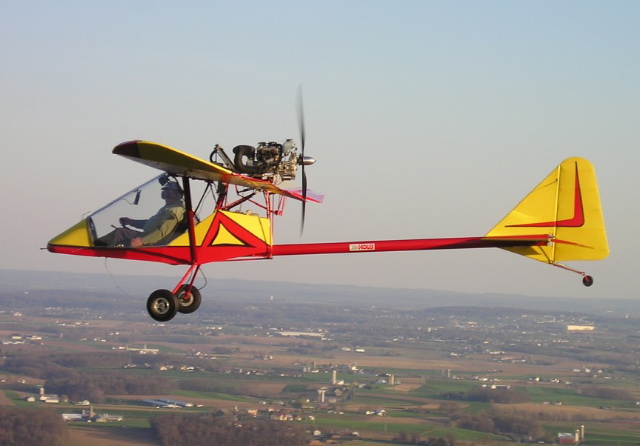

PostPosted: Mon Aug 24, 2009 10:10 am    Post subject: First Flight follow-up, Reply with quote
[img]cid:02E8ED0F-A811-48D7-9FDC-76F75B013671(at)gateway.2wire.net[/img]
[img]cid:3EB73288-70B7-4945-A45E-D3DBF54798A3(at)gateway.2wire.net[/img]
[img]cid:4F732969-C47D-4121-9E30-D495CC569329(at)gateway.2wire.net[/img]
[img]cid:1EF46A83-7A4C-44A2-9319-F04C79A68D92(at)gateway.2wire.net[/img]
[img]cid:C3CA1143-0A72-4678-A093-92F8CFF70F47(at)gateway.2wire.net[/img]
On Aug 24, 2009, at 10:33 AM, John Hauck wrote:
Gene:Didn't you also add some additional dihedral to your wings?
I don't have a photo of your Kolb handy.
John,
Gene Z

PostPosted: Mon Aug 24, 2009 10:27 am    Post subject: First Flight follow-up, Reply with quote
Looks good.
Glad it works.
Must be those tips.
Possums

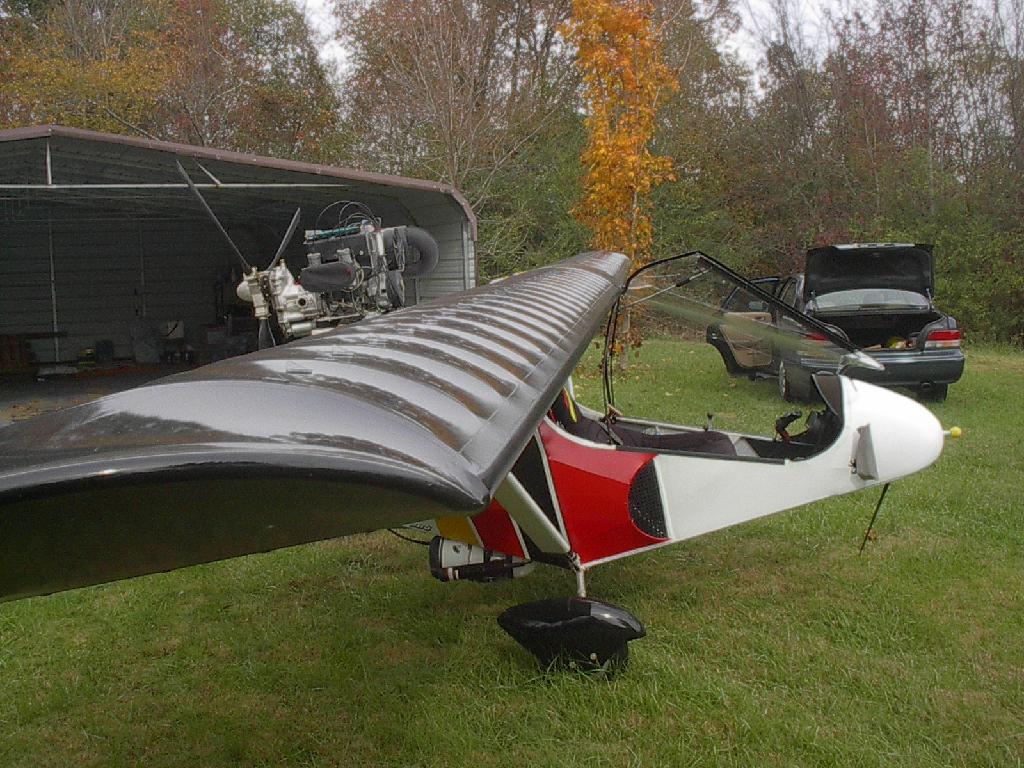

PostPosted: Mon Aug 24, 2009 12:10 pm    Post subject: First Flight follow-up, Reply with quote
At 09:38 AM 8/24/2009, you wrote:
John,
capability.
Gene Z
Yep - I'll bet it's the tips.
 Filesize:  70.45 KB
 Viewed:  4617 Time(s)
 Filesize:  158.32 KB
 Filesize:  94.53 KB
Possum

PostPosted: Mon Aug 24, 2009 12:24 pm    Post subject: First Flight follow-up, Reply with quote
Very nice work both of you. There may be a bit more vortex induced
but the stabilizing effect is worth it.
I'll wait until I hit something before I go in there.
BB

PostPosted: Mon Aug 24, 2009 1:11 pm    Post subject: First Flight follow-up, Reply with quote
From: "possums" <possums(at)bellsouth.net>
Damn, they're sprouting up all over.

PostPosted: Mon Aug 24, 2009 1:31 pm    Post subject: Re: First Flight follow-up, Reply with quote
Gene Z
Gene Z,
That is a really great Modification you did to the wingtips ! The stock wingtips are very poor, one of the few things Kolb got really wrong in the design of the plane. I know John H will take offense to this, but no plane on the planet is designed perfectly from day one, and even the best planes ever produced have been improved over the years. The Kolb is no different, a good plane, but still can be made a lot better. Any plane design that is not improved over time is at risk of becoming outdated and ceasing production. Once I saw the new wingtips Kolb put on the MK III Xtra, I have been thinking about what to do about my old style and inefficient wingtips. As it is now, the last 1 1/2 foot of each wingtip has no good airfoil and is basically wasted. The air coming over this non airfoil wing tip for the last 1 1/2 feet cant be doing the aileron response much good either. I like the Droop tips that Kolb is now putting on the MK III's, but I do not do fiberglass work that well, and I still think I can do just as well with hoerner type wingtips.
I did a lot of research on wingtips and thier effect on airplanes, and decided to put Hoerner wingtips on my MK III Xtra. I have even gone as far as to buy all the parts needed to do this from Kolb, and have them sitting in my Workshop. It is just a matter of finishing another plane before I do this project on my Kolb. Did you change your wingtips on an existing plane, or did you build the plane with them from day one ??? I would really be interested to get your performance numbers and any other differences you notice in flight characteristics.

PostPosted: Wed Aug 26, 2009 11:08 am    Post subject: First Flight follow-up, Reply with quote
On Aug 24, 2009, at 5:29 PM, Jack B. Hart wrote:
Gene,
Just some thoughts. There a couple of other factors that may help
you. Your
lateral cg is centered and this puts equal load on each wing. Also,
you
engine and propeller combination may weigh less than John's so your
vertical
cg is lower. Both of these factors will promote increased lateral
stability
given equal dihedral.
Jack B. Hart FF004
Winchester, IN
Jack,
The position of the cg does have a significant effect on roll
performance. However on my plane with the modified hoerner type wing
tips the cg is significantly lower than on my Mark II. giving it more
pendulum effect which works to resist rolling. To roll out of a bank
angle with rudder only the hoerner type tips must over power this
greater pendulum stability.
My Firestar with the hoerner modified tips will pick up a wing with
rudder only. On my Mark II will not, But The Mark II does have a
noticeably quicker aileron roll response, I believe primarily because
the cg is closer to the center of the wing's roll axis.
Gene
Dana
Joined: 13 Dec 2007
Posts: 1047
Location: Connecticut, USA
PostPosted: Wed Aug 26, 2009 1:48 pm    Post subject: First Flight follow-up, Reply with quote
That makes sense. The slanted underside of he Hoerner tips probably gives
a little dihedral effect, and it's dihedral (which stock Kolbs have little
or none of) that's necessary for rudder to induce roll.
-Dana
