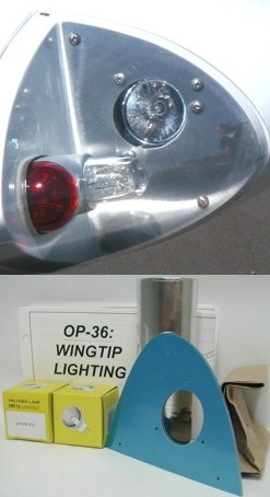

Check these out at the bottom of the page. This is what I am ordering. What I have ordered from these guys so far has been high quality.
http://www.kestrobes.com/beacon.htm#LL1

That is a big difference. I should go the cheaper route. Scott Schmidt has the HID's in the wingtip and I don't know why I should even look at anything else. Why do I need brighter than that? Maybe I will be able to afford my G900 now....NOT!
