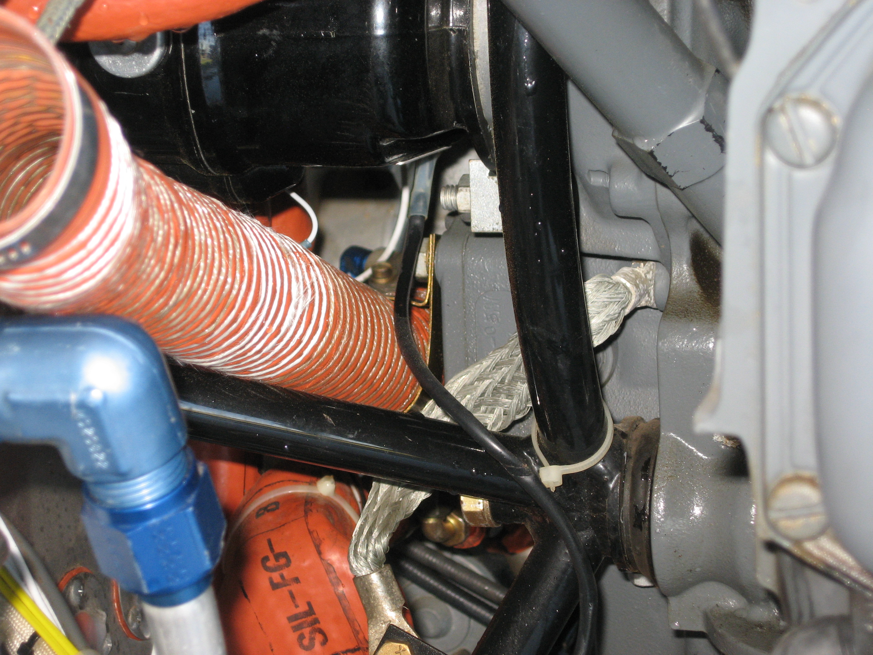

That big old red hose goes to, you guessed it, the fuel pump on another engine I changed on a super Decath this year. There must be a reason for these things.
So I might think about putting a good cooling hose to help out on cooling fuel.

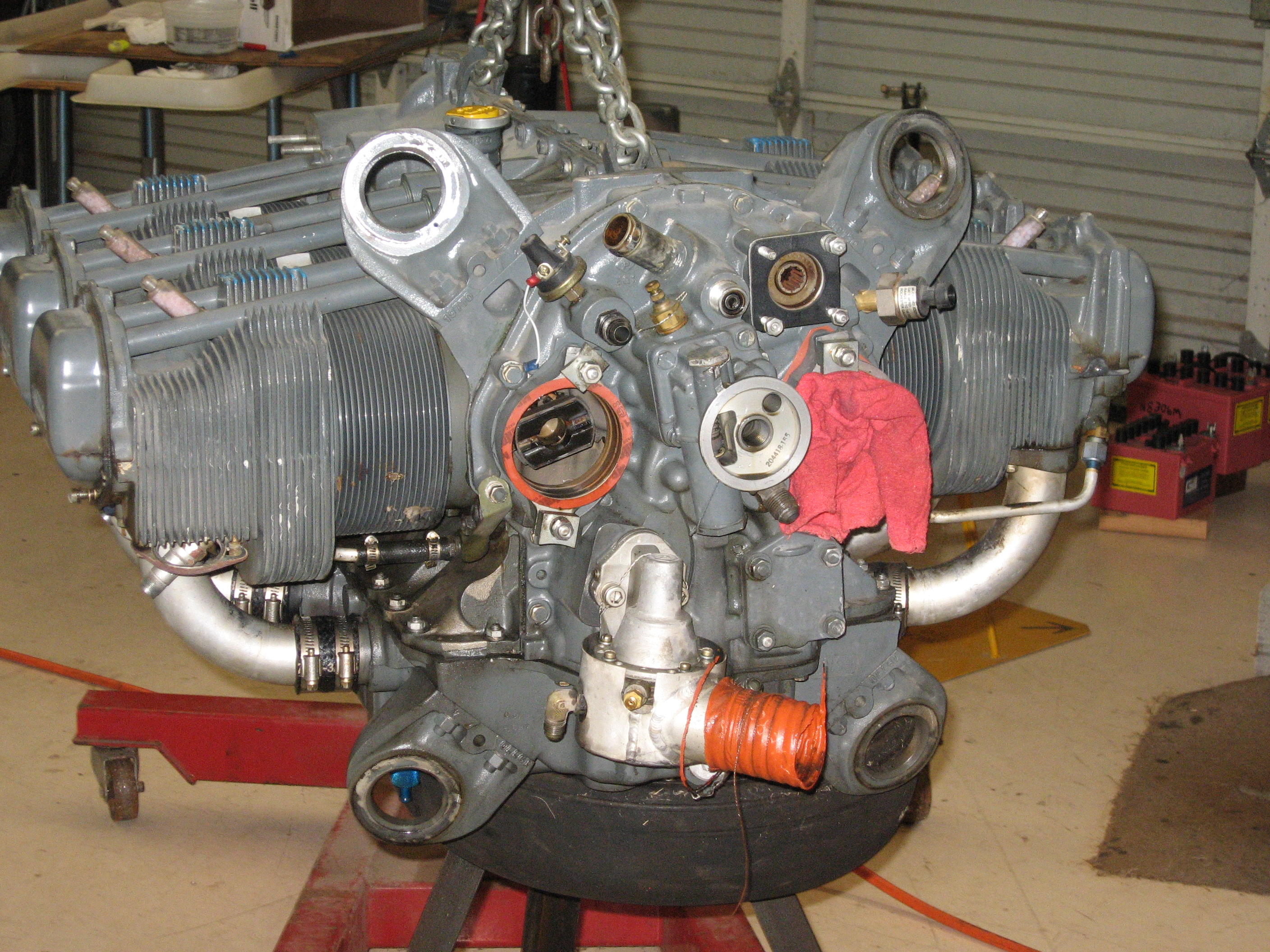

Here is another picture of a fuel pump on M7-235 Maule I changed earlier this year. big red hose for airconditioning of fuel pump.
Patrick Thyssen

You can get a similar cooling shroud for the pump on the 360/540 series from here….
http://www.aircraftspruce.com/catalog/eppages/fuelpumps.php
Michael

I've got one of those. Haven't installed it yet, but I have it.
Some day if I get real bored or ambitious, I'll put it on
and report back. Maybe years from now. I know if I ever pull
the engine I'll install it, but not sure if I will otherwise.
