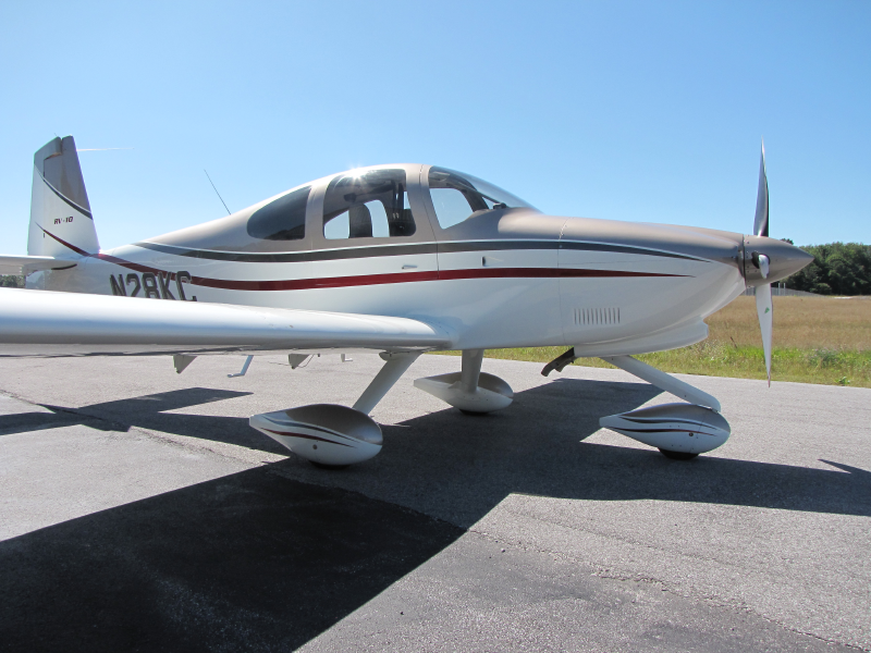

PostPosted: Tue Sep 29, 2009 9:21 am    Post subject: Ram Air Oil Cooler Inlet - input requested Reply with quote
Attaching a pic of my louvers. One on each side. Have 15 hrs on ac with new IO 540. After first 5 hrs CHT's have settled down to 350-380. Oil temps have never exceeded 190. Stock Van's cowl, cooler etc. In Vt so oat not like the southwest. Max temp flown 85. I believe the louver is a key variable. Built a Glastar with O360 with cooler on firewall. had a horrible time with oil temps and had to move cooler to front baffle. Did not use a louver but felt that could make a big difference which I think has been the case with the RV 10. The 10 is a great airplane.
