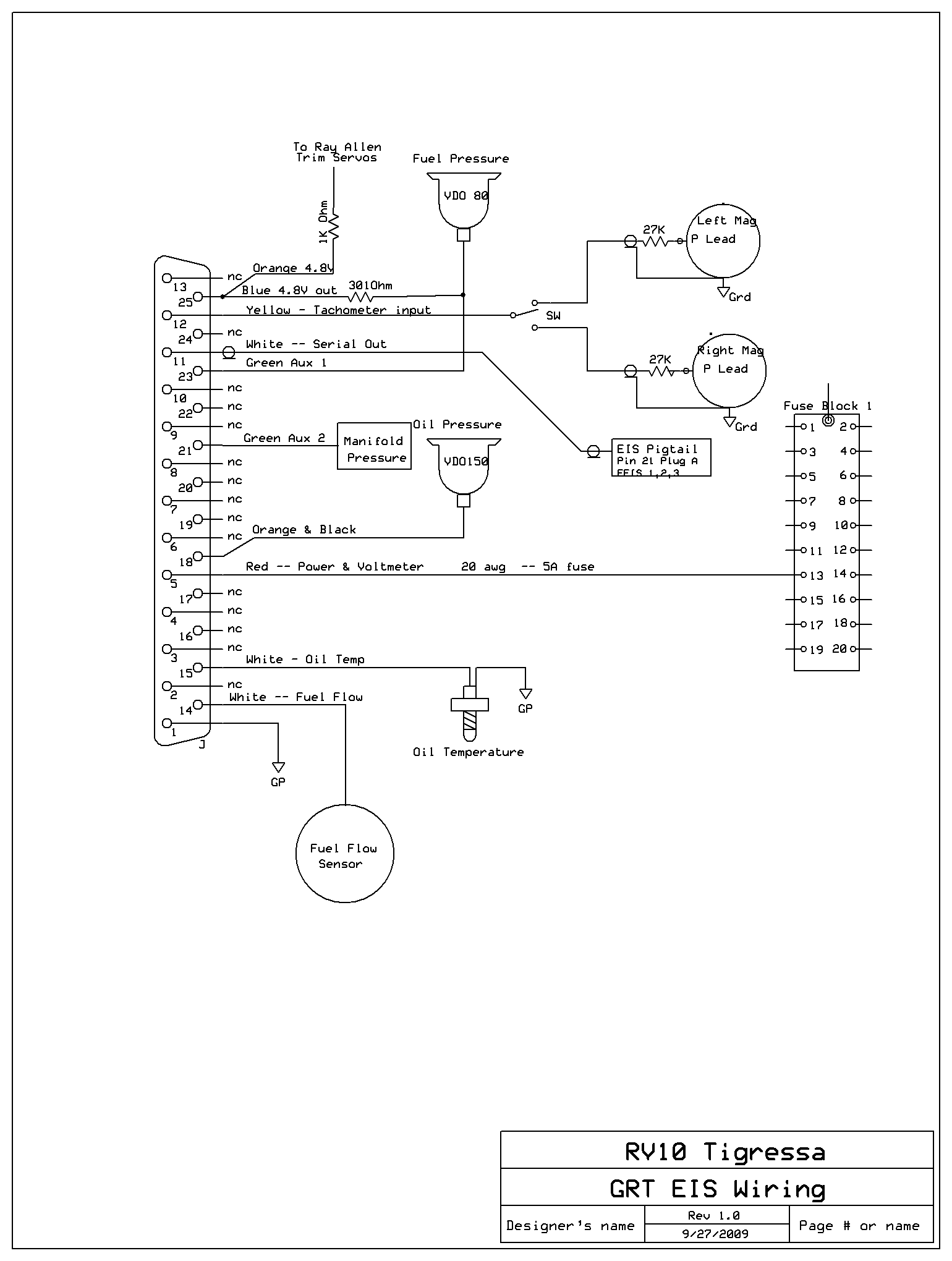

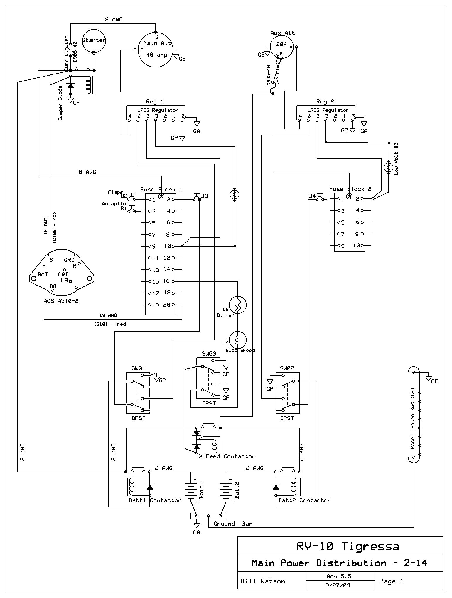

Some confusion here perhaps. I'm not using Visio - rather I'm using the
ExpressSCH product that Vern has linked to at his site. It does have a
bitmap export function which I just tried and attached the results.
Looks like that works ok.
