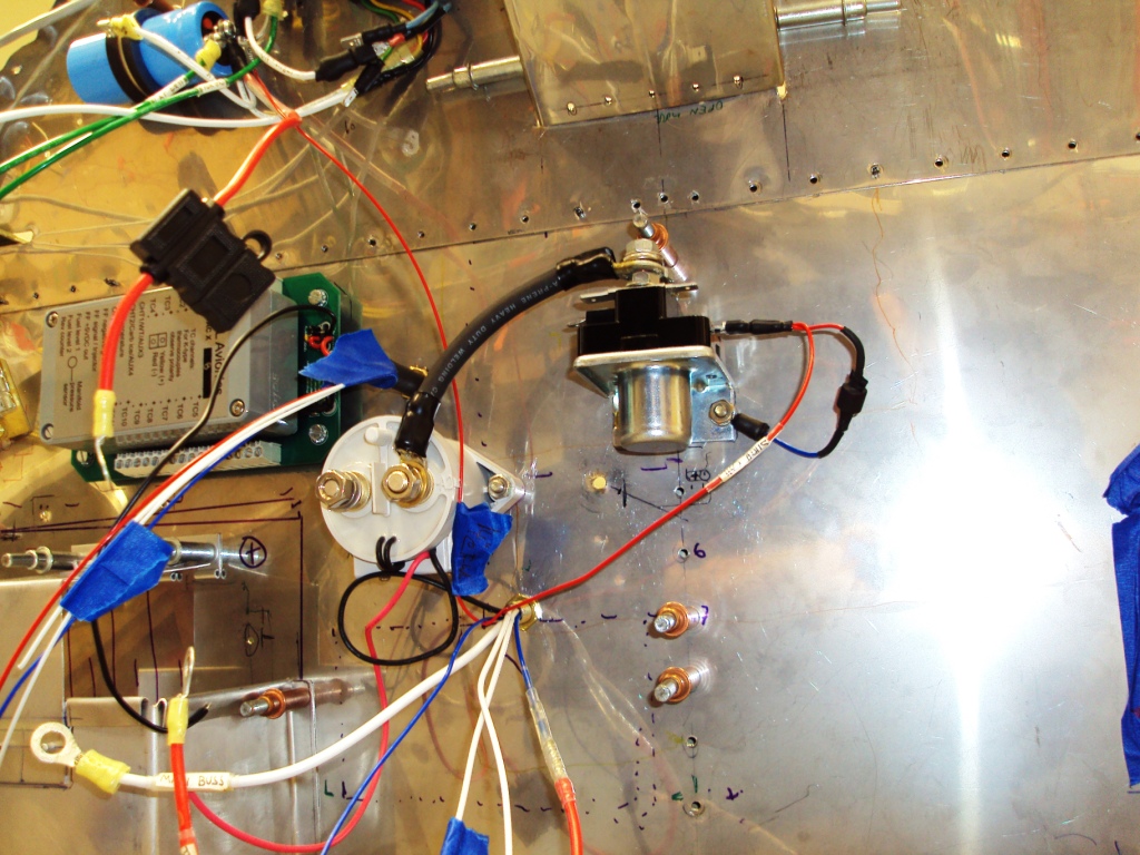

My pic shows the situation. The cable from the battery positive to battery contactor is also pretty short, but I can mount it with enough flex to make me happy. There'll be a little more flex when the 2nd hole is drilled after the contactor is rotated a few degrees counterclockwise.
I had not particularly wisely opened a couple holes for the starter contactor to 3/16, then ended up having my starter lead too short. That's what the 3/16 clecos go through. So I moved things over a couple inches and can use one of the bigger holes for the battery contactor.
I had hoped the starter contactor could use the other big hole, as shown in the pic, but there is a 3/4" square tube stiffener it would interfere with behind the vertical row of holes. Due to the starter cable length, I can only move the starter contactor to the right (referenced from the pic) and/or up. It only needs to go an inch or less to straddle the firewall stiffener, but the cable won't make it that far.

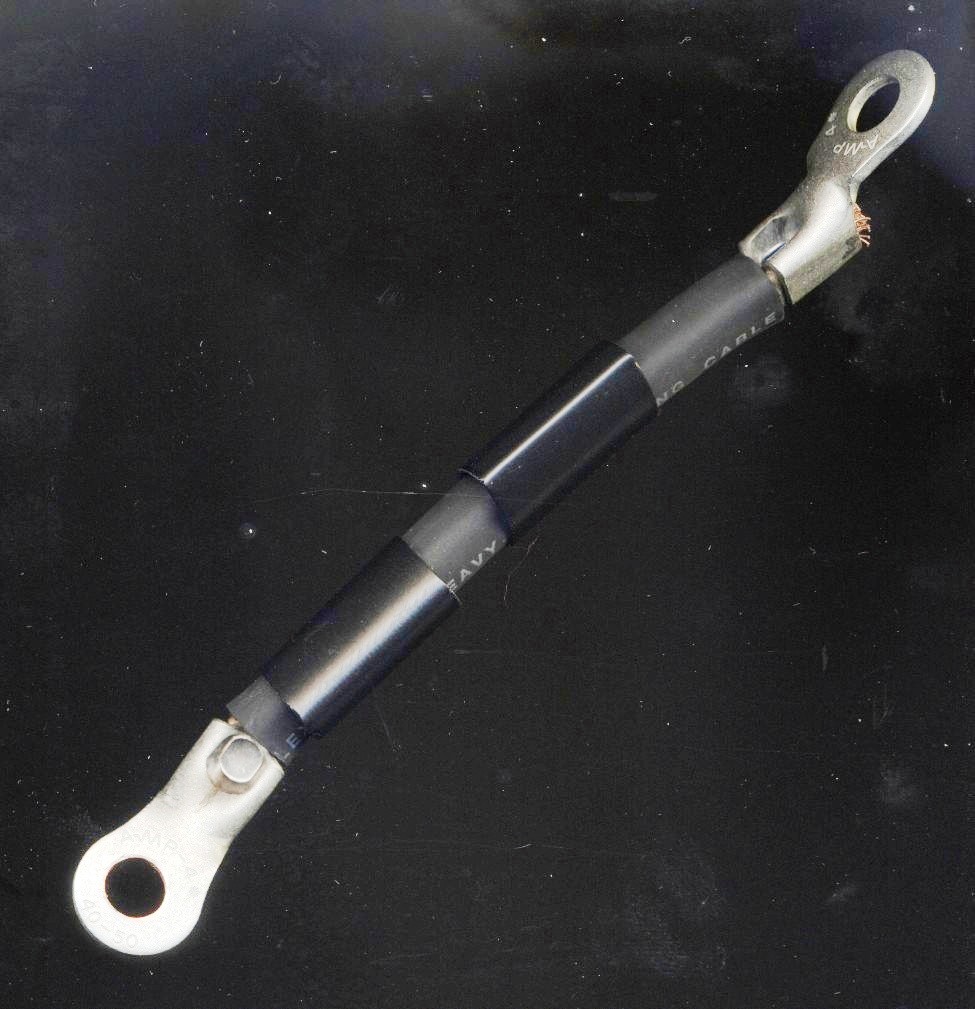

I ended up going with the cable. Cut the longer piece and took it to the hardware store where they crimped it for nothing. For good measure, I soldered the ends when I got it home. Fits nice with a good arc to it.
Dan
messydeer
Joined: 13 Feb 2006
Posts: 214
Location: Bellingham, WA
PostPosted: Sat Nov 28, 2009 11:15 am    Post subject: Re: Can a 4awg cable be too short? Reply with quote

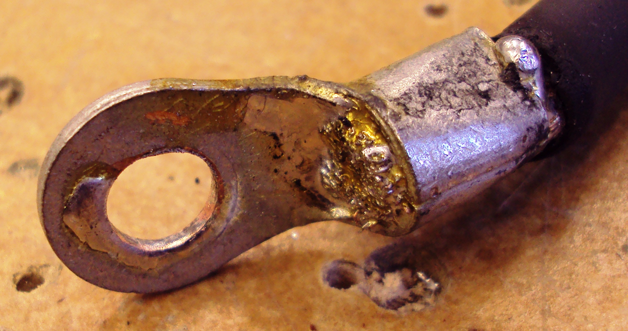

Here are some pics of the new cable. The hand crimping tool they used had was like a bolt cutter, with long handles. The indentation left was roughly a 3/16" cube.

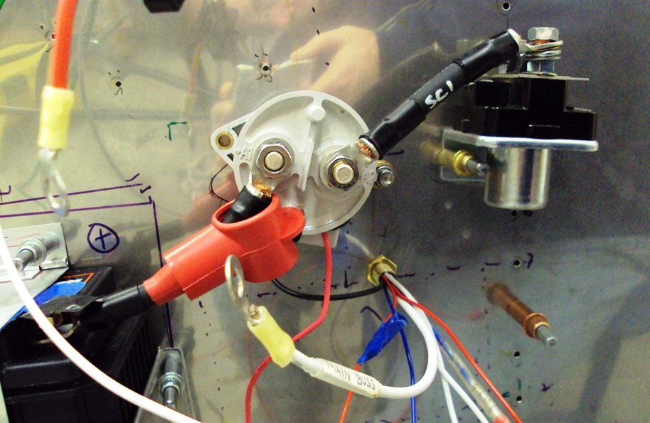

last pic
