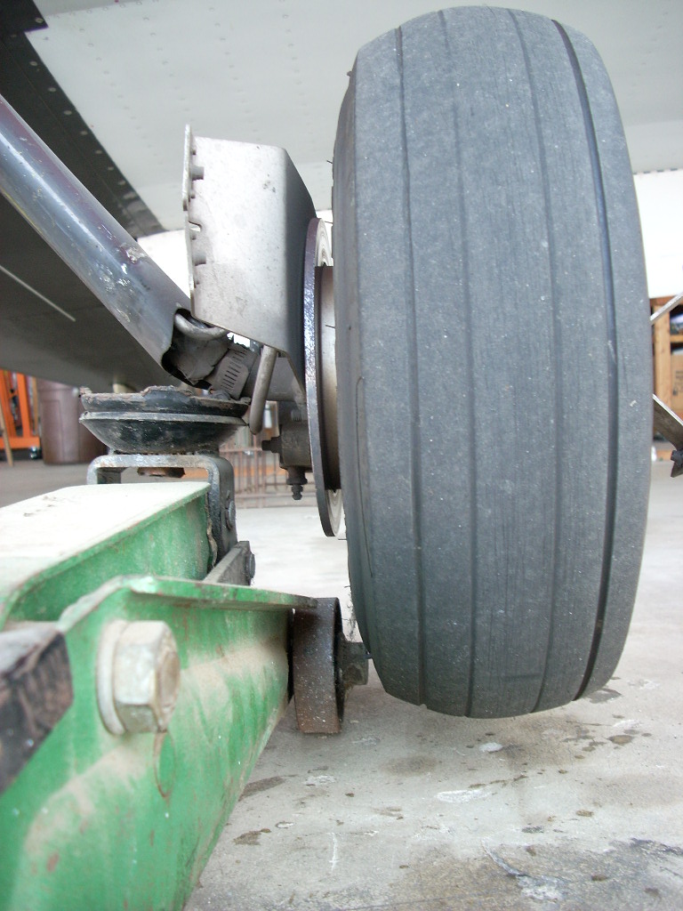

PostPosted: Wed Dec 16, 2009 10:00 am    Post subject: Jacking up an RV Tail Dragger? Reply with quote
I just purchased a 18” long piece of ¾” or 5/8” (can’t remember) steel rod.
I drilled out the axle nut, placed the steel rod in the hole of the landing gear at the axle nut.
I then just used a floor jack and placed the pad of the floor jack under the steel rod (there is room) and jacked up the plane enough to remove the tire and wheel.

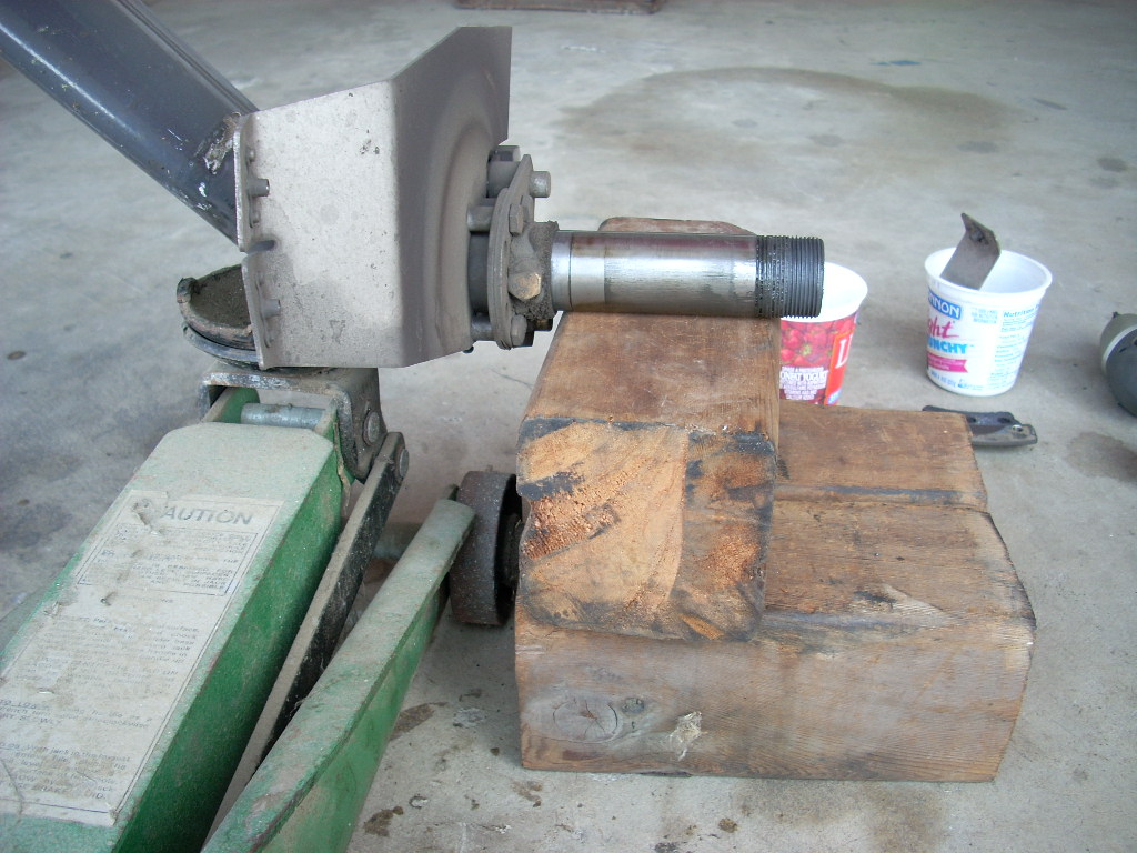

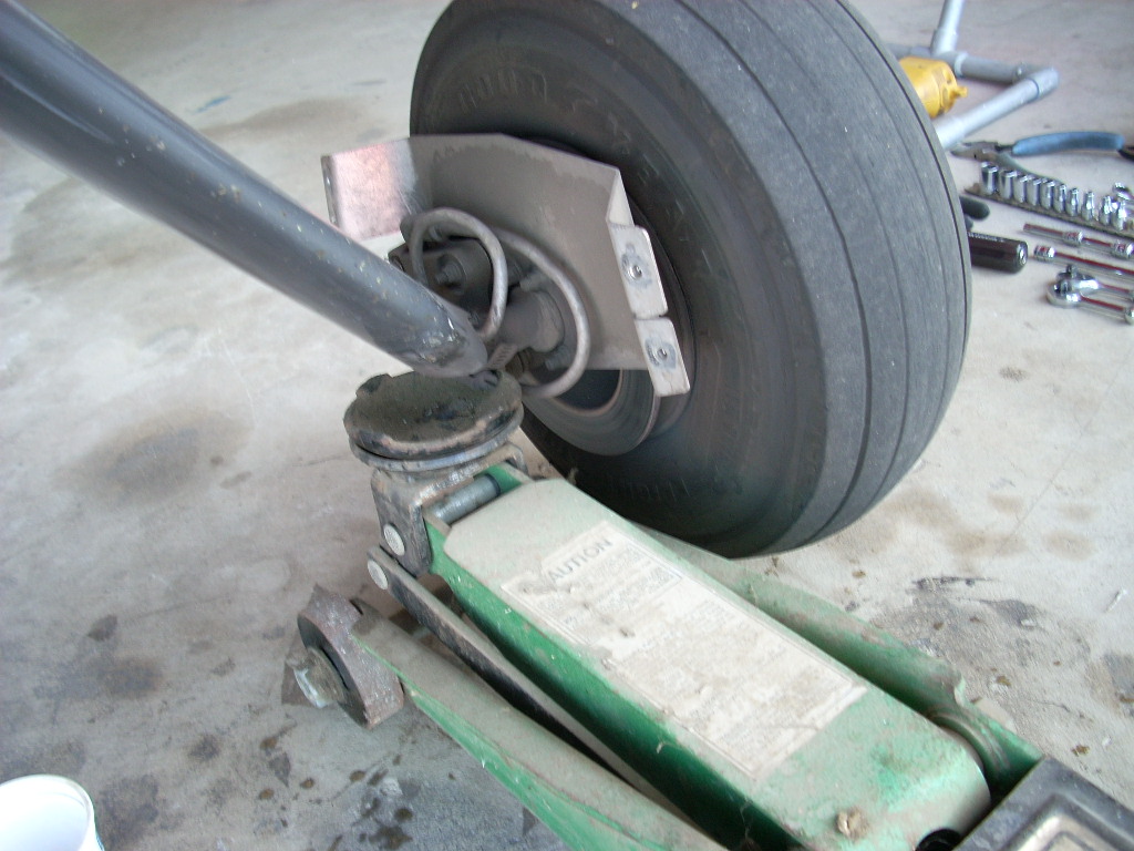

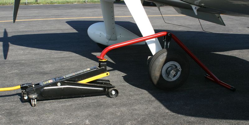

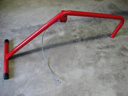

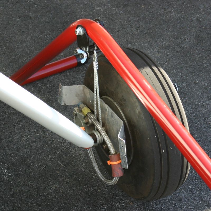

altoq(at)cebridge.net
PostPosted: Wed Dec 16, 2009 5:50 pm    Post subject: Jacking up an RV Tail Dragger? Reply with quote
Don't know where I got these pictures. Probably for sale somewhere, but looks easy enough to make.
John D.

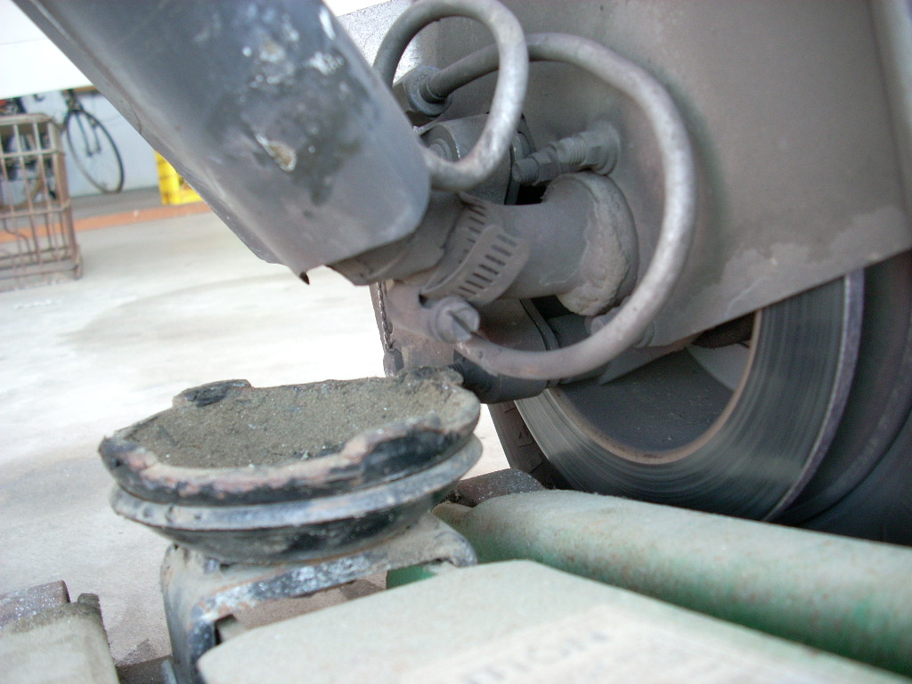

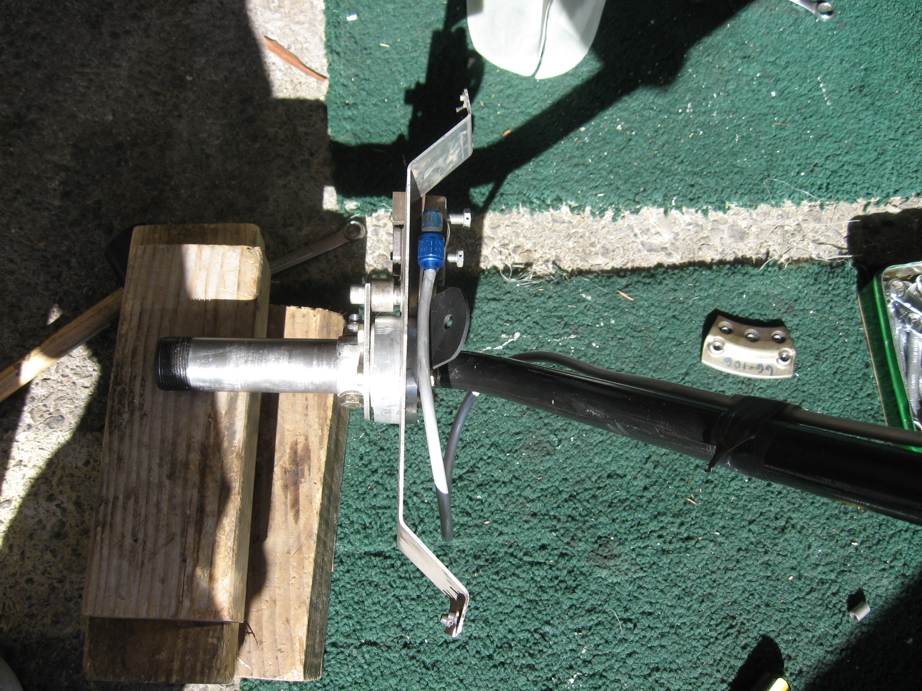

PostPosted: Wed Dec 16, 2009 6:06 pm    Post subject: Jacking up an RV Tail Dragger? Reply with quote
For the past 12+ years C I have placed a stainless steel hose clamp on the landing gear leg and use a cheap car floor jack to jack the airplane up for tire changes.  I place several 4 X 4 boards under the axle to support the airplane while I work.
Gary A. Sobek
John D.
