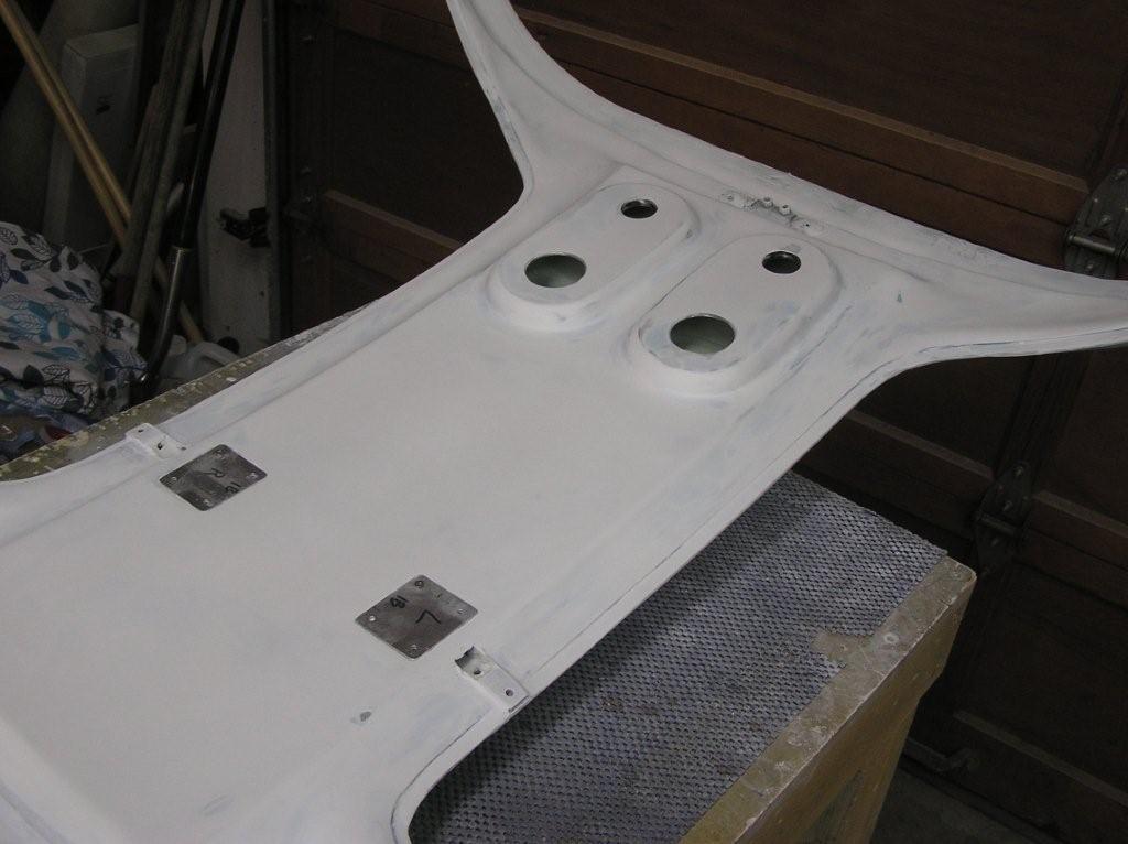

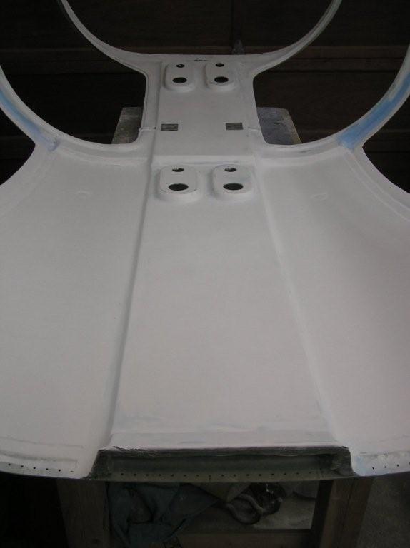

Attached are a couple of photos of my "amateur built" console that was built
using John's technique. It took a more than a few hours but was good f/g
practise for a neophyte. I am, now more comfortable with f/g although I
still hate sanding the damn stuff.
I plan to have the canopy interior painted in a couple of weeks by a
professional shop. Painting is one thing I don't want to do because I don't
the requisite skills or equipment. and expect it to look quite respectable.
The "long runs" were fabbed using 3/4" foam about 12" wide. The raised vent
holders were fabbed from shaped foam.
The holes in mine are for eyeball lights and Steins eyeball vents. Speaking
of vents, don't bother with anyone else's vents. I bought some Aveo vents
from ACS and sent them back and got Stien's which really are far superior.
Cheers
Les

Those look nice Les. If I had to order today I would buy Stein's with the black vents and map lights. I am very interested in the carbon fiber one. I didn't realize that I should fit the cabin top and then mount the console. That sounds logical. I am just finishing section 29 so I will be ordering soon. I hope the carbon fiber one will be available by the time I am ready.

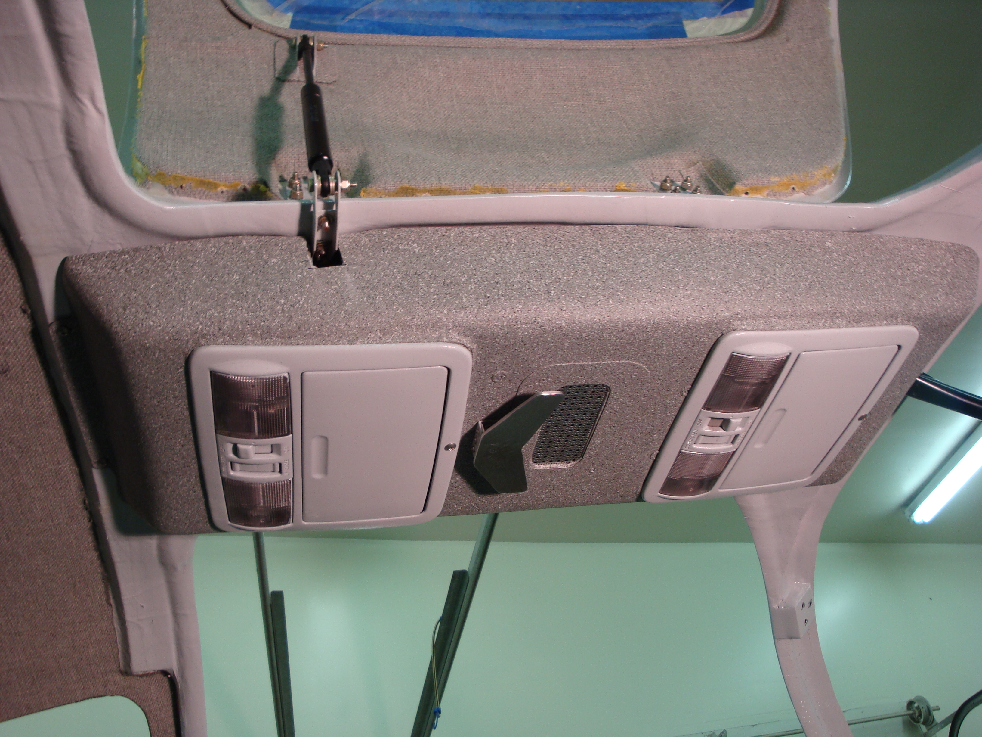

Our f/g overhead...went with the short version Very Happy
Walt Fuller
