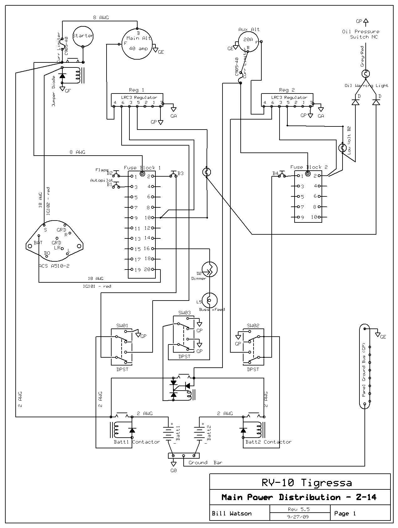

I like the AML 34 switches and AML 41 indicators too. Here's my Z-14
design and specs.

I was looking at the Z-14 diagram and see that I used a standard key
switch for the starter and mag switching in place of the S-700-2-5 (in
5/9/06 revision it is an S-700-2-7).
A pic of my panel can be found here:
http://www.vansairforce.com/community/showthread.php?t=18921&page=13
Have fun with the electrical design. Everything you need is here in
Bob's world. Quite a resource.

I am not sure about your reference to a connection to a
voltmeter, but Bob's Z-14 drawing has the S700-2-7 switch labeled as
STARTER/CROSS-FEED. There is a light to the left of the switch which will
illuminate whenever the cross-feed contactor is activated. This light will
illuminate when the switch is pushed up, to activate the starter,
simultaneously activating the cross-feed contactor, so you use both
batteries for starting. When the switch is pushed down, it will activate
the cross-feed only, tying the two batteries together, but not activating
the starter.
Hope this is the info you were looking for.
