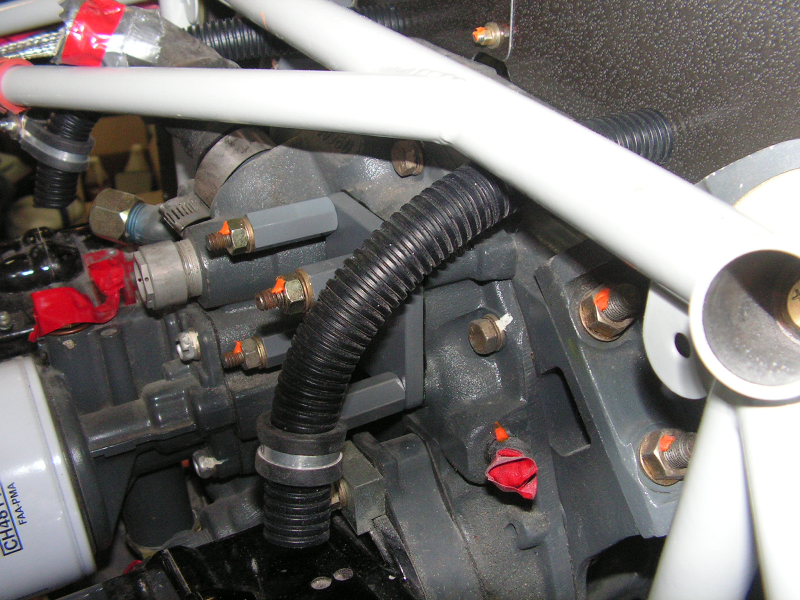

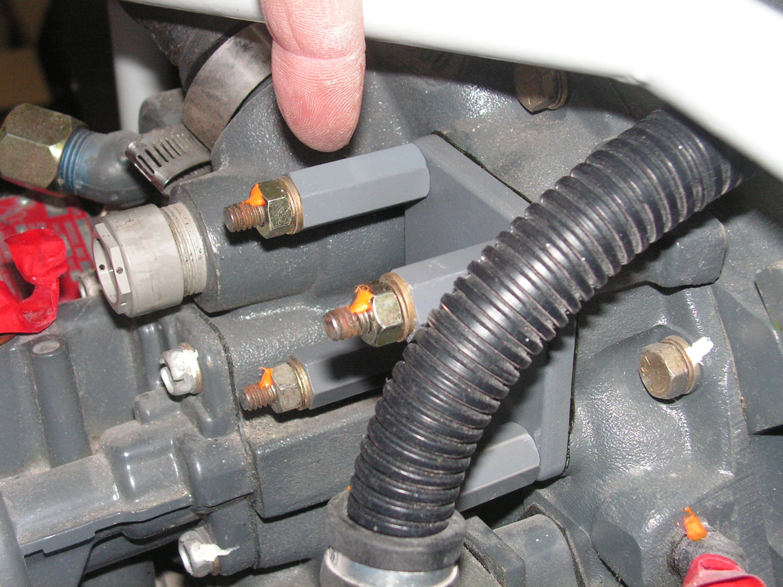

PostPosted: Mon Dec 28, 2009 8:44 am    Post subject: mag blow tubes Reply with quote
Hi Cjay C
Here are some pictures of what I did. The left one is hooked via cushion clamps to the engine mount and the right one is hook to the bolt stud that would hold the vacuum pump.
Vern Smith (#324)

PostPosted: Mon Dec 28, 2009 10:25 am    Post subject: mag blow tubes Reply with quote
In case it is not clear from the pictures C the air is ducted just over the outside not into the mags. As a side note depending on your engine monitoring system the "logical port" will be used for an electronic tach pickup.
