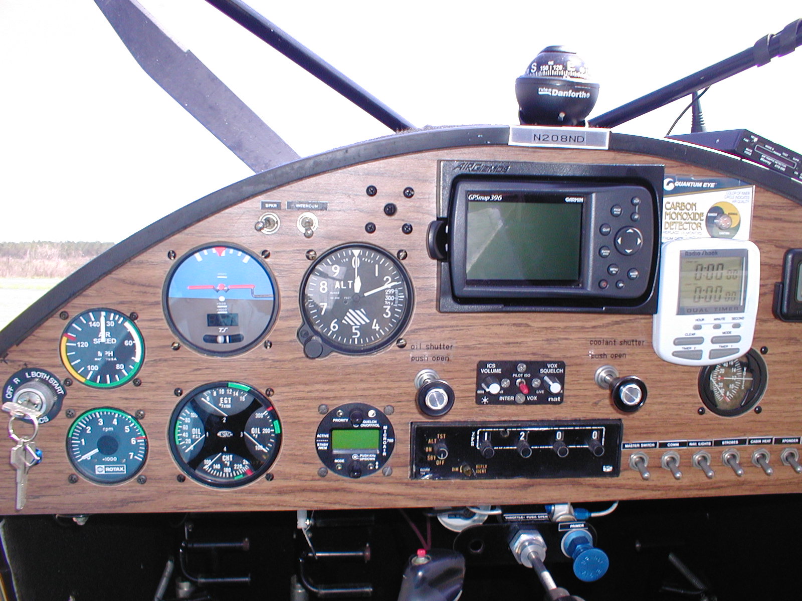

PostPosted: Sun Jan 03, 2010 7:14 am    Post subject: water temp guage Reply with quote
Paul,
By T-stat do you mean thermostat? Unless I am having a senior moment (I have many) I am not aware of a thermostat in the 9 series (unless you install an oil thermo) If there was one it wouldn't take 5-8 min for my engine to warm up enough to fly, or check the mags.
I also have the quad gauge that includes the CHT.The CHT pretty well equals a water temp gauge although both would be useful for comparison.
    Dick Maddux
