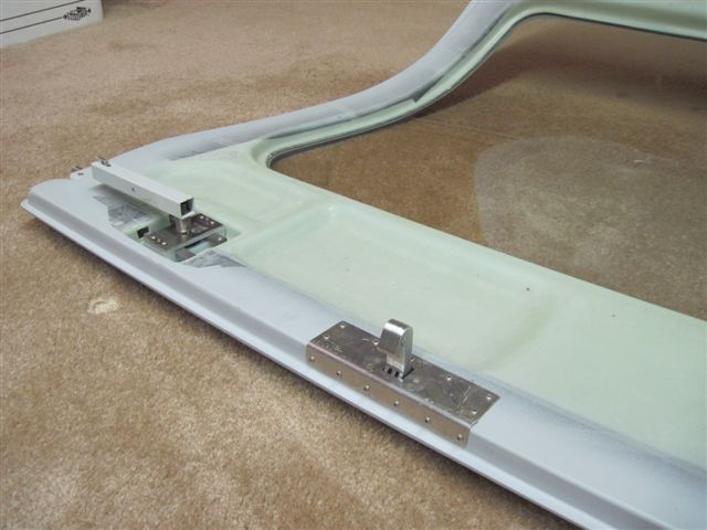

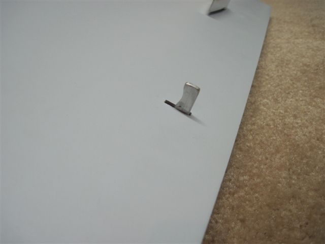

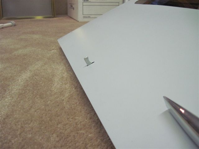

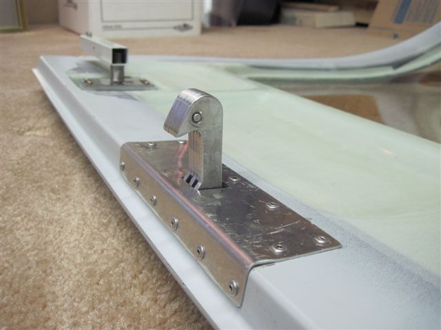

Attached are photos of the new door safety latch, which I think are self explanatory. It is my understanding that everyone with a finish kit will have their parts and drawings by the end of next week. The only thing I would consider changing is to increase the angle between the legs of the springs that you will fabricate. My personal preference would be for a stronger spring loading of the latch. I don't have a way to scan the large format drawings, but will try to photograph them and get them posted later today.

Who's going to be the first vendor to make the door safety latch kit parts
available with various stylistic improvements!!! Come on you know that hook
looks so utilitarian... dare I say Dutch! Wink
What about warning lights, switches, buzzers... oh my!!
Tounge in cheek of course.

When you are inside of the plane and want to open the door, how do you open the latch? Do you grab the edge of it. What am I missing here? Oh ya and you are on fire!

I for one would like something that would make that lever on the outside a little more streamlined and less ugly. This should be fun with my already covered doors. Razz

Hmmm
At least the Staniforth design had provision for opening on the interior. I
could see this getting jammed closed in the event of an accident - or at
least being very difficult to open.
What would really be nice would be the ability to open the door using the
main door handle and having this keep the door *slightly* ajar prior to an
off-field landing. On my Cherokee, part of the off field checklist is to
unlatch and unlock the door so it does not wedge shut in the event of an
accident.
Not knowing how tight this will hold the door, I am wondering if we are
trading on problem for another.

I agree its double ugly!

What about attaching a 'grab strap' to the inside door catch? It would
serve for both opening and closing the doors from the inside?

I'm thinking of playing games with the color scheme. (Aka: alodine every other layer. Or alodine one layer darker than the other.)
Or even anodizing with a color that complements the interior.
I'm sure we'll have some machined versions soon though.

I saw this scottish influence personally. Anybody else see the
resemblance? I'm going to call it the Nessie Latch.

I find it rather ludicrous to build an efficient airplane only to hang
the handle and a speed brake on the outside of the door. IMHO, it's a
poor solution at best.
today.
