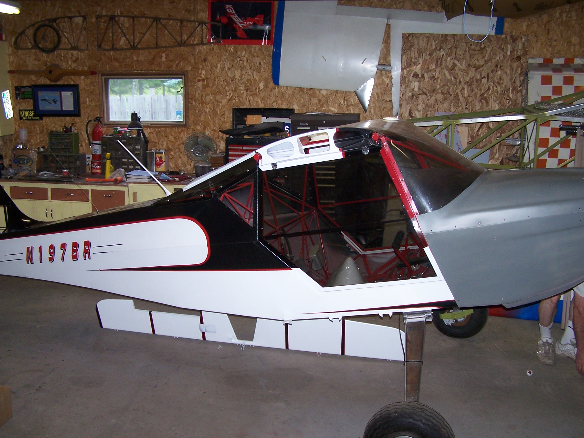

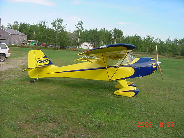

7suds(at)Chartermi.net
PostPosted: Sun Feb 21, 2010 1:33 pm    Post subject: wheel tracking Reply with quote
Guys,
Not trying to be controversial or say I know better than anyone else how to setup gear legs, just my 2 cents worth on what I did on my last model 4 with bungee gear and I was pleased with the handling results. I set my wheels so they were between straight and slightly toed out. My reasoning was based off some experience I had racing snowmobile ovals. The reason being as you entered a corner and if your weight got shifted hard to the outside of the sled for whatever reason (which sometimes would happen hitting ruts and holes) you did not want that outside ski to dart the sled back to the inside since your weight was already headed in the other direction, it would jettison you from the sled for sure. My thoughts were to apply the same thinking to the tail dragger, if you get a little squirrelly on landing and the plane rocks to the outside and loads that gear, I did not want it darting the plane back the other way. So that is why I set up my gear as such. It worked great for me. I have landed my 4 at a variety of paved strips in cross winds of 15 gusting to 20 (that’s another story) and have never had a problem with ground handling or the plane getting squirrely on me. But as has been stated here before, in the end it is all about what works for you and experimenting with what is not working to get results you are happy with, so with that said, here is something else to consider / ponder as you seek the perfect setup. Also, I have heard it said that setting up the gear slightly toed out would cause your bungee gear to track out and slightly collapse the gear, for me I did not find that to be the case, however, my build was 537 pounds empty.
Lloyd Cudnohufsky
Model 5 912uls IVO IFA
Northern mi. /
A work in progress
well it dos feel squirrelly on landing I will look into taking measurements to decide if one is out of tow moor than the other. and i have already turned the tires around thank you for youre input mal
Malcolm Brubaker
Michigan Sport
Pilot Repair
LSRM-A, PPC, WS
(989)513-3022

PostPosted: Sun Feb 21, 2010 2:01 pm    Post subject: wheel tracking Reply with quote
As long as you brought it up. I Agree! I flew an Aeronca Chief for a while that had one main a bit toed in. Every time the weight shifted to that side the wheel wanted to track right under the nose and th opposite wing tip would head for the sky. Was fine in a crosswind as long as it was from the correct side. ;o) Larry Huntley 4-1200 Soob 500hrs+
Larry Huntley,Dundee,NY
Kitfox 4-1200 N234EE
EA81,AMAX Redrive Warp 3 blade
Fox5flyer
PostPosted: Sun Feb 21, 2010 2:10 pm    Post subject: wheel tracking Reply with quote
Nice airplane Lloyd. I agree with your assessment 100 percent and you explained it very well. I personally wouldn't recommend that anyone with a taildragger have any toe-in at all. Zero. Neutral to a little toe-out is best, in my opinion.
Deke

Thanks for the compliment. That was my Model 4 XL, attached is a pic of my Model 5 I am working on. (Shooting to have it in the air this summer) It is a little bit farther along than the picture. Tail feathers, wheel pants and cowl are on and the cowl painted. I have one wing to finish repairs on and paint and both wingtips to repair. I am currently installing the IVO IFA Prop, I’m changing the brush location for the prop pitch motor so it is transferred through the hollow gearbox main shaft to behind the gearbox.
Lloyd Cudnohufsky
Model 5 912ul IVO IFA
Northern mi. /
A work in progress
