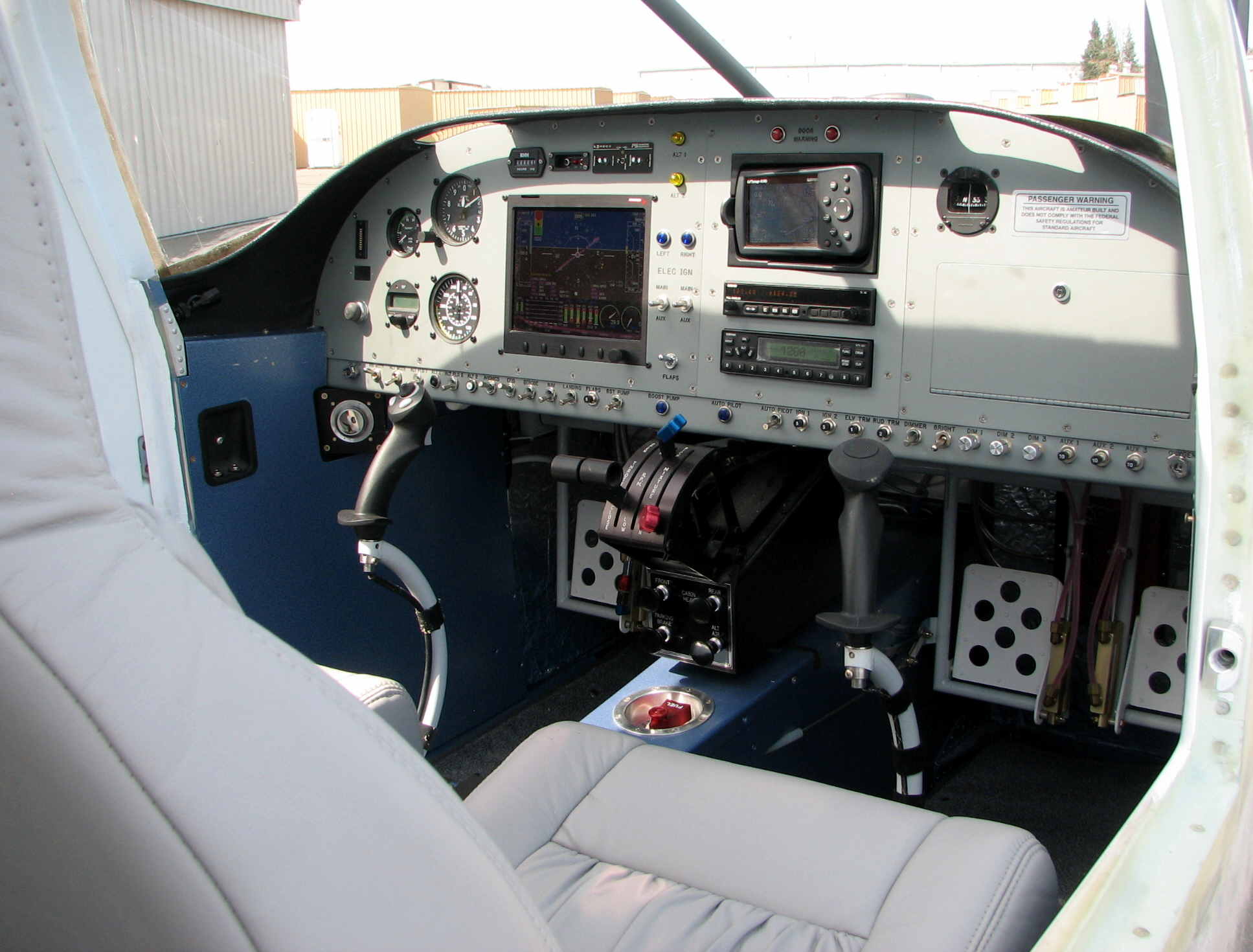

I've trial fitted it and found that the stick has to be modified in some
way to clear the panel. I bent mine in a press. Others have re-welded it.
I'm not sure if any of the stick tops or any of the alternate panel
setups end up without requiring some mod of the stick.

Jae, if you zoom in on the pic attached, you will see what I did to make them clear the panel... they go right under and clear by at least .050".....Not that I will ever need to push the stick that far forward. I might have slightly modified the connection on the bottom... just can't remember. But they work fine, no issues.

I have the CH, now Tosten grips. They work fine and mine just brush the
switches and CB's on the panel at full forward. I cut the sticks a low as
they would go to install the grips. FWIW, nothing against them but on my

Bill, I have them and love them. I have them rotate and fits my hand
perfectly. I did have to reform the stick to prevent them hitting the
panel, but I have a Stein panel so don't know if they would hit the regular
one. I too did not need or want all those extra switches.

feature. I have a Stein panel blank too and I had to do the bending of
the stick to get it to clear but it seems to work in my pre-flight cockpit.
