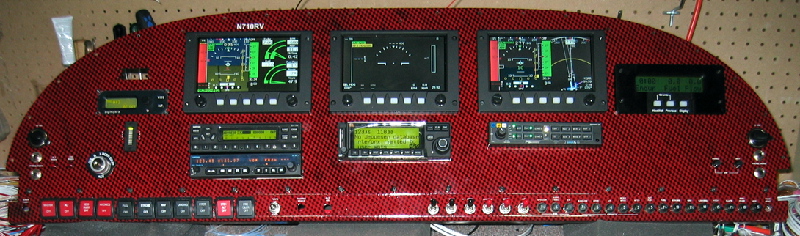

Stein charges $5,000.00 for doing a panel, unless he has gone up on his price, and worth every penny.
Russ Daves

I paid about $55k for mine from Avionics Systems.  Think they have a picture of mine posted now.  First time I've ever held a Lexus in my hands......
But, I designed and got what I asked for.  Could not have done this same panel myself.

I cut the panel for my -7A and wired all of the avionics from schematics downloaded from the web. Result is at:
http://array.ucsd.edu/rv7a/panel.html
and
http://array.ucsd.edu/rv7a/2003-02-16_panel2.jpg
Took about 200 hours to do all of the design, cutting, wiring and painting, but it was one of the really fun parts of the project. Plan to do the same for the -10.
-Dan Masys
