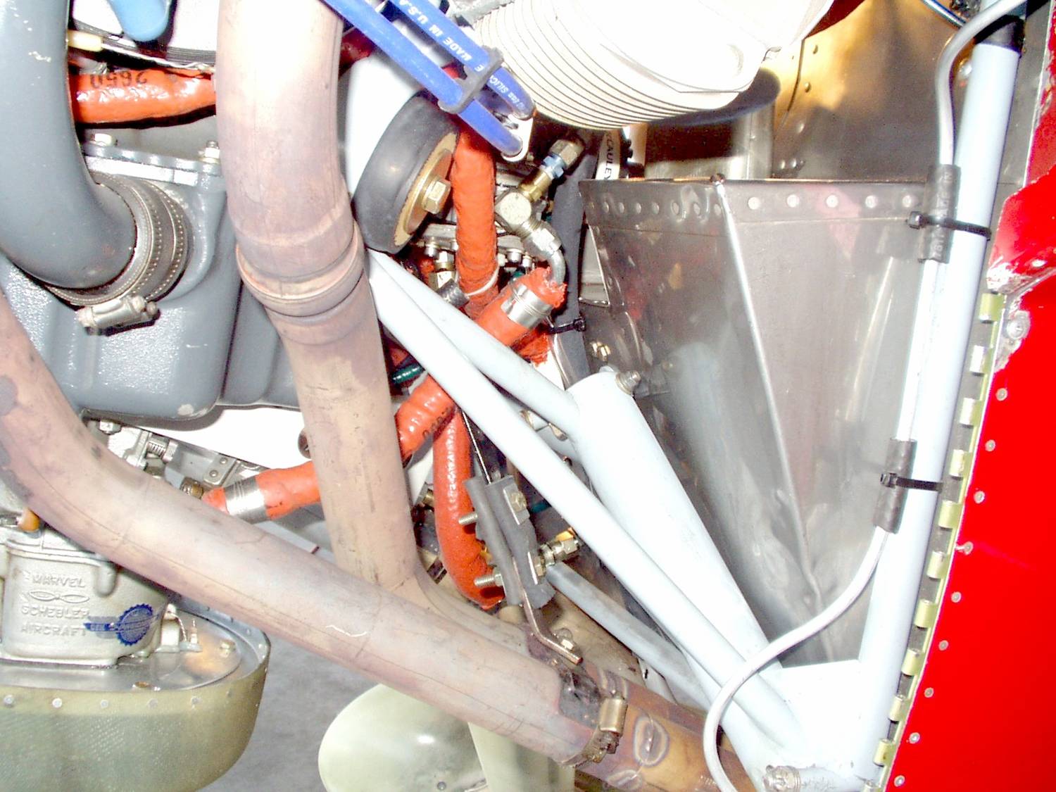

Four pipe Vetterman system RV 4 - 870 hours to date - rubber connectors are rubber heater hose sections - note on both sides of the hangar. Make sure there is NO tension or load on the hangars when you support them.
