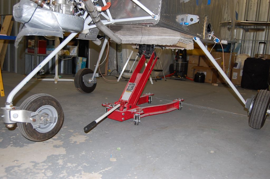

I need some recommendations as to the best way to elevate my completed RV7 fuselage so that I can align the gear leg fairings. The weight should be around 600lb. Is there a better way than jack stands under the center section and weighting the tail?

I used saw horses.

How did you get the fuselage on the saw horses? Did you elevate the tail then physically lift on side at a time and insert the horses?

I rigged a motorcycle jack under the center section. That worked well for me.

Check this posting:
http://www.vansairforce.com/community/showthread.php?t=11956

Transmission jack works really nice for that but you still have to tie the tail down.
