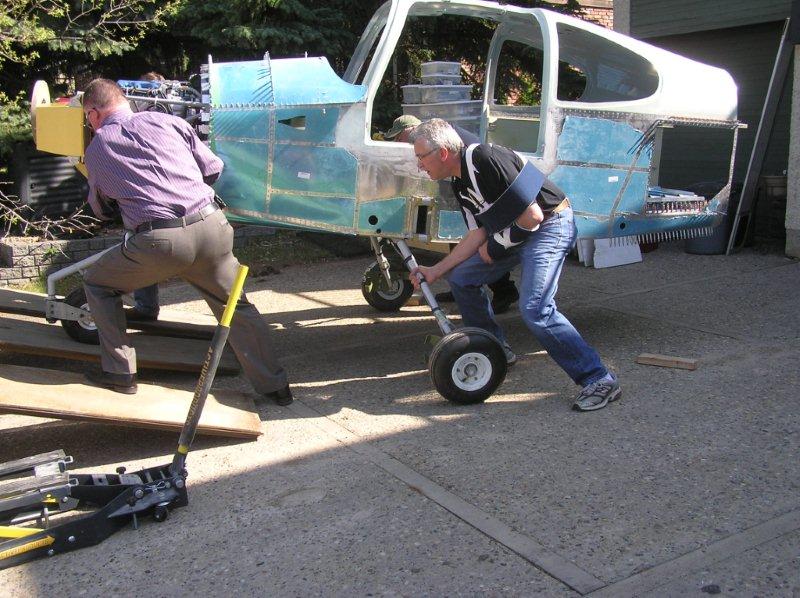

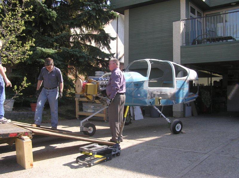

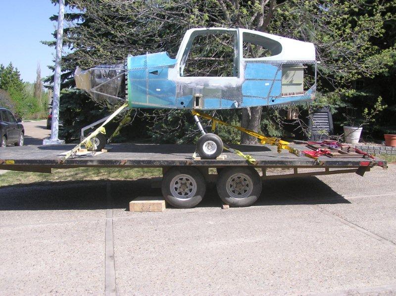

Hi Dave
I went through this process about a month ago. See the pix above.
I found that using 8' ramps, the fuse (along with engine) was surprising easy to roll onto a flat bed trailer that stood about 2' off the ground.
No winch was necessary. It took 4 people, (one with arm arm in a sling!) to roll the fuse up the ramp on onto the trailer in a matter of seconds. I guess it all has to do with moving an object up an inclined plane (I guess I should have paid more attention in Physics class!).
We nailed blocks fore and aft of the wheels and used heavy duty tire down straps with tensioners to secure the fuse. It is hard to see, but the straps on upper end of the gear legs are secured to the opposite side of the trailer. They cross under the fuse and seemed to hold everything very secure.
The fuse did not budge at all during the 60 mile move.
If you haven't already, confirm the width of the trailer you are going to use. I had to search for several days to find a rental trailer that was over 8' wide. Mine was 8' 3". The -10 wheels are surprisingly far apart.

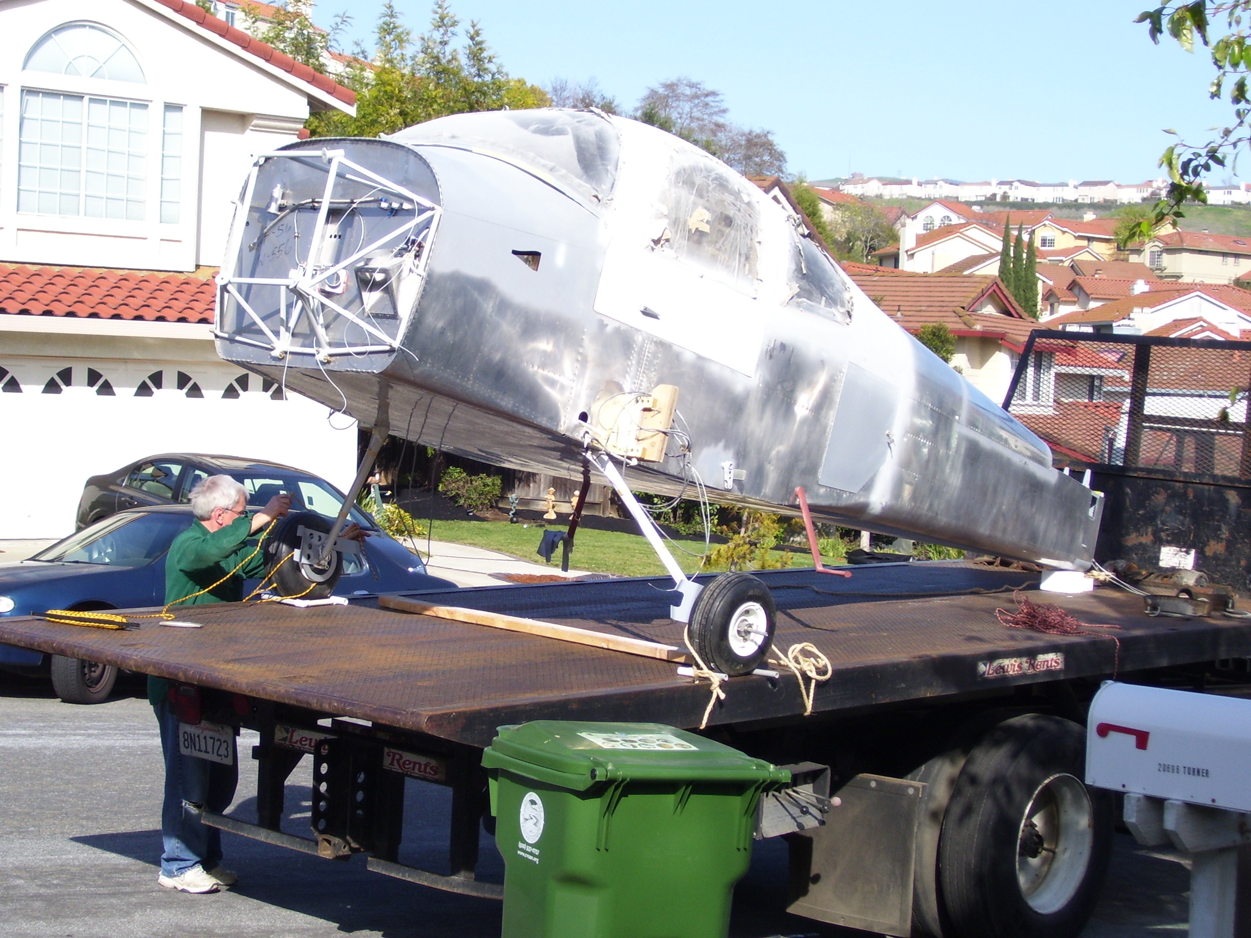

PostPosted: Sun Jun 27, 2010 2:48 pm    Post subject: Re: moving to airport Reply with quote
I moved mine with the tail cone on, but the engine off, so my experience is not so relevant. It was very easy for me to winch up using the tail tie-down. As others said, measure the bed width of the truck. The place where I rented this truck had 2 tilt-beds, but only one was wide enough, and just then barely.
