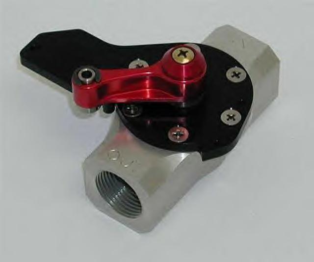

We need to install an oil shut off valve. See the picture below:
This is a cable operated valve that is manually closed after shut down and in the closed position it cut the start circuit by means of a micro switch (not shown) so if it closed the engine cannot start……
I am in the process of looking into having this made here in SA (this one is from the USA and costs $300), so if you are interested, I will put you in contact with the right people since I am sure we could make it cheaper.

PostPosted: Sat Feb 27, 2010 4:32 pm    Post subject: The Hydraulic lock Reply with quote
Guys
I have followed this discussion as it refers to our clean kit
components.
First, to be clear, we developed this items for the model 12. Using
them on yaks and cj aircraft among others is being done as well.
Our "system" includes 3 parts:
Shut off valve
Scavenge pump
Intake drains
Full benefit is realized only if installing and properly using all 3.
Example operational use:
Prior to start, intake drain is open left this way from previous shut
down program. Leave it open. Check mags off pull prop through 3 revs.
Close drain complete typical prefight checks. Prime engine. Open oil
shut off valve via cockpit control cable. Start engine and go fly.
After landing and at shut down area, kill engine as normal. Pull cable
to close shut off valve. Turn on scab pump and run until it skips.
This eturns the sump oil to the tank above the now close oil valve.
Exit aircraft as normal. Open intake drain. Store airplane.
Repeat for every flight.

My answer would be that it is very hard to tell what oil comes from
the top of the engine and what oil has leaked through a poorly
seated ball check valve.
If you have a oil shut off valve, and turn it off immediately after
you land, ... along with a lower sump pump.... I would be curious to
know how much oil came out of ANYTHING... plugs, sump, you name
it... after landing, turning off the valve, using the sump pump,
letting it sit for a MONTH and then coming back to see exactly how
much is in it.
My few experiences with engines set up like this is ... nothing.
Less than maybe a few ounces. NONE in the cylinders. NONE!
However, without having these devices, it is very very possible to
have an engine hyd. lock even in 15 minutes to 30 minutes, with the
right conditions, as was mentioned.
You also must pull it through ... as was mentioned.
But the few engines I have had experience with that had both a sump
pump and a shut-off valve, that were used directly after shutdown,
have never had a drop of oil come out of ANYPLACE a month after just
sitting there.
I guess if you had cracked rings and stacked rings, the oil could
just run down right into the cylinder it might be possible.
Bottom line it becomes a moot debate, or discussion. If you don't
have the sump pump and you don't have the oil shut off valve, ...
the amount of oil that gets into cylinders on exactly what engine
and exactly after so many minutes, is going to vary from one engine
to another and there is no way to predict exactly how much.
mgb
