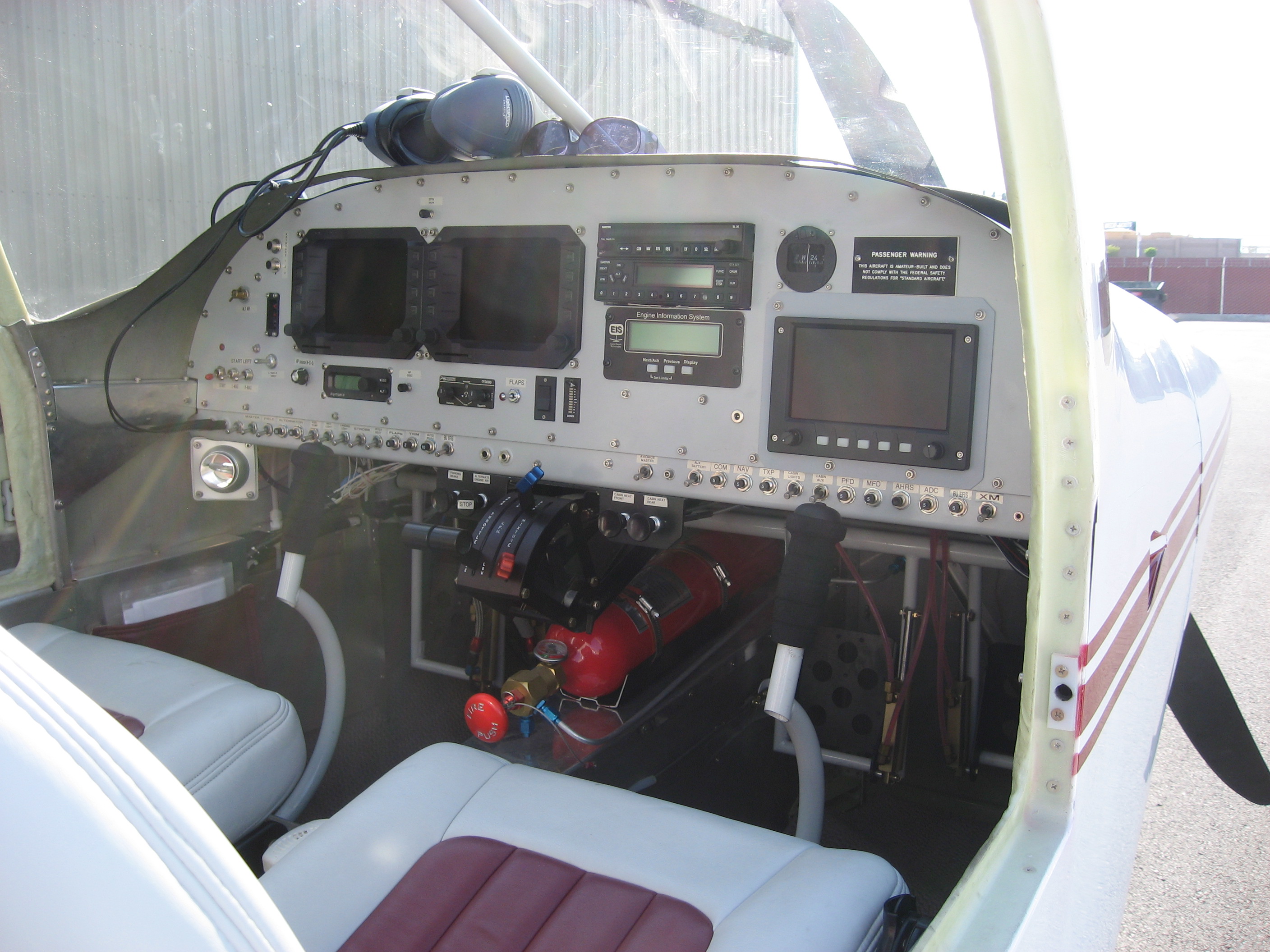

PostPosted: Tue Aug 10, 2010 7:22 am    Post subject: If Doing It Again, What Would You Do Differently? Reply with quote
Although the SS airbox will buy some additional time (probably not enough to
land and exit), a better solution to the fire problem might be fire bottle.
 Filesize:  1.19 MB
 Viewed:  12986 Time(s)
