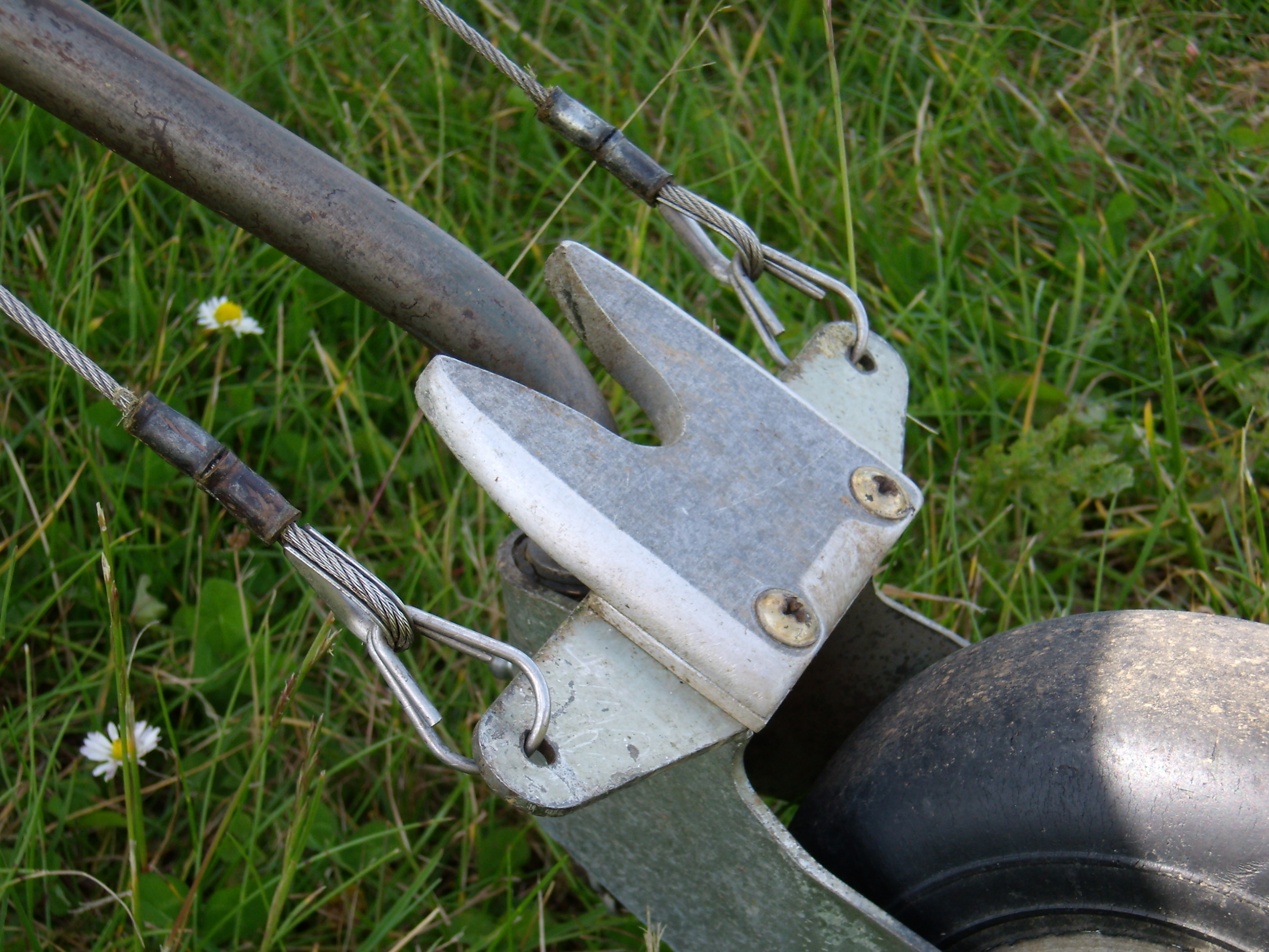

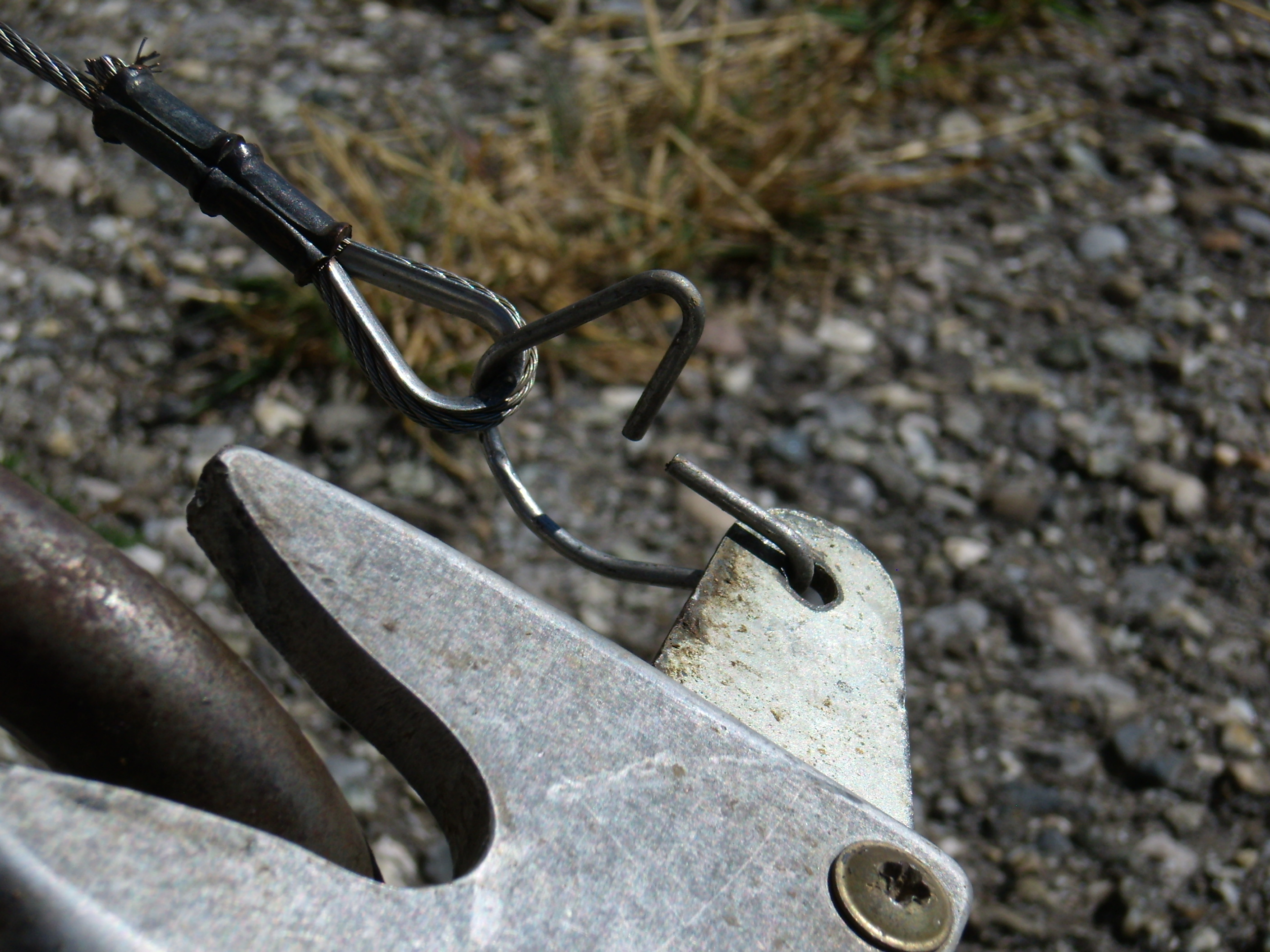

Hi all monowheel drivers,
After landing on a mountain strip today I noticed I had some trouble
controlling the aircraft on roll out and tight turning on the
parking. The next landing on another altiport was uneventful but
again I had trouble tight turning to the parking spot.
During the preflight check for the return flight, this is what I
found: the starboard ring attaching the cable of the tailwheel fork
was open and was barely insuring a very loose connection. See attached
picture.
I am afraid that if that ring had become fully disconnected, I would
have crashed into the wall of rocks on the left side of that runway!
Lesson learned: check that tailwheel control cables carefully before
EVERY takeoff.
Of course I am thinking at some solution to insure a safer connection
of those cables.
Remi Guerner

Hi Remi,
Another way to attach the cable is with a shackle (AN115) and clevis pin.
This is working well for me so far.
Glad to see it did not let loose completely!
Kevin

Hi Remi
Glad to hear that connector didn't let go all together.
Some ideas:
http://www.europaowners.org/forums/gallery2.php?g2_itemId=27732
**I am using stainless connectors that could pretty much be used as a direct replacement of the spring clips. I have a pic of McMasters page in cat. with part number. Item is made in France, very nice quality.
**If you need to make another cable, take a look at my 3 Nico, 2 cable alternative to 1 cable. If you go this route first nico the third nico, then hang a 5 gallon can or kerosene or similar weight to load cable when doing nico 2 and 3.
**I made some cone washers to help stop point loading, they work great
**I ripped off Grahams aluminium tailwheel stop
**I incorporated turnbuckles on tailwheel drive, one side with an eye and the other with a clevis
**** This is a little off topic, but not much!
I mentioned this before, if you have turnbuckles to adjust rudder cables and have not addressed their affinity to tangle if you release pressure from return springs, I believe this is an accident waiting to happen.
Resolution is simple, I used two pieces of heat shrink.
If anyone has turnbuckles for rudder cables I urge you to release tension by lifting rudder pedal just a little while observing turnbuckles. When they tangle it limits the side that tangles rudder travel because the other rudder pedal acts as a stop when going aft.
I would not want this to happen on a trigear, but on a tailwheel plane all I can say is "yikes".

Remi,
Loose the clips! Replace them with AN115 Cable Shackles, Clevis Pins and a Cotter Pins (split pin).
http://www.aircraftspruce.com/catalog/appages/an115.php
http://www.aircraftspruce.com/catalog/hapages/clevispins.php
http://www.aircraftspruce.com/catalog/hapages/cotterpins.php
Check six,
Bob Borger

Hello Remi,
Yes, I had the same problem 9 months ago after about 80 hours. I also
noticed poor steering and found the same problem. I emailed John Wheeler
and he told me that they have now changed to a mini U bolt (like the
u-bolt and screw pin used to secure the safety chain on a trailer) to
connect the cables to the tailwheel assembly as they have seen that
problem before. Maybe those wire connectors should all be changed.
Keith.

I used these screw shackles as a replacement. More than enough strength and
not too expensive.
See http://www.s3i.co.uk/rapide_link_standard.php

Bob's right. This has been a common problem over the years. Use the AN115 shackles.

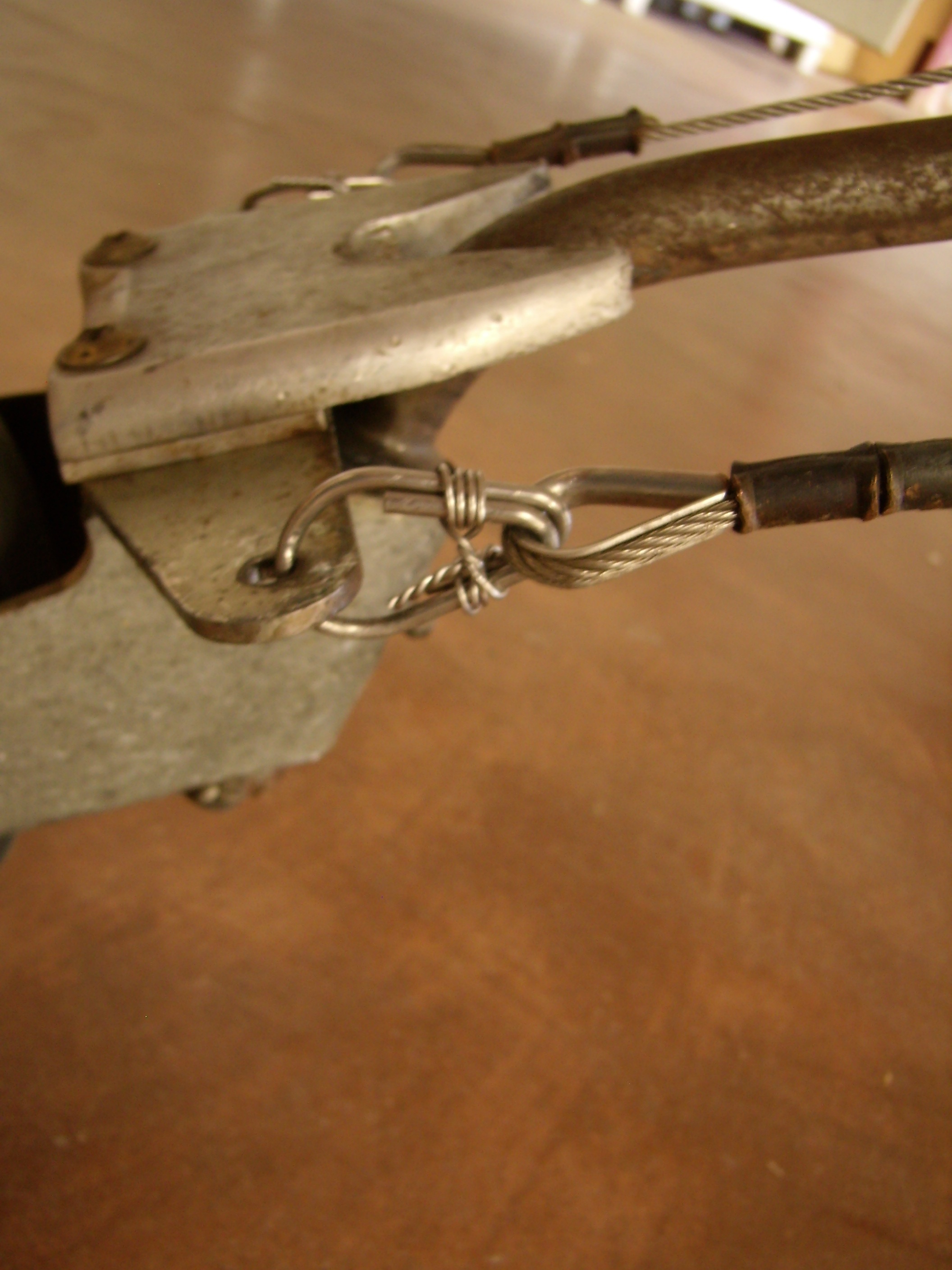

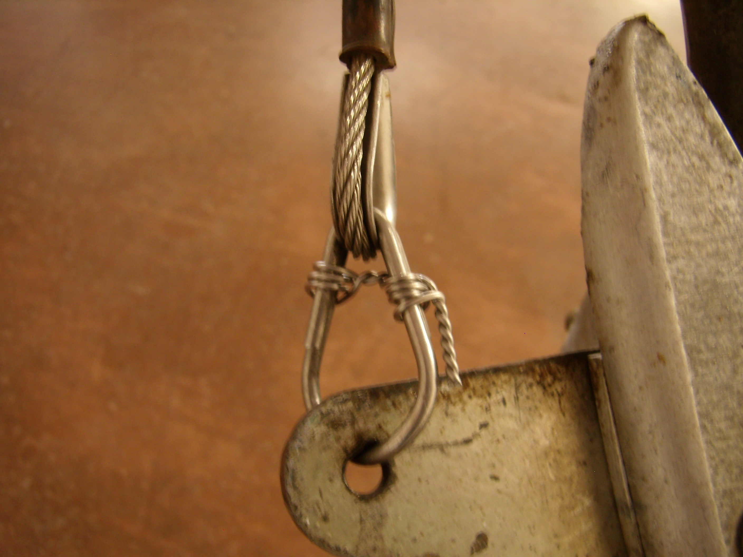

Thanks to those who have made suggestions for the replacement of the
clips. I like the Shackles + Clevis Pins solution.
Attached are two pictures of my temporary fix.
Remi
