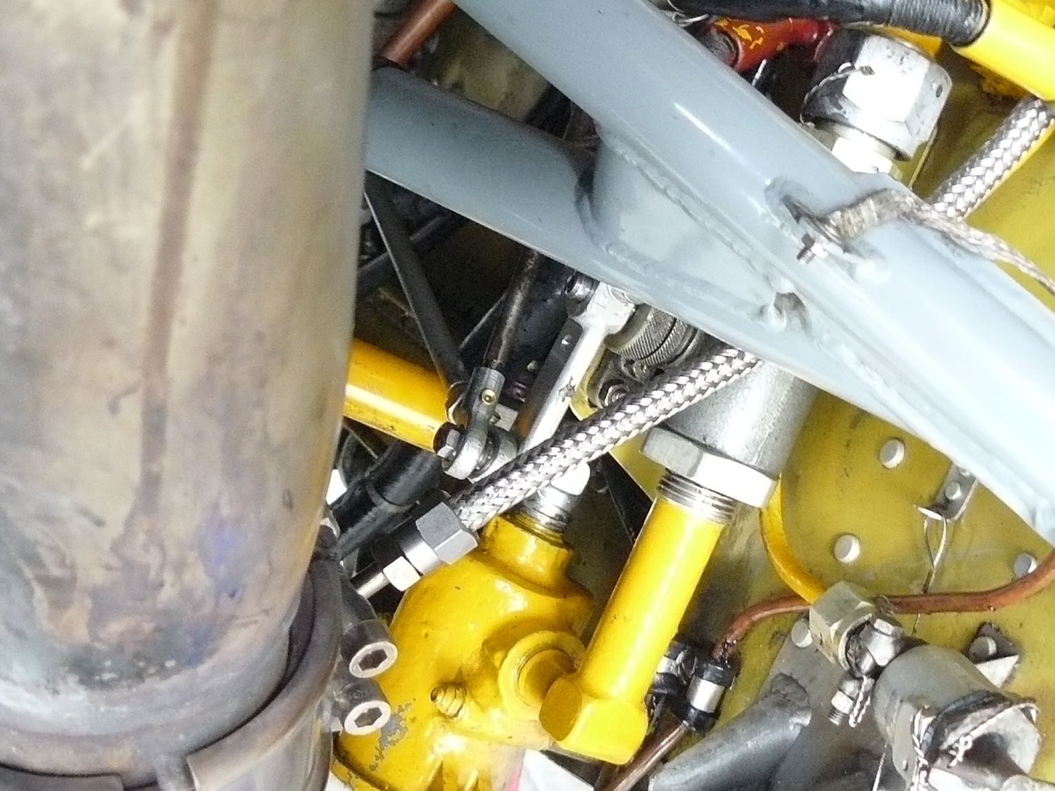

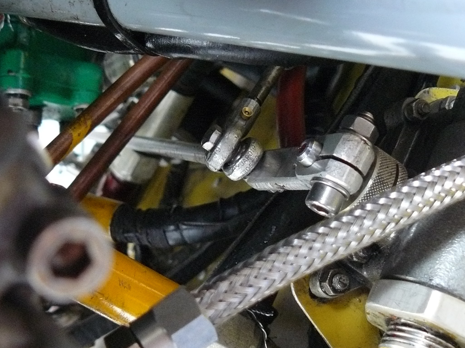

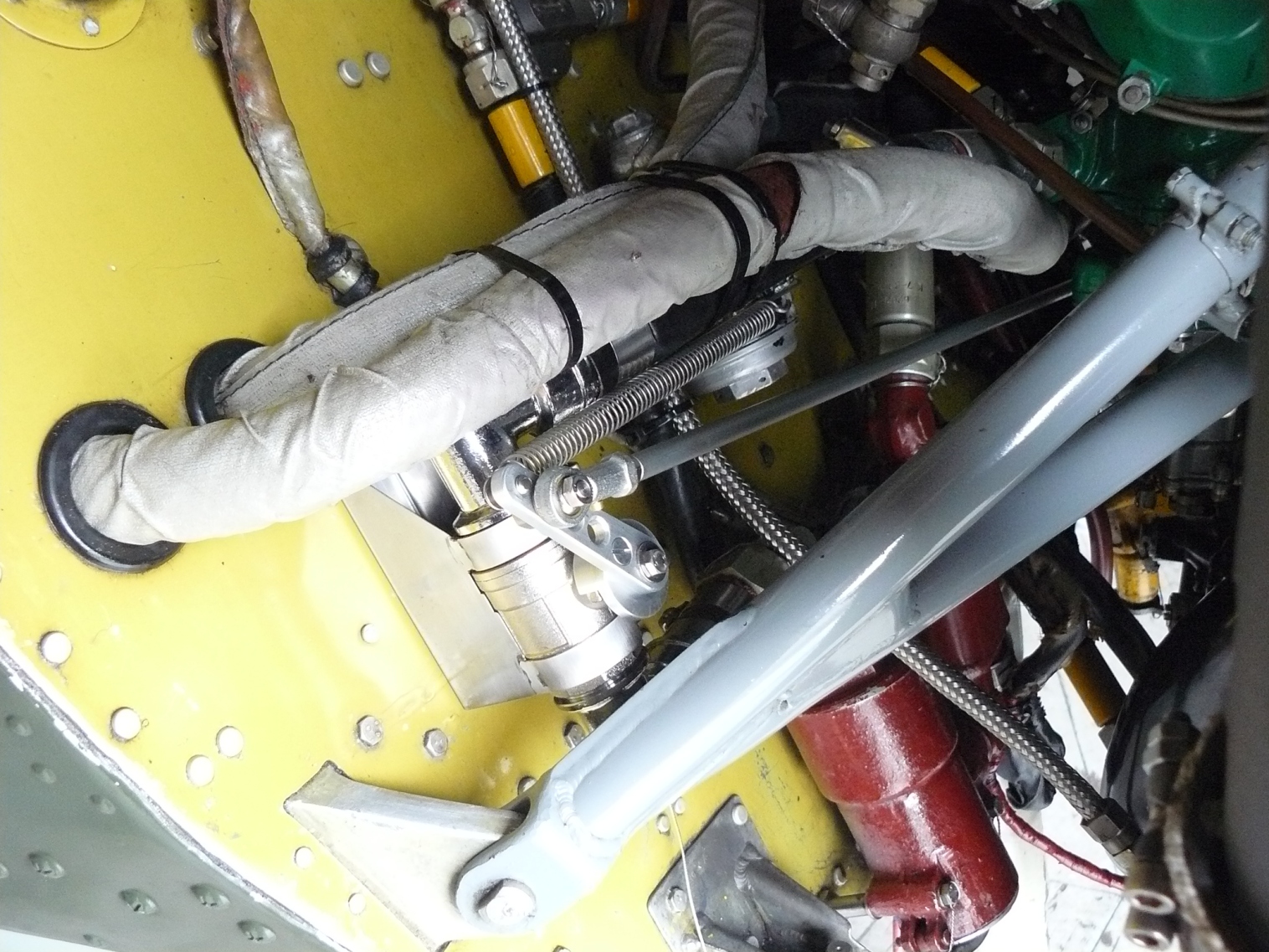

Hello,
to stop oil draining into the crankcase I came to a solution which works great on the Yak 18T so far. As you can see on the photos, I added a ball valve into the feed hose to the oil pump on the right side of the fire wall where the hose forms a U-shape. The lever on the ball valve is connected to the lever of the petrol tap on the left side via push-pull rod, so when you close the petrol after engine shut-down, you shut the oil at the same time. No more need to drain the crank case before start. You just cannot forget to turn on the oil as you cannot miss that petrol has to be opened in the cockpit, as both valves are connected by pushrod. I added a safety spring to the ball valve, pulling in the "open"position, in case, something should break.
There may be the need for some minor re-routing of oil hoses for a straight pushrod between both valves but it can be done. I don“t know if this goes for 52s as well. Maybe there is need for an intermediate lever and two pushrods to clear obstacles, but the system seems reasonably failsafe to me.
Vic

Vic,
Who makes that valve you used?
Keith

Hello ,
thank you all for your feedback about some side effects of my setup. Quite frankly, I only had in mind to prevent starting the engine with oil valve closed. And no, I did not think about an emergency shutdown in case a mag or two remained hot because of a broken earth connection. I will keep the oil valve anyway but am thinking of a way to close the fuel tap individually, but both valves to open with a mechanical linkage. I do not like an electric workaround of this problem, as some say, wires and switches do break. Anyway I keep you posted.
Vic
