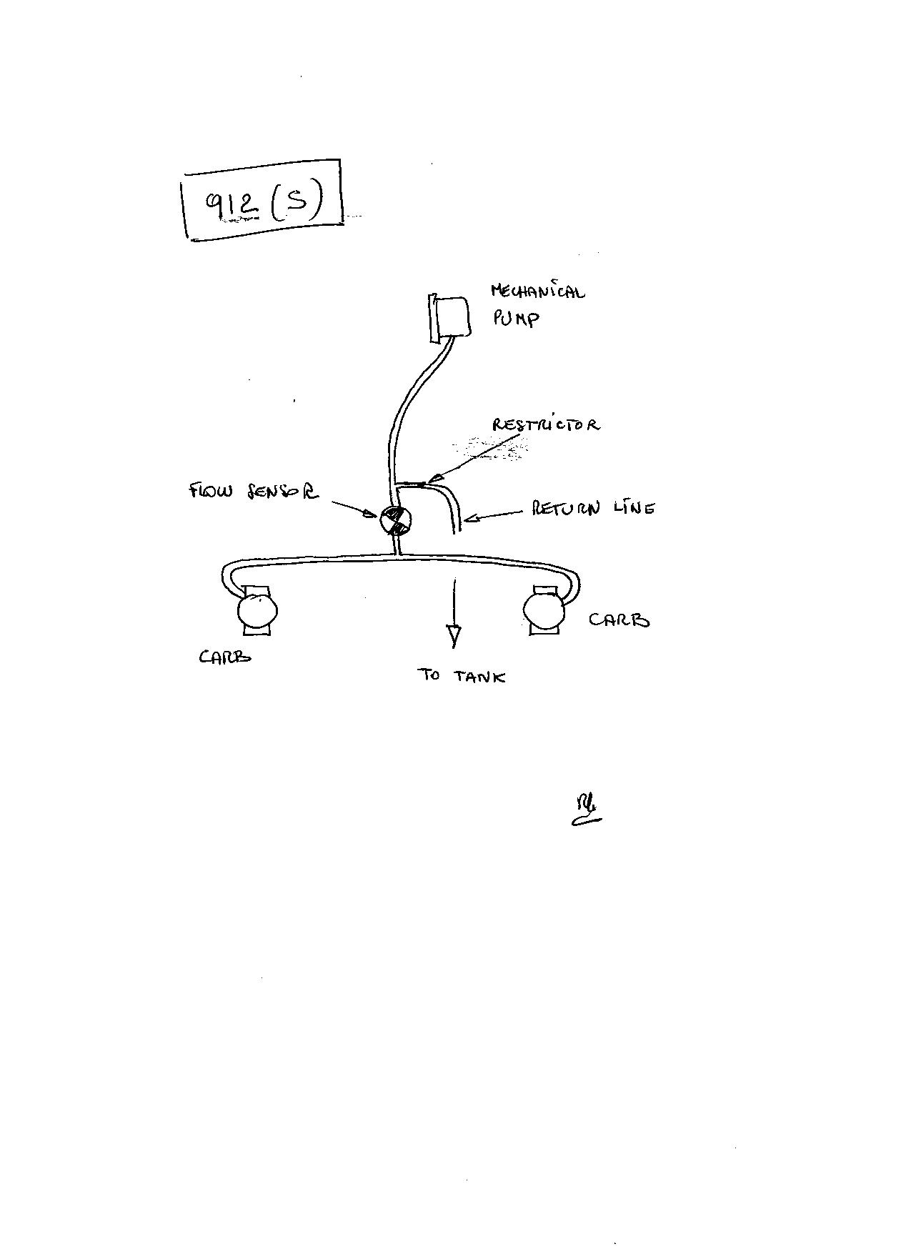

air.guerner(at)orange.fr
PostPosted: Fri Oct 22, 2010 9:56 am    Post subject: Rotax fuel flow detection Reply with quote
Thank you Ian for posting the LAA mod.
I have not installed a fuel flow in my aircraft but if I had to, I
would use the attached schematic which allows measuring the flow to
the carbs with a single sensor, therefore improving accuracy and
reliability and reducing cost.
The same principle can be used for the 914. In that case the single
flow sensor would be installed between the pressure regulator and the
carbs.
Remi Guerner
F-PGKL
 Filesize:  72.09 KB
 Viewed:  8645 Time(s)
kheindl(at)msn.com
PostPosted: Fri Oct 22, 2010 12:09 pm    Post subject: Rotax fuel flow detection Reply with quote
Remi,
I tried just that. It does not work. The fuel flow at that point is not smooth and you get very erratic readings. Only John Wigney managed to get it to work with a pulsation damper.
I tried that too, but with little improvement. So I will also have to buy another Floscan transducer. The price at ACS is as good or as bad as any.
Karl
PostPosted: Sat Oct 23, 2010 12:48 am    Post subject: Rotax fuel flow detection Reply with quote
Svein,
I basically agree with what you wrote. However my proposed schematic
is very close to the one recommanded (and optionally supplied) by
Rotax in the 912 Install Manual (see attached). This arrangement works
on most LSAs so I do not see why it would not work with the addition
of the fuel flow sensor as propsed.
Remi Guerner
<<<<<<At first sight, your proposal may look like the obvious
solution. With
respect, however, I think it is not to be recommended for 912ULS
installations (I do not know enough about 914 to comment on that
engine).
Contrary to what seems to be a common assumption, the return flow
through
the restrictor is not insignificant - it is roughly 10 litres per hour
(i.e.
roughly half of the net cruise consumption, or roughly 1/3 of the fuel
going
to the engine is flowing back to the tank). The reason for this
relatively
high surplus circulation is of course to reduce the time the fuel is
exposed
to heat before it reaches the carbs, by increasing the flow velocity
through
the fuel line. According to the build manual, the return line
branches off
at the point farthest from the pump, just before the left side carb
(assuming the fuel line goes from the pump to the right side of the
engine
with a short branch off to the right carb, and from there across the
back of
the engine to the left carb).
Moving the return line branch-off upstream (closer to the pump)
increases
the risk of vapour forming in the fuel lines downstream from this
branch-off
point. By how much, I do not know, but maybe it is critical under
unfavourable circumstances. "Maybe's" under the cowling are not nice
912_fuel_system_-_Rotax_IM.pdf
Download
 Filename:  912_fuel_system_-_Rotax_IM.pdf
 Filesize:  78.31 KB
 Downloaded:  412 Time(s)

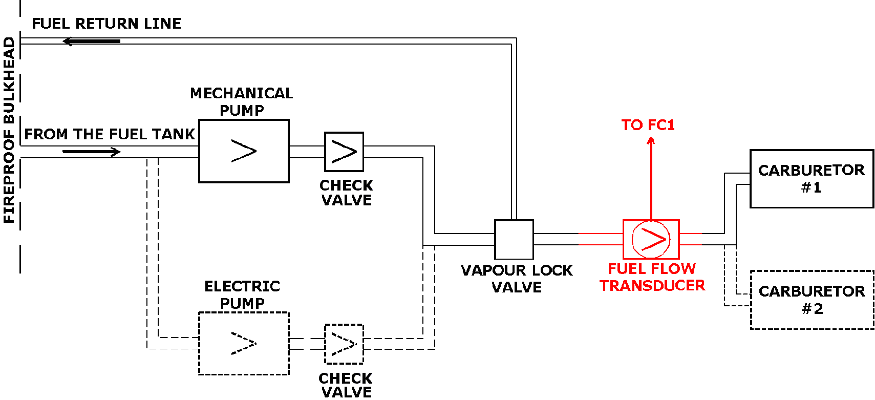

PostPosted: Wed Oct 27, 2010 12:21 pm    Post subject: Rotax fuel flow detection Reply with quote
I will too install a fuel computer this winter to my 912s.
In the manual of my FC1 Flybox is a schematic I will post here
and I canīt see why it shoud not work.
Even measuring the fow of only one carb it should be no problem to find the right k-faktor setting.
[img]cid:part1.07050804.01050908(at)onlinehome.de[/img]

the risk of vapour forming in the fuel lines downstream from this branch-off
unfavourable circumstances. "Maybe's" under the cowling are not nice - - -
