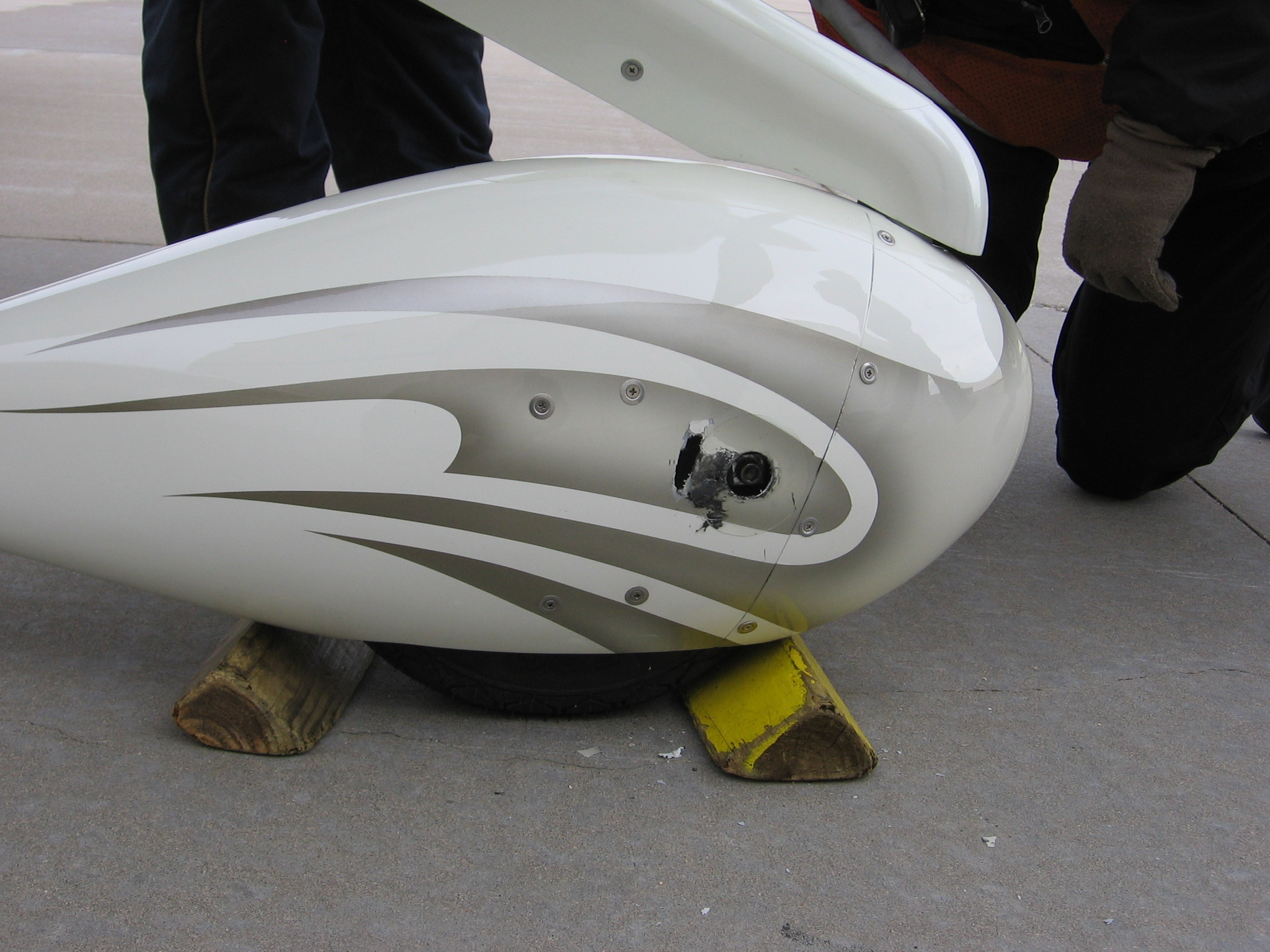

Some of you may remember that I suffered serious nose wheel pant damage on my very first trip out of phase 1 and the paint shop. Lineman used a tow bar head that had pins that did not fit over the bolts. He then proceeded to push the airplane and ripped back from the holes in the wheel pants. The line manager had been told that I wanted to be there when they moved the airplane. Lineboy took it on himself to reposition the airplane. Worst thing was that he did not tell anyone what he had done. I came back out to the ramp to find my airplane moved and when I walked up to it, the damage was apparent.
The FBO paid to have the pant repaired and repainted.
Long story, but my point is that I take all of the precautions that you all are advocating, and it still happened. Here is a photo of the damage done by my incident. Very first trip outside of the Phase 1 area! Mad
