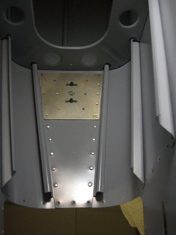

PostPosted: Wed Nov 24, 2010 8:02 am    Post subject: VOR/GS/LOC antenna mount Reply with quote
It's way easier than you'd think....just look down into
the tail from above by the HS, find a good spot
in the middle, and make a doubler that fits. There
aren't that many locations down there where you can put it,
with seams and all, so the right spot will be obvious.
It'll be completely underneath the HS then, and
pretty well protected.

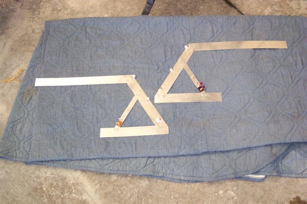

PostPosted: Wed Nov 24, 2010 6:36 pm    Post subject: VOR/GS/LOC antenna mount Reply with quote
I agree with the earlier posts - the very marginal gain of having any external VOR/GS antenna over a wingtip one is not worth the risk of anyone poking out an eye.
I have a homebrew wintip antenna in my 8A that receives stations quite well.  A few pieces of aluminum out of the scrap bin and you're done.  I'll make an identical one for the 10.
Carl

Eric, re-read your email after I sent my first message. I used K-1000-3 nut plates for a #10-32 screw or AN 3 bolt.
Rick

Eric
I just made a doubler for a Comant CI 157P and installed it last weekend. I used 2024T3 .063", and then rivetted it in the rear tail cone as others have done. Tim Olson has a couple of pictures of the exterior placement on his web site, in misc photos, "The Colorado 10's". I alodined the area under the doubler as I hadn't primed that area.  Also alodined both sides of the doubler and the circular area on the ouside of the tail skin.
I'm not going to worry about kids or anyone bumping the antenna. If anyone hits it, it will likely be me. I wanted the best possible reception I can get as we have far fewer VOR's here north of the 49th parallel.
Rick

PostPosted: Wed Nov 24, 2010 7:35 pm    Post subject: VOR/GS/LOC antenna mount Reply with quote
Agreed. Photo attached.
Robin
