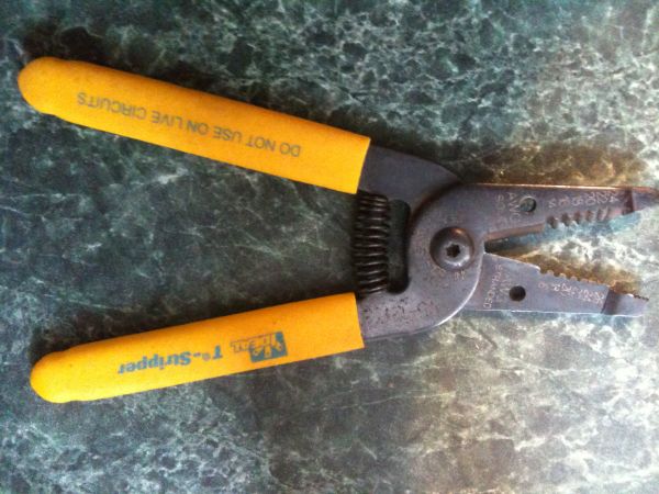

As I embark on a new adventure - wiring, I have a couple of questions for those who know their electrons.
My wire strippers don't seen to work very well on the fine Tefzel wires of the RayAllen servos. Can anyone give me the name / model of a good brand of wire strippers that will handle these wires? I suspect this will be an ongoing issue.

I use a single edge razor blade. Just press the razor blade through the insulation, rotate the wire and repeat. With practice you can 'roll' the wire allowing the razor blade to follow the wire without 'sawing'. Depending on your make/model of stripper, you can buy blades that fit your wire size better.

I am using Ideal Stripmaster Cat# 45-177 16-26 Ga. Not cheap but they work really well. For larger wires I use a cheap pair from Lowe's. I use single edge razor on rg-400 or #2 ga.

I have had a few good strippers over the years.
(geez, maybe I shouldn't say that in public? Smile )
Right now, my main sets are 2 of these IDEAL T-Strippers.
(also see attached)
http://www.google.com/products/catalog?num=10&hl=en&newwindow=1&q=ideal+T+stripper&um=1&ie=UTF-8&cid=395400644739097984&ei=I0YeTeuAE5O6ngeMwbz8DQ&sa=X&oi=product_catalog_result&ct=result&resnum=3&ved=0CDQQ8wIwAg#
It's nice because it covers most every gauge that you'll use
in the build, from I think 8 to 26 stranded. It's also very
cheap, and available locally.
It's not the only brand that's good, I'm sure there are dozens.
But, when you find one you like, buy 2....keep one for the
long term. The most important thing is to have one that's
well made and sharp.
Tefzel strips wonderfully. To strip the shielded stuff I
just spin the wire in the blades and bend it to crack the
groove and then pull off the sheath. The wires strip
normally, with no issue. Done a bunch of wires lately.

On 12/31/2010 12:45 PM, Les Kearney wrote:
