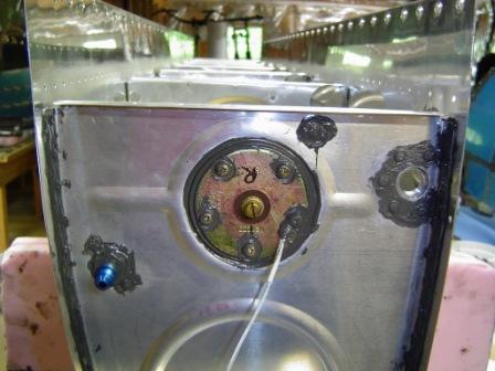

6. On the fuel sender, put proseal on each side of the sending unit gasket
and under the sender mount screw heads. Don't forget to put in a ground
wire under one of the screw heads so that the sender has a ground. Ground
at the firewall. Photo attached.
