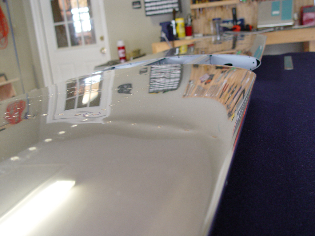

marchudson(at)comcast.net Guest
Posted: Thu May 04, 2006 3:07 pm Post subject: Dents in HS Skin |
Guess I didn't make myself clear enough in the first post. It
wasn't caused by not trimming the nose of the rib but rather
it is pulling the skin down on the top of the HS almost like the
rib was not tall enough.
I've attached a picture for all to see.
Thanks for the help.
Marc

jesse(at)itecusa.org Guest
Posted: Thu May 04, 2006 4:48 pm Post subject: Dents in HS Skin |
That's very normal, I think. There isn't a crease, is there? I think it
might be possible to get the bend on the non-ribbed portion of the skin a
little tighter, but I wouldn't mess with it.

Posted: Fri May 05, 2006 5:35 am Post subject: Dents in HS Skin |
Marc,
This is typical of all the RV-10's I have seen, except I have only seen 4. I quit worrying about it after I looked at both of Van's RV-10's. Mine and Bob Kayfmann's here in Las Vegas are just like that. Only thing you want to make sure of is that the flanges on the rib fully contact the skin and that you made sure the flanges were 90 degrees from the web of the rib itself. The other posts addressed the problem of the leading edge of the rib causing the skin to crease at the rib, you don't seem to have that problem. Bright shiney aluminum tends to acentuate any minor deviations from absolute flat. I borrowed a pic from Mike Howe's site where his stab is hanging on the wall and you can easily see the same thing. Drive on!! you got lots more to do!
Rick S.
40185

indigoonlatigo(at)msn.com Guest
Posted: Fri May 05, 2006 10:17 pm Post subject: Dents in HS Skin |
If you go back and read my original post along with some of the things
others have said it should make sense why this happens. Rick's post from
today is the bottom line.
You might see this again when you make the elevator trim tabs.
Think about this, in the case of the Horizontal stab it is the leading edge
bend and the nose rib shape.
With the elevator trim parts you bend the aluminum in a bender and if you do
not make the trailing edge bend tight enough, when you go to glue the foam
ribs in place you will be squeezing the metal skin in to the ribs more than
the non rib supported skin wants to be so in the end you might see a
depression where the ribs are sucking in the skin.
My epoxy worked better by allowing the H.S. skin L.E. bend dictatethe shape
of the airfoil in conjunction with the ribs and spars. Any gap between the
inside skin and the rib flange was filled with epoxy, that is why I
rechecked the rivet lengths. This even with the rib flanges 90 degrees to
the web.
Bottom line, it is good you are seeing the issue and thinking about why it
happens.
John G.
Marc
