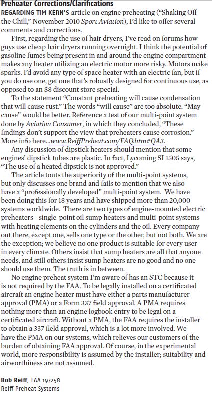

A couple days ago I ran across a "letter to the editor" in Sport
Aviation (Dec. 2010, from the guy at Reiff Preheat systems.
I attached it in .jpg form for you. He makes a couple good
points about engine heating and about leaving them on all the
time. I know from people I've talked to over the years, I've
heard it various ways that you either can or can't leave
them on all the time. The letter referenced this FAQ of
Reiff's:
http://www.reiffpreheat.com/FAQ.htm#QA3
I've always just left mine plugged in, that FAQ also references
an Aviation consumer article that I have, where they tested
heaters and the dewpoint and temperature of the engines and
basically found that if you have a good heater that heats
nice and warm on the whole upper (cylinders) and lower (sump),
that you're not very likely to have the conditions that will
cause high moisture and rust in your engine if you leave it
on all the time.
The Aviation Consumer article is worth reading if you have
a subscription. If not, and you want it, let me know and
I can fax it or something.
If you have a sump heater only, you won't do as good a job
heating your engine as a whole, and you may indeed have
oil warmed that brings moisture up to condense up higher
where it's cold. So it would be much more of a problem
with the cheap partial heaters. I guess what I get out
of it is, if you really need heat, either buy a whole
system (I have the reiff with cylinder bands, which was
simple to install) and feel free to operate it is you wish,
or get a system that you only use when you plan to fly.
One of my issues is, I never know when I want to fly, at this
time of year. The days sneak up on you. If I continuous
heat, it'll be ready anytime. If not, it won't necessarily
heat fast enough (unless maybe you buy the fast system),
to be worth turning on. Add to that the complexity of
getting a remotely operated switch to turn on the heater.
In my case, I leave it on all the time and it's something
like 250 watts....so a big light bulb. The bill isn't
bad for that to run all winter. In fact, a remote switch
would cost me well over $100-150 (plus internet access with
a static IP) for a good one, and I don't spend that much
to heat the plane for a few years. Also, it takes me
15-30 minutes to get to the hangar if I wanted to go there
and turn it on, and then go wait while it heats...a waste
of time. So leaving it on works perfectly for me.
One last point is, if you put it on a timer, or cycle
it on when you think you may fly, just in case, but then
don't fly, you're probably more likely to cause moisture
buildup from the heat cycling, than if you just brought
it up to temp and left it warm. So if you heat it,
fly it, I guess is the idea, if you're not continuous.
Get the oil temp to 180F so you evaporate the moisture
before you put it away.
Anyway, all good things to think about in relation to
heaters. I've had great luck continuous heating with
both a Tanis and Reiff system. The only negative about
the Tanis for me today would be it uses the CHT bayonet
port, which I use for my probes. If you use the Tanis,
you'll probably need ring type CHT probes which aren't
quite as accurate.
