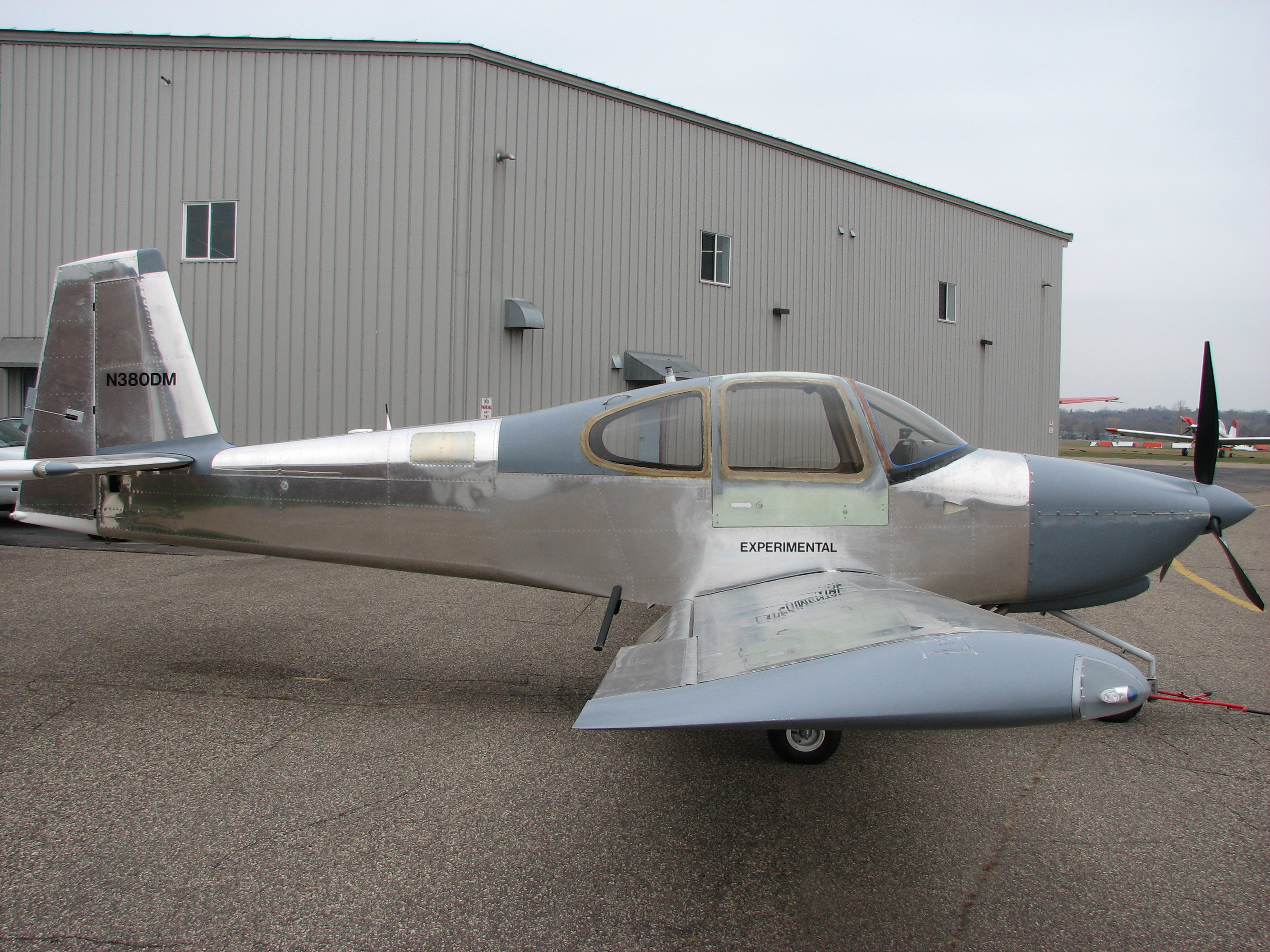

I decided to start this instead of continuing to hijack the Step thread. I cannot find any close up photo's of my handles. Here is one from a distance that shows the location very clearly. These are just cabinet or door pulls from the Home Depot aviation department. Drilled through the cabin top and installed with stainless screws. The screw heads are now covered by my headliner.

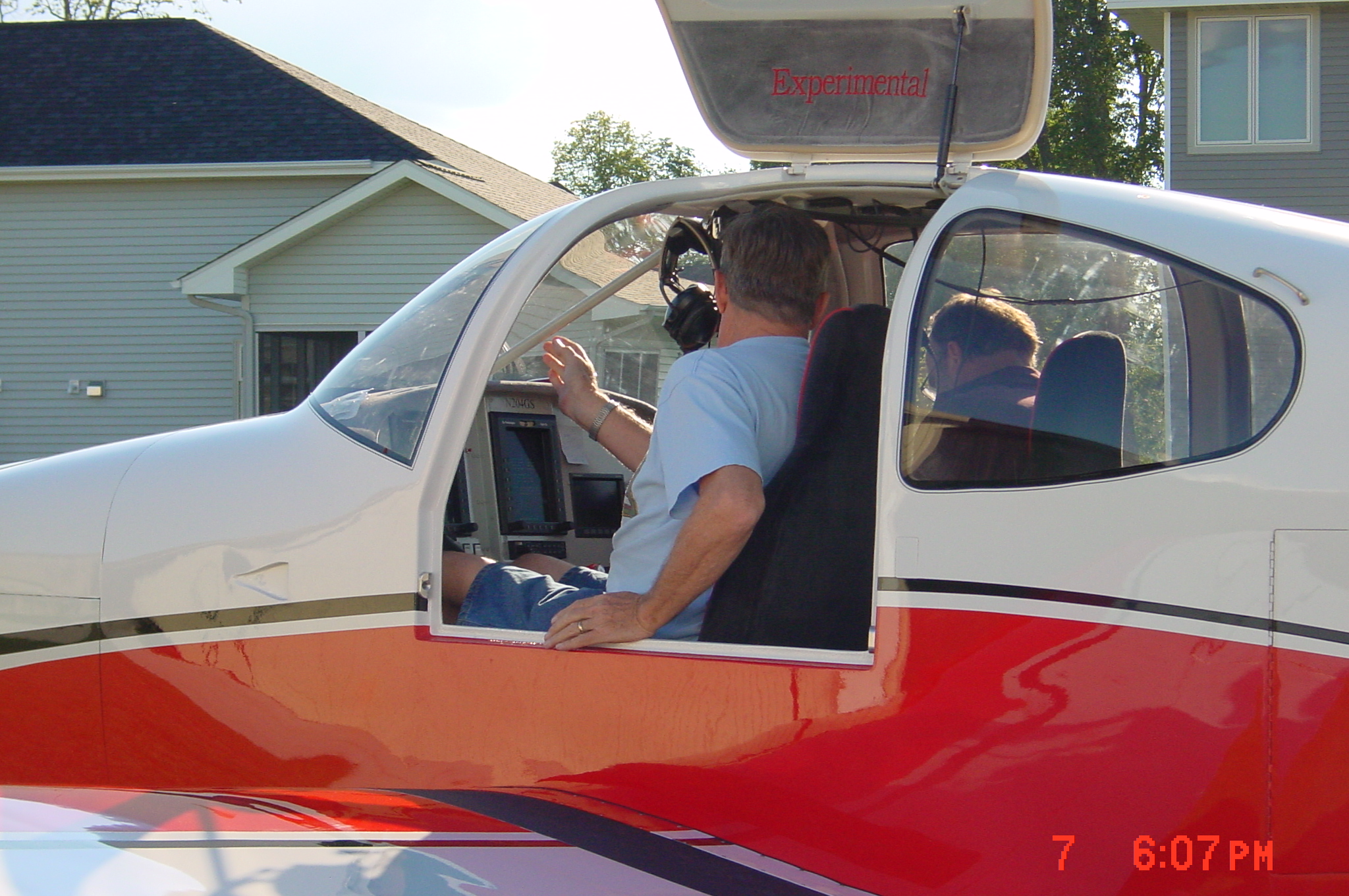

Here is another example.

OK I've got ask--what's the panel in the your tailcone just aft of the cabin cover?

Air conditioning access panels.
