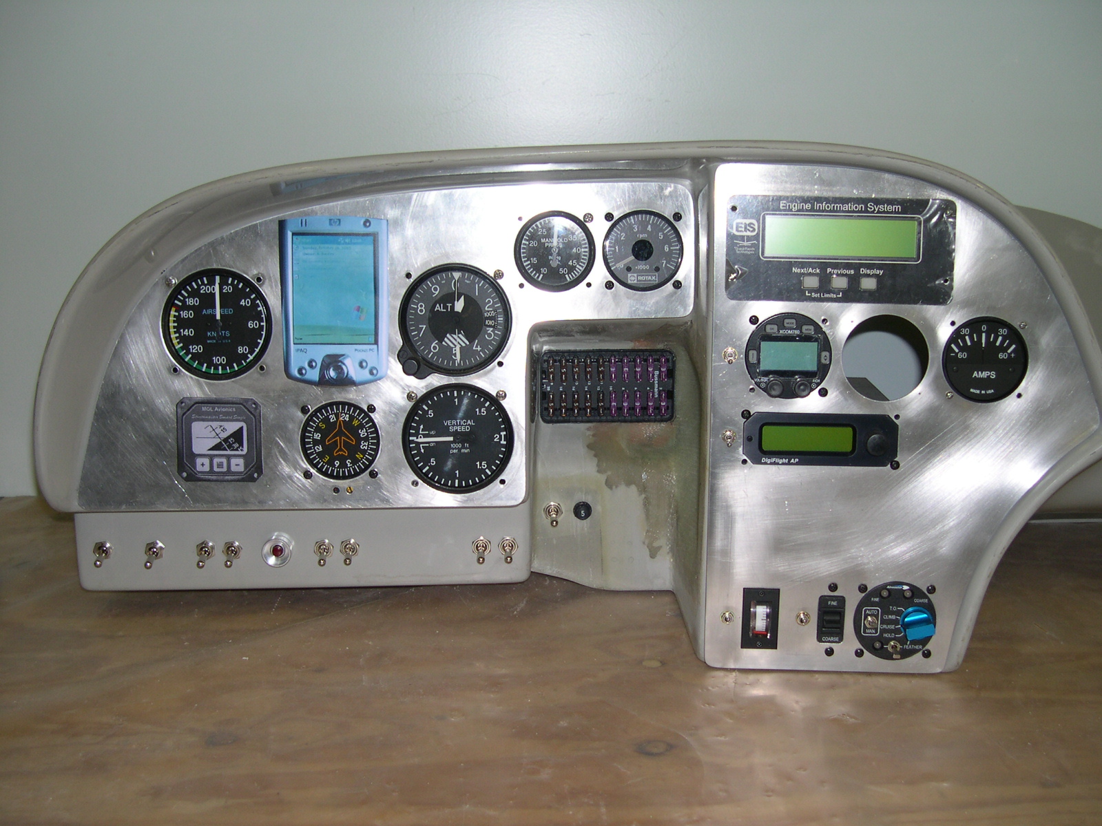

kingsnjan(at)westnet.com.
PostPosted: Fri May 13, 2011 5:22 pm    Post subject: Bus bar Reply with quote
Will,
As with so many things in life nowadays, there are many alternatives.
I chose the Bussmann fuse block as depicted in the following link. This
unit
has its own bus bar (dual bus if required) that feeds up to 32 fuses. Mine
is the 20 fuse model. Only one wire needs to come through the firewall or
two if separate feeds are required for the dual bus.
http://www.aeroelectric.com/Mfgr_Data/Fuses_and_Current_Limiters/Bussman/15710_Fuse_Panel.pdf
I fitted mine as per the attached.
Cheers
Kingsley
 Filesize:  741.19 KB
