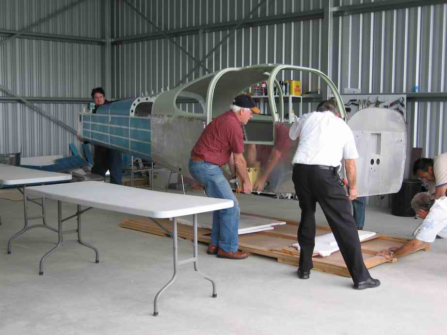

PostPosted: Sun May 14, 2006 5:47 am    Post subject: lifting Reply with quote
I used a carton of beer ... to entice a few friends to help lift the fuse onto tables!
Indran Chelvanayagam

 Filesize:  53.75 KB
 Viewed:  264 Time(s)

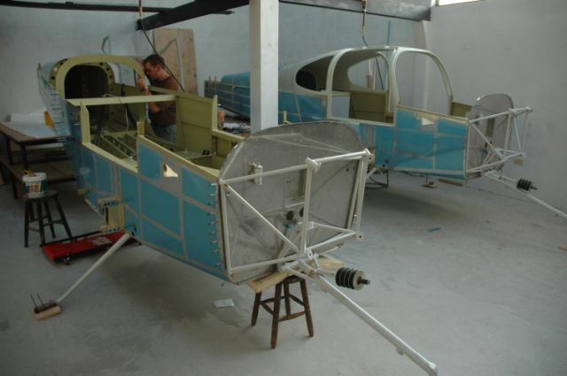

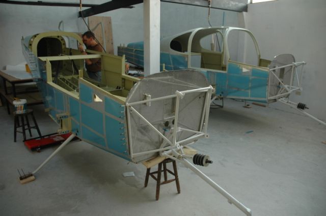

PostPosted: Sun May 14, 2006 10:14 am    Post subject: lifting Reply with quote
Oh, by the way, we put the gear on before joining the tailcone.  With the main gear on (just gearlegs, not wheels) and the engine mount on the floor, it makes it VERY NICE to work on the brake and fuel systems as well as the rudder pedals.  It also makes it nice in joining the tailcone.

 Filesize:  33.26 KB
 Viewed:  241 Time(s)
