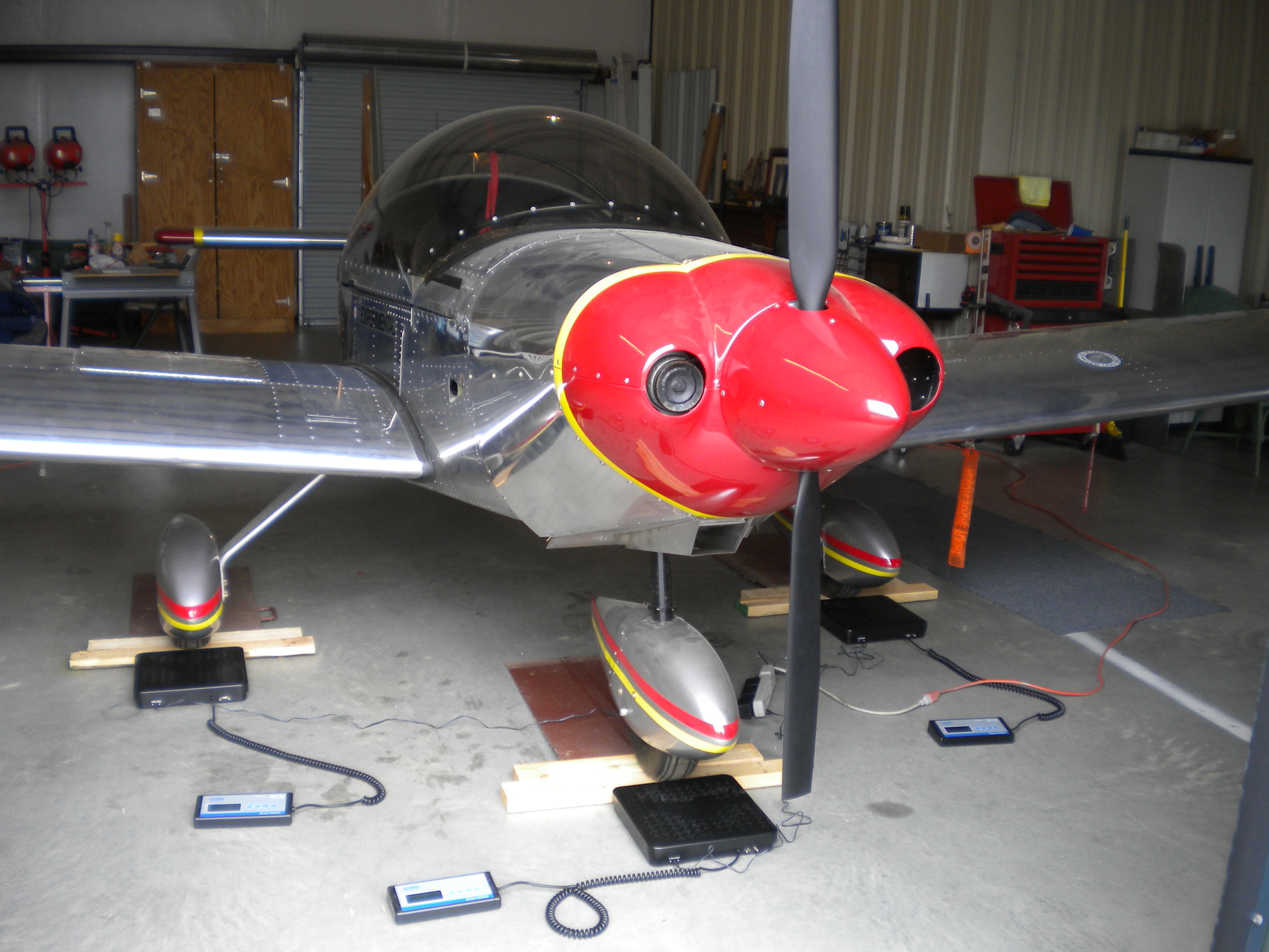

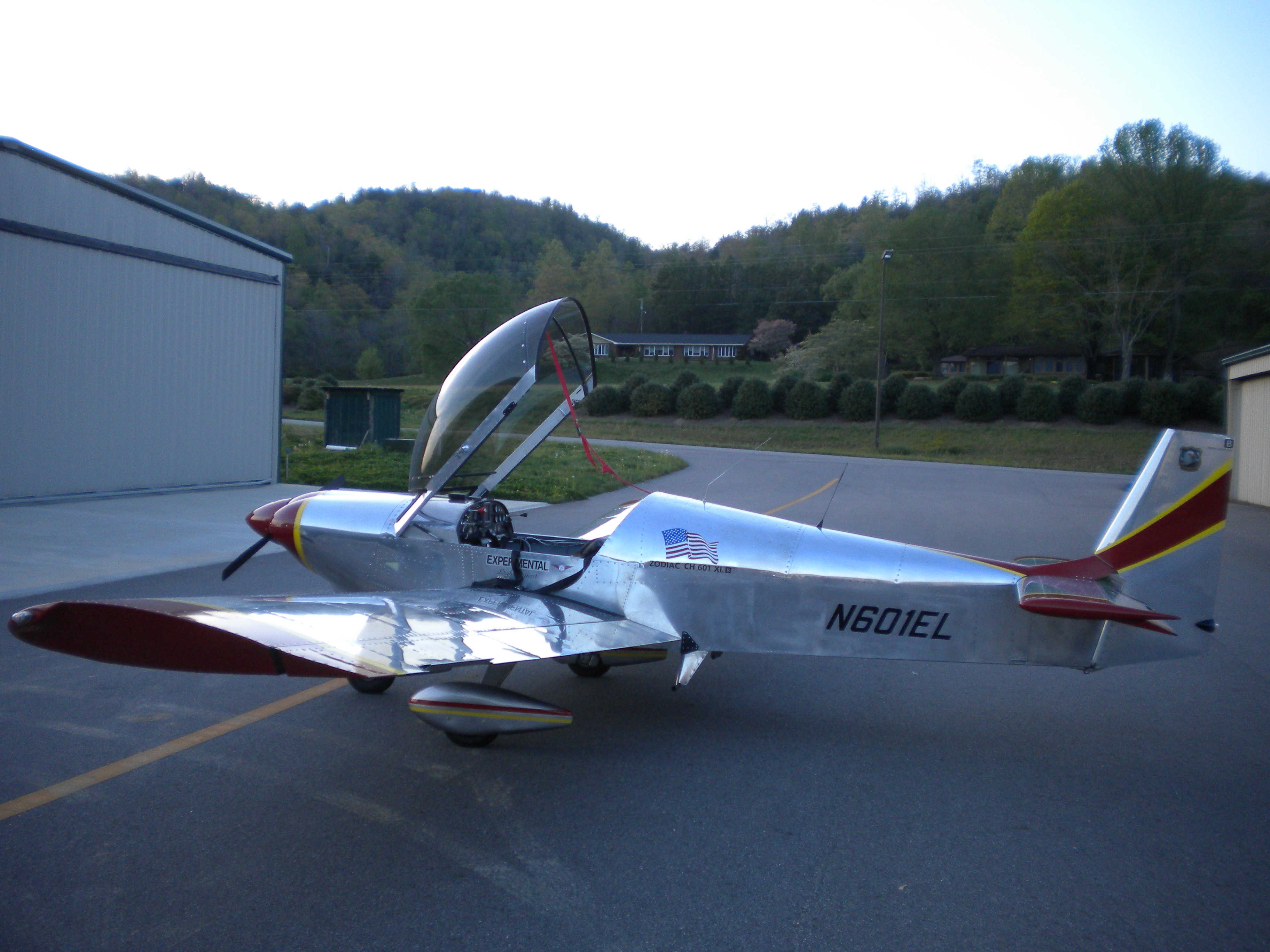

Congratulations Sabrina on installing the balanced ailerons and on your award! Your plane looks terrific and I too felt the extra weight of the ailerons but I feel more comfortable flying now than before. In fact, I just finished a flight from North Carolina to Glasgow, KY several weeks ago that worked out very well... that was after completing a second Phase I flyoff in North Carolina. The first was completed in Palm Beach County, FL. BTW, your weight distribution on the ailerons sounded almost identical to mine. Here is a photo of my recently completed 601XLB.
Revised W&B added a total of 70 lbs with wheel pants, upgrade and heavier seats.

What are the white circular things on the bottom front of your engine
cowl? (Machine guns?)
