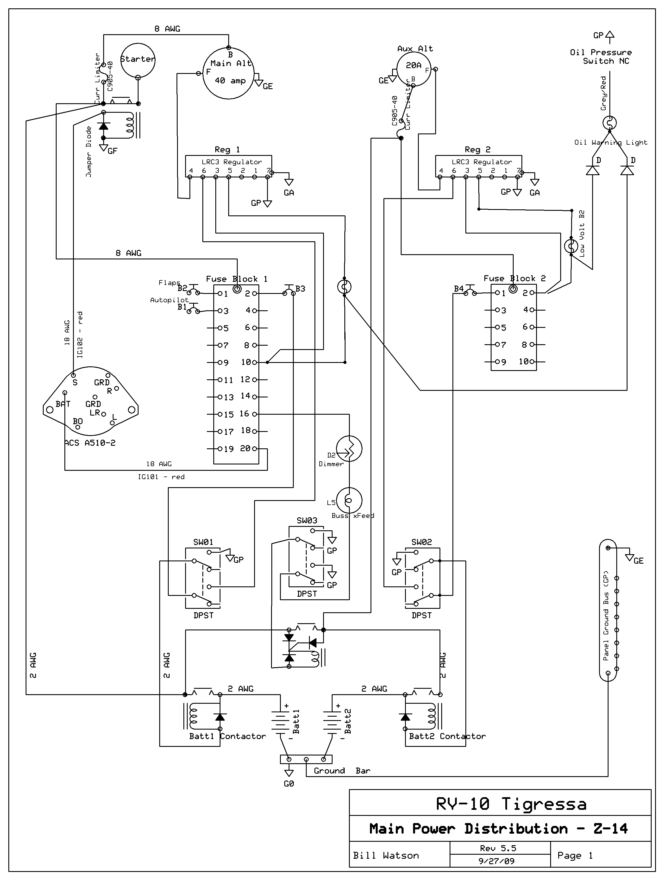

PostPosted: Tue Jul 19, 2011 11:38 am    Post subject: Load Analysis Spread Sheet Reply with quote
You are going thru the same process as all of us have. Look at everything you can find, steal as much as can and along the way you'll get you're head wrapped around it. My worksheet with load analysis is attached.
I assume you are already familiar with Bob's Z-designs (a collection of well vetted electrical architectures for our machines). Starting (and staying) there is the way to avoid re-inventing any wheels. My version of Bob's Z-14 is also attached.
On 7/19/2011 3:20 AM, mike wrote:
Kind of a beginner's question here. I am sure someone out there has a good example of a Load Analysis, or perhaps something in visual basic, accounting for varying power loads in their design? I am looking for a coherent graphic of an electrical architecture that might be modifiable towards the design I have in mind. Failing that does anyone have a laundry list of power consumptions of representative airframe equipment found in light aircraft I could use as a starting point? Just trying to save some re-invent the wheel time.
Thanks in advance,

Tigressa_Wire_Book_and_Load_Analysis_GRT_-_fuse-centric_V2.8.xls
Download
 Filename:  Tigressa_Wire_Book_and_Load_Analysis_GRT_-_fuse-centric_V2.8.xls
 Filesize:  425.5 KB
 Downloaded:  558 Time(s)
