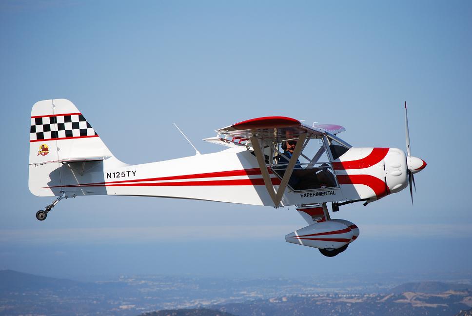

I'm not a Speedster guy, but my plane slows down about 5 when I put on the wheel pants. Of course, they were made for a DC-3, but they look COOL. (See photo.)

Well, it certainly depends on the pants. Modern laminar flow pants only
marginally bigger than the wheels will dramatically reduce drag. Pants
like mine that are turbulent flow and four times the cross sectional
area of the tire don't reduce drag. (Especially with 1/2 the wheel
sticking out anyway!)

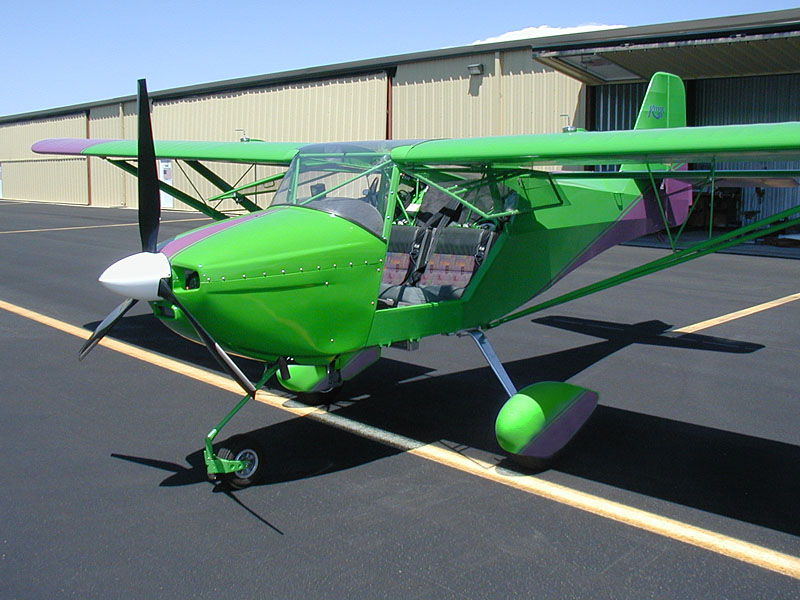

Mine must have been a better fit because when I installed the main
gear pants on my Model IV-1200 Nose-wheeled Speedster (shown here
without the nose wheel pant installed), I picked up something in the
neighborhood of 5-7 knots at cruise power.
Mike G.
Kitfox IV-1200 Speedster
Phoenix, AZ

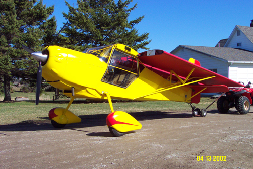

Ten years ago I installed wheel pants on my S5 and noticed an immediate speed improvement. Not a lot, but 3-5 mph at cruise which adds up and saves fuel. I have a farm strip that can be wet and somewhat muddy in the spring time which makes a mess of the airplane, thus the main reason I installed them. No more mess. I leave them on now year around. I don't fly in the winter time so snow and ice is not an issue.
Deke
NE Michigan
S5/Soob/465TT
