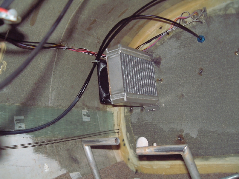

My cabin heat comes from a small (6" square) aluminium heat exchanger (radiator) in the cockpit with a small fan attached to it (computer type fan). The heat exchanger is fed directly from the main engine coolant flow with a 5/8" take off point just before the main rad. and a return just after it. When i want heat I just turn the fan on. It doesn't make the cockpit hot but it is sufficient in a UK winter to make flying a pleasure not a pain! I tried taking hot air from the exhaust can but really didn't like the idea that much and it let a lot of noise into the cockpit too.
Barry
G-XPXP 912 tail-dragger 19 years old and 999.45hrs
