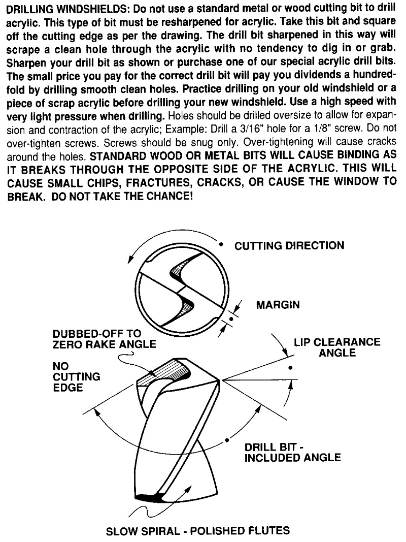

hi guys, I had received advice to blunt the drill bit so that it grinds as opposed to bites into the material. Some of the local guys referred me to this US video on the subject.
http://www.eaavideo.org/video.aspx?v=1200008869001
I have not tried it yet but believe that it may be correct as my second crack in the canopy occurred with almost no pressure and a brand new unused high quality drill bit.
I would be interested to hear your thoughts on it.

The classic trick for drilling acrylic is to reduce the "Rake" on the drill bits used. This means the bit cannot bite into the plastic but rather takes either a very shallow chip or just melts through the plastic.
I hand grind my own drill points, so it is easy for me to reduce the rake to zero on drills for acrylic. I'm not sure that is what I did. Instead, What I tend to do is to use a very slow speed on my battery powered drill and also I tend to use step drills for this kind of drilling. Step drilling can be done either by using a store bought step drill (looks like a Christmas tree) or buy using steps of drill size so you are only taking a small bite out of the existing hole to enlarge it a little bit.
The reduced rake trick can be simulated by running the drill backwards. This ensures you don't take any bite at all out of the plastic but melt your way through. It is an extreme approach, but works just fine.
Paul

PostPosted: Thu Dec 29, 2011 9:54 am    Post subject: Cracked Canopy Reply with quote
Hello Listers:
Attached is the drill geometry LP Plastics, the people who make the windows, suggest.
The important part is the "dubbing" of the cutting lip rake angle. An off the shelf drill has a positive cutting lip angle which will "dig" into soft materials like brass, AL, or plexi. By dubbing the rake angle to "0" or a slightly negative angle, the cutting edge "scrapes" the material in front of it rather than digging in which is what cracks plexi. Since this scraping action does not result in the drill self feeding or pulling itsself into the material, it only cuts by you applying pressure. Dub the cutting edge, apply pressure judiciously, and always back up the work with a piece of wood so the drill doesn't burst through upon penetration.
The drill still "drills" the hole by removing meteral, it doesn't burn through it. To see many other diagrams to clarify, Google search "drill dubbing", lots comes up.
RE Lexan: Arn't there two very good reasons Lexan isn't used for aircraft cabin windows?
1. It scratches much easier than plexi.
2. And more importantly, it's what is used for bullet proof and shatter proof glass, so in a crash, rescuers can't break through to get occupants out, that's especially bad if there's a fire!
Randy, Las Vegas
 Filesize:  307.93 KB
 Viewed:  24156 Time(s)
psm(at)att.net
