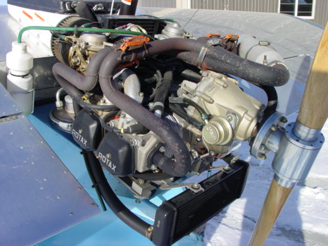

Thom Riddle
Posts: 1597
PostPosted: Mon May 29, 2006 4:44 am    Post subject: Re: Valley Engineering question Reply with quote
Richard,
I know your question is about noisy VW engine exhaust but your question is of course applicable to all 4 stroke engines.
I used to own and fly a Titan Tornado with 912UL engine. The builder of this airplane made his own exhaust system instead of buying Titan's ridiculously expensive and outrageously loud exhaust system. The Titan "system" was simply a 4-into-1 collector with no muffler at all and was notorious for its noise. The builder of my Tornado built a 4-into-1 collector with a short glass-pack style muffler of about 4" diameter and perhaps 10" long coming out of the collector. I'm guessing the muffler weighed maybe 3-5 lbs. My old Tornado was the quietest of any Tornado I've every heard. Bob Bean can vouch for this as I've done full power buzzes of his place just to see how noisy it was(n't).
Bottom line, no 4--stroke has to be loud and the weight penalty for a major noise reduction does not have to be that great.
Notice whole system sits above engine. Something like this might work for a VW.... don't know.
