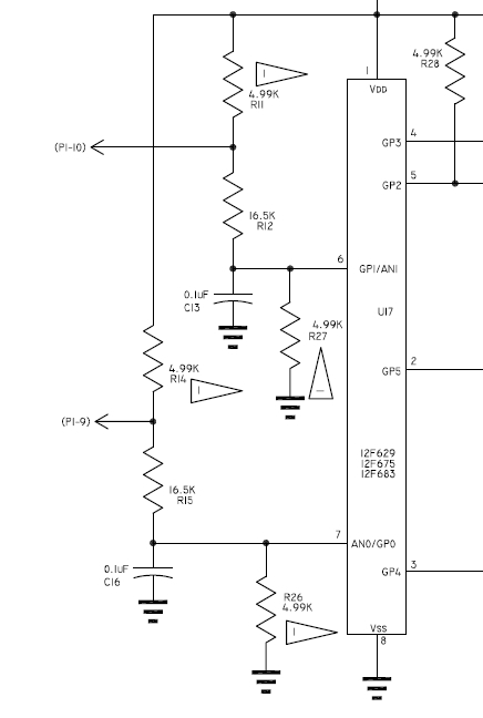

Had a little hitch in the assembly task. Found a layout
error on the board and some scrambled numbers in the
connector pin-outs. All has been fixed, a board stuffed
and static tested. The SOIC-8 mos-fets will sink 1.5 amps
with no more than 0.040 volts drop. Higher currents will
be proportionally higher but still quite satisfactory to our
needs.
The revised data package and pictures are posted at:
http://tinyurl.com/6w9vndk
I'll mail you a proof-of-concept board, test harness
and enclosure to work with on Monday.

This project was conceived as an alternative to
the automotive 3-terminal flashers that don't work
well on LED landing lights.
As you can see from the wiring diagram in the
data package that the control switch doesn't
carry lamp current . . . so it can be a minature,
low current device.
We hadn't talked about timing options. But there
are a couple of extra inputs to the board that
could be used to select flash rates.

Yes. I think I've got the inputs configured wrong.
They'd need +5 pullup resistors and I've condifigured
them with voltage dividers . . . but we can work that
out.

We might talk about modifying the code (and the boards)
to use the extra two inputs as flash-rate selection pins.
I think I'd move the command lines over to the filtered
pins now 'rigged for analog' and use the two unfiltered
pins for flash rate selection.

Are you in possession of the tools and skills to work with
1206 surface mount components? The board I sent you has
[img]cid:.0[/img]
R26 and R27 installed. Those need to be removed
and replaced by R11 and R14. I don't try to 'save'
a removed SMD component. So I'd wick the solder off
the two un-needed resistors and install two new ones.
Why don't I assemble the second board configured for
two sets of control inputs and you could put the finishing
touches on your code.
I would think that three rate settings would be enough, maybe
45 flashes per minute for the default rate, and then 90 and 120
flashes for higher rates. That would be the flash rate for
each of the lamps, alternating lamps to get the wig-wag.
The LEDs are much more effective at the high rates than
incandescent lamps. 3 events per second is supposed to
be the 'magic' attention-getter. Those values sound good to me.
I would think that 3 rate settings would be enough using the
same type of switch you have on the other set of inputs.
Let me pray over some controls topology for adding
independent control of the two lights.
