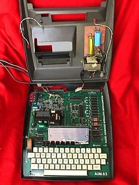

Hmmm . . . we could go back further still
and consider the seedling efforts of PARC
where they were playing with multi-tasking,
windows-like desk tops, etc. etc. I think "Lisa"
was their first table-top computer that offered
consumer-friendly features. Rumor has it that
a lot of features that turned up on original offering
of Microsoft and Apple had genesis in visits by
Jobs and Gates to the PARC facility at 1980 Porter
drive . . .
I learned to do 6800/6500 assembler on the AIM-65.
[img]cid:.0[/img]
A couple years later that a Kaypro II offered formatted
printout of spell-checked word processing. The first chapters
of the 'Connection were done on the Kaypro but ported
to a XP running WordStar before it got printed. The camera
ready two-column printout was done on a daisy-wheel printer!
