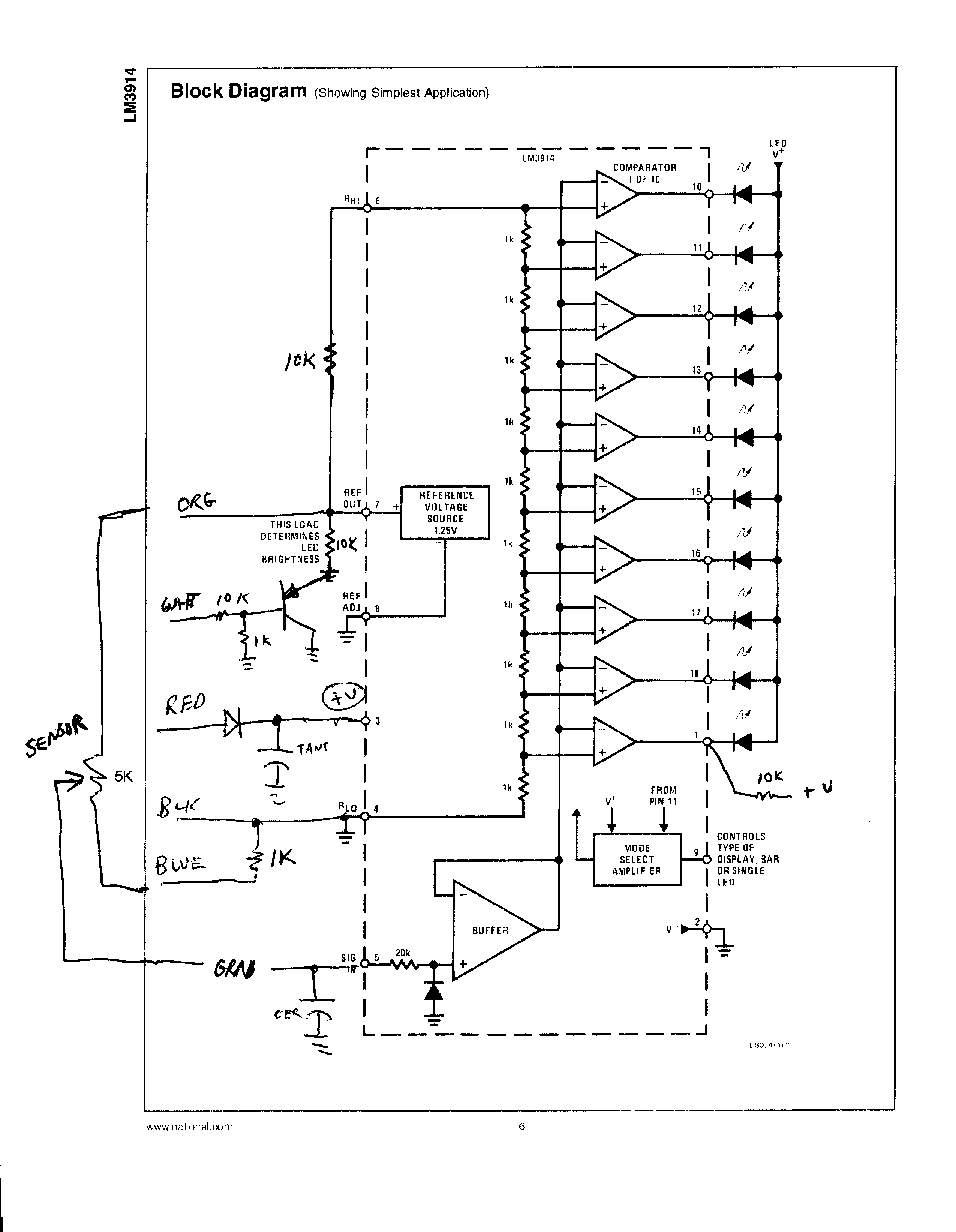

PostPosted: Tue Jan 01, 2013 10:52 am    Post subject: Indicator Help Reply with quote
Here is the schematic for the Ray Allen indicator. As shipped it uses a 5k pot. Since the wiper of the pot drives a high impedance op amp node you could just add a 10K resistor in parallel with the
10K pot in your actuator (between white and yellow) and the LEDs should work properly.
With this schematic you should be able to figure out how to connect the actuator to the indicator. My best guess is shown below:
Actuator -> Indicator
White -> Blue (Common)
Yellow -> Orange (+V)
Blue -> Green (wiper)
If the pot is isolated then the orange and blue wires can be swapped if the indicator operates in reverse to what you want. If the actuator pot is not isolated (I assume it is) the the Ray Allen
indicator will not work quite right (the indicator blue wire is not at ground potential), but may be okay for your application.
Dick Tasker

PostPosted: Tue Jan 01, 2013 7:32 pm    Post subject: Indicator Help Reply with quote
Nati Niv wrote:
<snip>
4)Last but not least: do not pay attention to the difference in pot impedance. The Allen Ray indicator will work just fine because it actually measures voltages between 0 to 12 volts and also both
the pot circuit in the actuator and the input circuitry of the AR indicator are isolated from ground, you should have no problem with the AR indicator if connected properly.
It actually does NOT measure voltages between 0-12V unless they have changed the design recently. See the circuit diagram I sent earlier. It measures from an internal 1.26V reference through a 5K
pot and a 1K resistor in series.
And it is Ray Allen...
Dick Tasker

PostPosted: Wed Jan 02, 2013 6:02 am    Post subject: Re: Indicator Help Reply with quote
As Dick Tasker posted, the reference voltage for the Ray Allen pot, which is routed way way way back to the trim box--probably right along side transmitter cables, etc, is 1.26V. This is the full-scale voltage available to the op amp feeding the bar graph circuitry. At the first digit it is 0.126V...and how anybody can expect no interference from transmitters, strobe...well, when pigs have wings, bacon will fly.
The venerable LM914-based bar graph display is difficult to get (or make) in a sunlight readable form. These have succumbed to microprocessor-driven displays.
I have posted several notes on this over the years, and have built a few devices to allow various options.
But I want to say that the Ray Allen trim box is really a pretty good part. There are only a few things one can do to improve it. And I am not at all sure the alternative parts are any better.

[quote="retasker(at)optonline.net"]Here is the schematic for the Ray Allen indicator. As shipped it uses a 5k pot. Since the wiper of the pot drives a high impedance op amp node you could just add a 10K resistor in parallel with the
Dick Tasker

I believe adding a 10k parallel fixed resistor wil not add anything to the issue. True the total load on the power supply would be equal but the voltage divider provided by the potentiometer would be unaffected. At the center of travel the source impedience of the potentiometer should look like 2.5k with a 5k linear pot and 5k with a 10 k pot. The input of the indicator should not care if it is a high impedience >100k. If less than that it will become more noticeably nonlinear.
Ralph

You are correct in your analysis except you neglected to note that the 5K pot is in series with a 1K resistor. With the
5K pot the voltage going into the op amp will vary from 0.21V to 1.26V. With a 10K pot it will vary from 0.11V to
1.26V. This will cause a small dead band in the indication at the bottom end of the travel of the actuator while the
actuator moves enough to cause the output to move from 0.11V to 0.21V - almost 10% of its travel. If you parallel a 10K
resistor with the pot the op amp will once again see 0.21V to 1.26V and the indicator will properly indicate the
actuator position.
Of course, depending on how much the actuator actually moves this may be irrelevant.
Dick Tasker.
