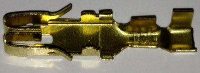

So many connectors and no good way to sort through them all.
Does anyone know what terminal this is ?
http://www.qenesis.com/Temp/terminal.jpg
Thanks !

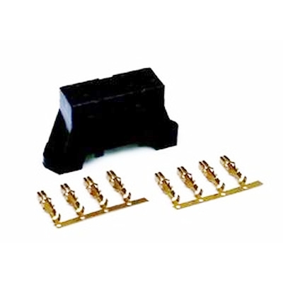

That terminal is used in a variety of products
including holders ATC plastic fuses where the wires
come in through the mounting surface to the back side
of the holder or, in this case, up under the fuse
holder from the front side of the mounting surface.
http://tinyurl.com/bl7b7ku

Thanks Bob !
These seem to be pretty uncommon, since Digi-key, Mouser etc. don't seem to carry them. Now that I have a part number, it is clear why I had trouble finding them before.
Once again, you have saved me a lot of time. Thanks !

Jeff,
I used a rear feed fuse block that used these terminals. There is also a
removal tool for them that was useful. Here is link to a website that has
the terminals, blocks, and exctraction tool.
If the link doesn't work, the company is MIH Industries.
Hope this helps.

Wow. That helped a lot. Turns out this terminal is used in many GM vehicles, so lots of auto parts places have it.
In case anyone else is looking for it, search for PackCon III. They are available for different size wires.
It seems the automotive ones are not plated, but rumor has it that the John Deere 57M7508 is.

Another good source for this and other electrical connection products is
Waytek Inc. www.waytekwire.com
