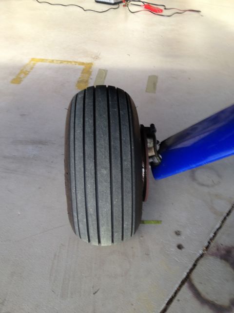

I can't resist jumping into this one. I have 106 landings on the original Van's tires. I have only filled them once - when I built them. They still have 42 in the mains and 40 in the nose. I don't have wheel pants (hate 'em). Here is a photo. Notice no uneven wear.
John

Did you remove the wheel pant brackets? Probably not. I have all the fairings, but no pants. My hubcaps probably give me a knot, as well. I'm guessing that the lack of pants costs me 5 knots, max. The ability to pre-flight the wheel every time is worth it - form follows function.
John

John, you started out with 42 psi and one year later ended with 42 psi? You have some super rubber there! Or maybe every time you fly with your tires exposed, the 160 kt air molecules are keeping the pressure maintained.

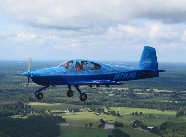

Actually, I don't think the wheels are ugly. I guess it's just my background. I learned to fly in the Navy and on every airplane I ever flew, you could see the tires. Now that I'm long retired from the Navy and Northwest Airlines, I have finally seen airplanes with pants. I just plain don't like the looks of them. The RV-10 looks like it has watermelons where the tires should be.
I understand the drag thing, but it was pretty obvious that you are only loosing a couple of knots per wheel. I cleaned up the wheels as much as I could and added hubcaps to the mains - painted to look like the wheel of an AF-18. I actually experimented with a small airfoil directly behind the tire but never had the guts to test them. I was concerned about vibration and harmonics.
I'm happy with the results. Besides, think of all the money I saved by not having painted watermelons...(g)
