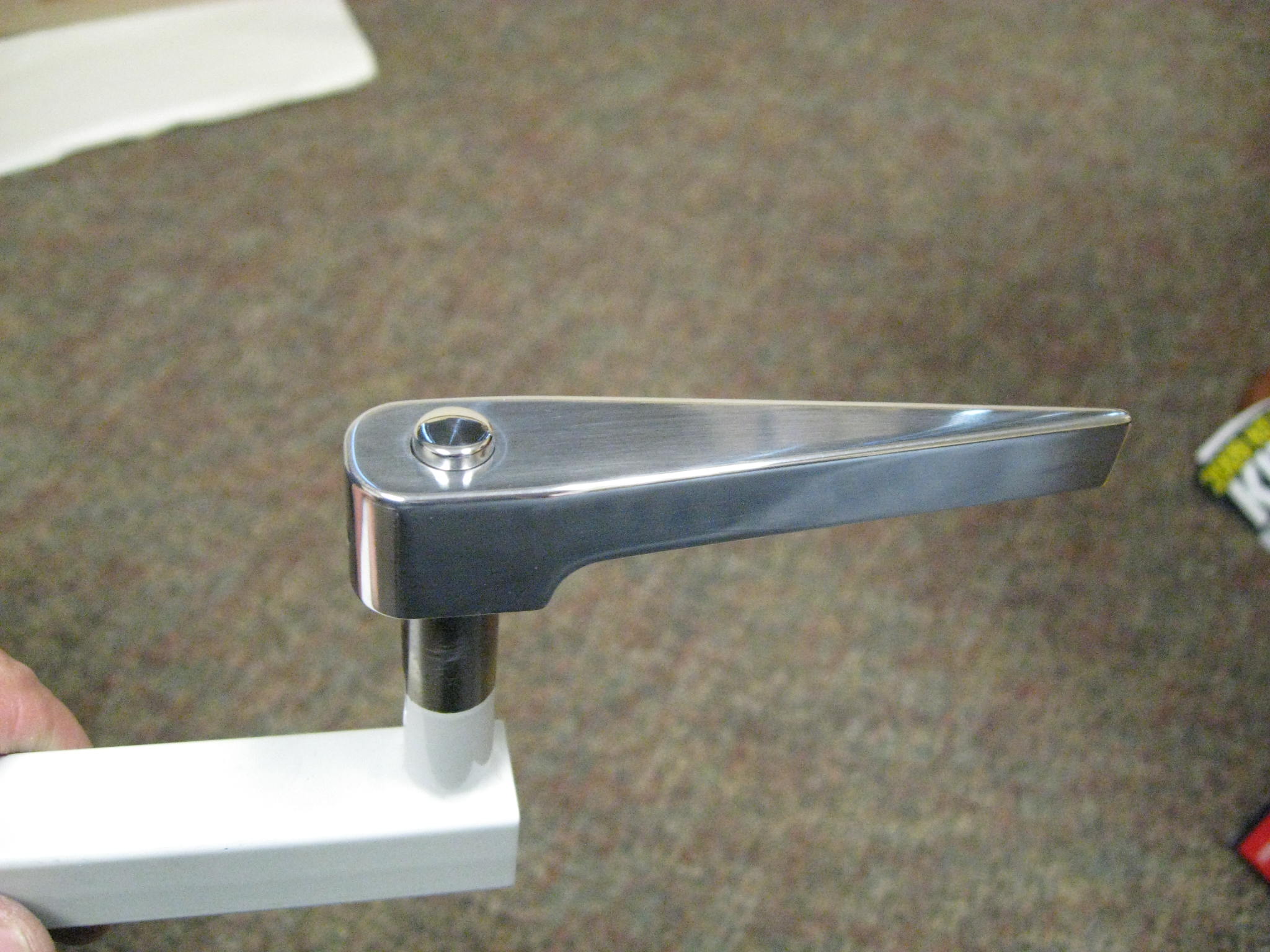

I never found a lock that I really liked so I just take my door handles off
and put them in the baggage area.
If they want in that bad they are going to break something anyways.
(Stock door handles)
Geoff

I do the same thing Geoff mentioned. I did this in Mexico and Bahamas.
Takes just as long to take them off as a lock would take.

Easiest solution seen to date, thanks!

Great idea, I just might use this or the wedge idea for the right door and remove the outside handle on the left. Thanks for all of the creative ideas on this thread.
