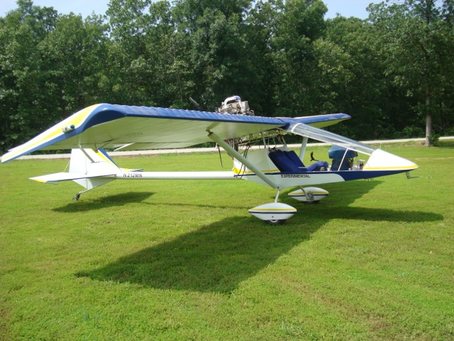

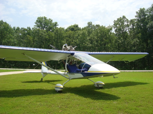

Bob Bean, asked me to post this for him, since he no longer posts to this forum, but thought it might be of interest to other MKIII pilots.

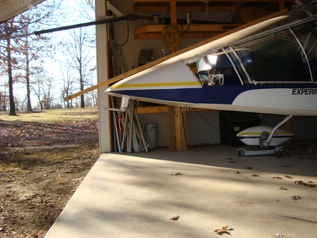

MKIII owners: I have for years intended to change the incidence on my wings and tail. I drilled new holes in the spar attach ears probably three years ago
but, somehow never got around to it. -until this year. The reason for doing it pertains more to my individual plane than a stock MkIII because of my wide windshield design.
I felt a conflict of airflow between it and the wing angle, much like what happened with early versions of the Xtra. -Too much down pressure on the nose.
I drilled the new wing holes about 5/8" above the originals which works out to about 1.326 degrees. I bought the adjustable tail brackets from Kolb but
modified them substantially. They were angled to allow wing fold using any of the holes but this makes the HS stick out too far at the lower settings.
I cut the ears off to the same width and drilled new holes for two settings.
I used a combination of calculation and guesswork to figure what range I would need. I went with the highest holes which yields about -3.5 degrees from the engine mount,
figuring the tail boom is -6 degrees. Good thing, because with those holes I can still fold the tail without pulling any bolts.
I had crow hopped it a couple days ago and parked it without real flight. Today was perfect flying weather so I did a test flight. Naturally I was hoping not to
encounter any "lawn dart" characteristics and I was either a very clever guy or blessed with dumb luck, take yer choice, because it was perfect first time up.
I had previously been flying with one notch up on the trim, but for this occasion I lowered it to zero. -Just right. Neutral stick at normal cruise and
slight back pressure for full throttle straight and level. All other trim stayed the same. There is a noticeable increase in dihedral but I didn't get to
doing any rudder experimentation to see how much it is affected.
The plane feels as if it has been freed up from an invisible restraint. Hard to describe but I was quite pleased. It appears to cruise about 5 mph
faster at normal settings. I didn't look close to check full throttle speed, just how muck stick it took. -Full throttle speed doesn't matter to me
because I don't use it for other than climb.
I couldn't say whether a standard configured MKIII would gain from the same changes but you would definitely need the tall steel legs to compensate.
Also, because of my center section design, the angle could be changed without any extra work.
Reminder: Previous written by Bob Bean, I'm merely posting it for him and I have no further information on it than you now do. However, since many may not be familiar with Bob's customized MKIII, I've attached an old photo so you can see what his airplane's nose and center section look like.

Mike Welch
Joined: 13 Feb 2011
Posts: 272
PostPosted: Fri Jul 26, 2013 9:39 am    Post subject: MKIII wing incidence Reply with quote
Dennis,

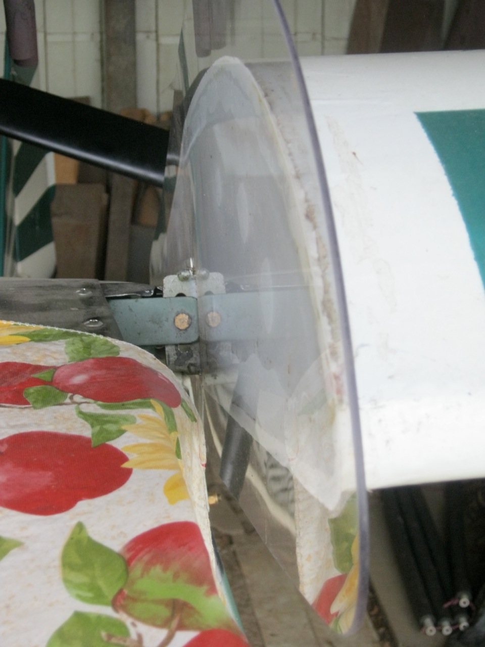

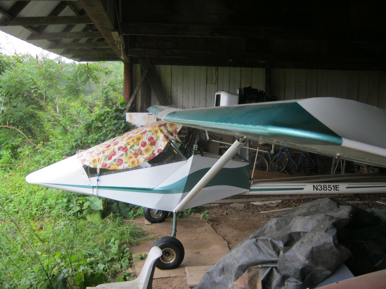

Pardon me if I cut into your conversation to Thom (since both Bob Bean and I have made the "new incidence change.)
Bob Bean had some kind of fender-bender several years ago, and made his own replacement nosecone. If appears to
be a hybrid from the original round nosed MkIIIC and the wedge shaped X. (Mine is a pure TNK part)
In keeping with all the other changes I made to my OEM MkIII C, I added the newer, taller, steel gear legs. This necessitated
an incidence change to the main wings from the "high angle" to the new lower angle, found on the new Xtras with the taller steel
gear legs. Bob Bean was making the changes I already made a couple of years ago.

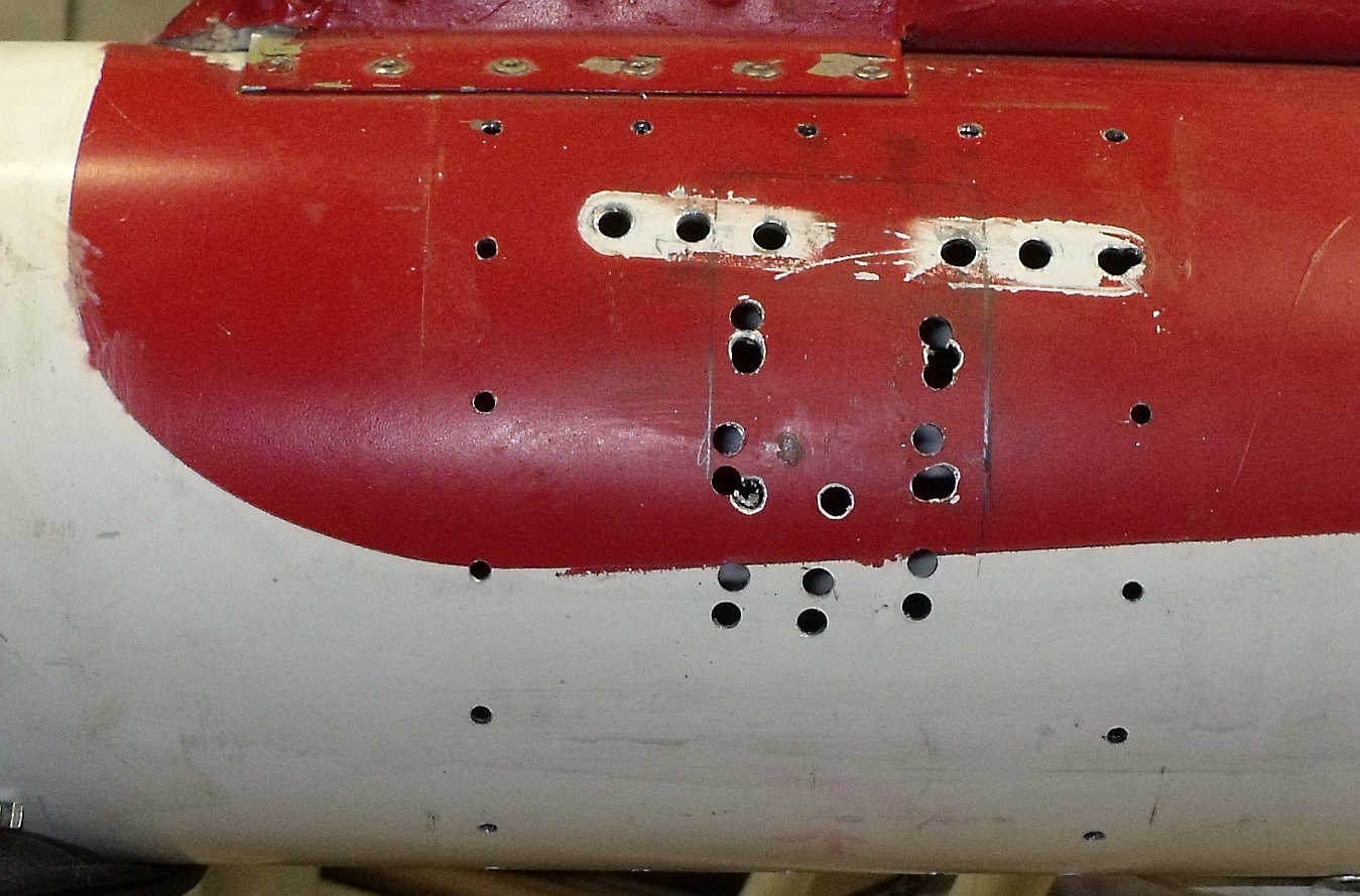

As I remember correctly, the Kolb instructions told us to drill a hole "UP" 7/8" from the bottom of the tab. (or 5/8". or 3/4"…whatever it said)
Again, from a fading memory, it's been a long time since I did that….this would give an effective angle of attack to the MkIIIC main wings of around
+9 degrees, give or take a degree ( I think….) But! If you are going to add the tall steel gear legs, that high angle of attack doesn't work nicely
with 3-point landings because if you have such a 'very high' angle of attack, you will find yourself being launched into the air just as the tail end
drops too far.
Therefore, to counteract this problem, Bryan Melbourne lowered the incidence of the wings, which also required a lower horizontal stabilizer
angle, too. Plus, the wide Xtra nose figured into the deal, but we'd need Bryan to chime in tell explain all the details.
To achieve the "new lower wings' incidence, a builder would then drill the tab hole that same 7/8" distance…..only this time he down came from
the TOP of the tab, not up from the bottom. I think this gives about an 1" to an 1 1/4" distance between the holes. At any rate, now, by inserting a bolt through
the UPPER hole, you will be lowering the wings a fair amount. As it turns out, the final intended angle (from Bryan (at) TNK Co) is +3.4 degrees (instead of that
+9 degrees for regular geared MkIIICs of Xtras).
Later, in discussing this angle change with Bryan, he said we were looking for "2.8 to 3.4 degrees". When I did mine, I came up with 3.4 exactly, 'cause that's what
I was told. If I remember correctly, our buddy Scott Thompson came up with near +2.8. I think this is why I called and talked to Bryan. Evidently it was "a range"
we were allowed, centered around +3.0.
With all this main wing incidence changing, you have to also take into account the rear horizontal surfaces. The leading edge of the H.S. must come down
a couple of degrees, in order to work well with the "reduced angle main wings". What that angle measurement is exactly we don't know yet, and we are waiting for the
Bean to get back to us. He believes he nailed it on the first try. I'm anxious to know what the digital angle reading is. I asked him if he could also take a reading
of his main wings, too, while he was at it, to help me establish a sort of basic logical platform to deal with.
NOTE: All angles, readings, etc. are assumed to be read with an initial setting of the MkIII boom tube propped up to "6" degrees (or -6 degrees) EXACTLY.
It is whatever makes the motor mount "0.0"!! BTW, I think the hor. stab is supposed to come in at -4.8 degrees. That is where I have mine set at. I have 3
other holes to choose from, 1 upper, 2 lower.
My plane is almost finished, but medical issues and finances are slowing me down at the moment.

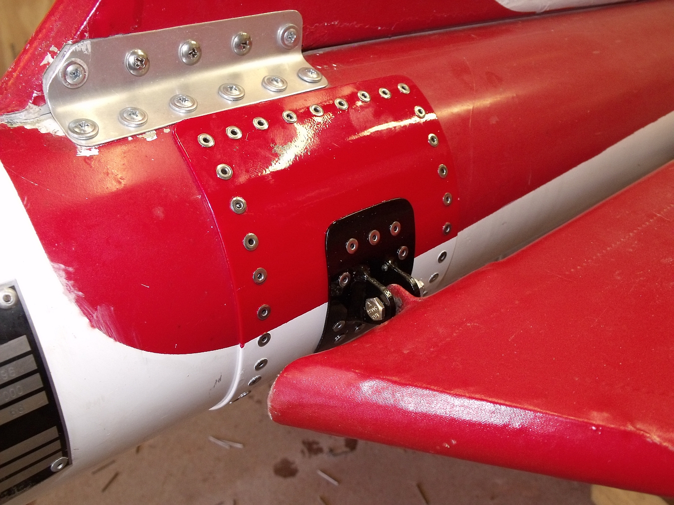

Here is a photo of when I attached the Xtra nosecone to my completely rebuilt MkIIIC front end. (first photo) I used exact measurements from a OEM Xtra fuselage
to modify my MkIIIC fuselage. (Pat Ladd's wrecked frame) The stick on top was to show a different member the intended angle he should achieve. He was going
to do the MkIIIC to MkIIIX change, too, but I haven't heard from him in a year and a half.
Oh yeah. You are correct, Dennis. Yes, the wing incidence change will require you to make a new, (probably custom) wing gap seal. I did mine out of fiberglass,
under which is housed the ballistic chute in the front compartment. (see second and third photo)
We now return you to your regularly scheduled program.
Mike Welch
By the way, you can see the increased dihedral from all the "normal" MkIIIs. When you use your old struts, like we did, and you lower the leading edge, you
end up increasing the dihedral to about double the O.E. setting.. From what I've heard, this is a good thing. (It ends up being close to 3.0 degrees)

On Jul 26, 2013, at 1:38 PM, Mike Welch <mdnanwelch7(at)hotmail.com (mdnanwelch7(at)hotmail.com)> wrote:
[quote]Dennis,
drops too far.
Mike Welch
<DSC00753.jpeg>
<DSC01413.jpeg>
<DSC01405.jpeg>

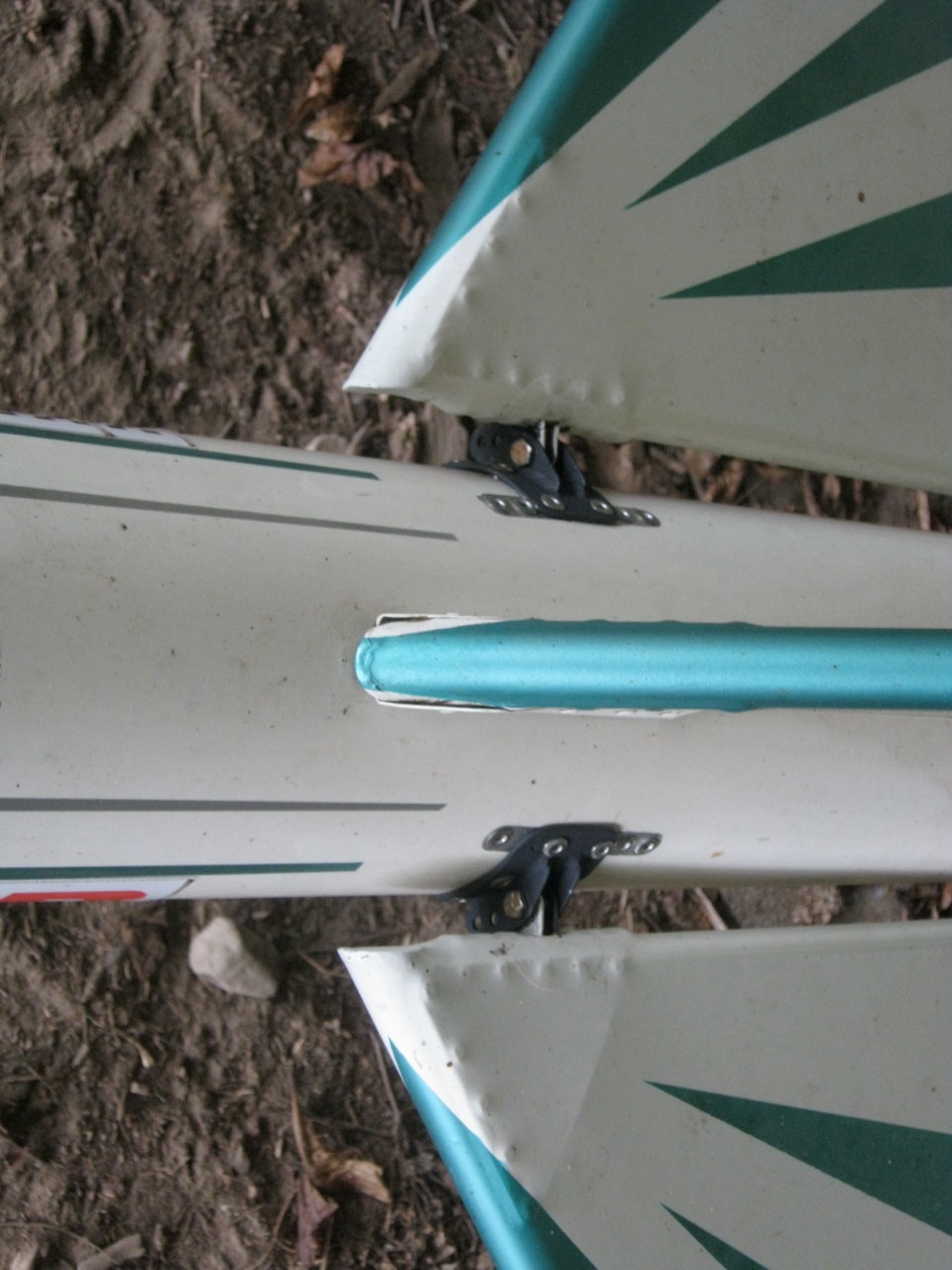

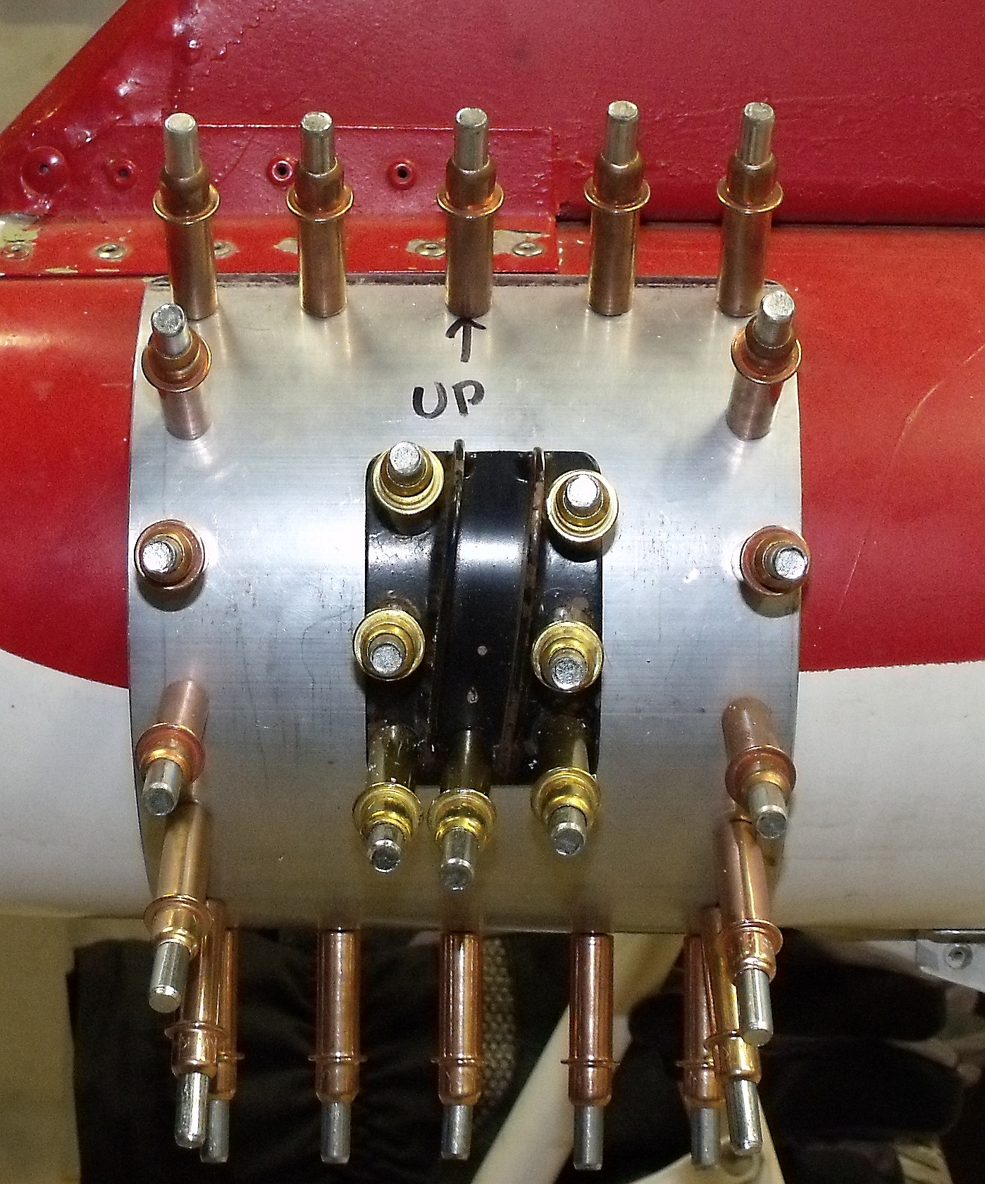

Thom Riddle
Posts: 1597
PostPosted: Tue Jul 30, 2013 6:10 am    Post subject: Re: MKIII wing incidence Reply with quote
Bob Bean sent me more info on his wing incidence mod, as follows:
My plane was not the result of a "fender bender" but the combined parts of two other guy's wrecks. There was no nose cone
included in any of the parts and I wanted more foot room so the wider nose was the result. It comes off with 10-32 machine screws
for accessibility.
BB
a visual of the new dihedral.
 Filesize:  345.71 KB
 Viewed:  17067 Time(s)
modified HS ears. Now at the top holes. I refilled the old empty rivet holes with new rivets and was able to reuse some of them on the new brackets.

The new wing holes in use. (note top ones for an even more extreme change)
Also note how the top of the windshield is considerably below the top of the wing and lower than both the classic and the xtra. More air can flow to the prop.
