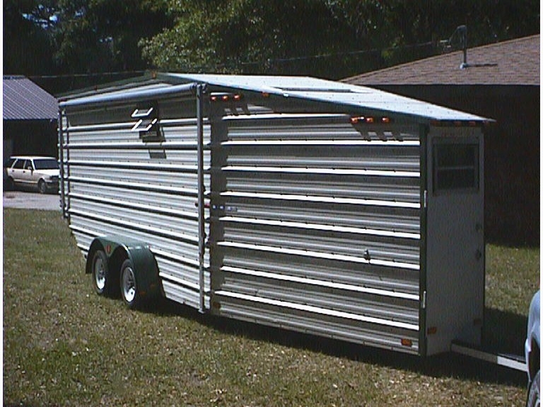

Posted: Wed Jul 05, 2006 7:51 pm Post subject: Re: Something New!!!!!! -Evolution Of a Kolb Trailer |
Hello Rick,
I was out of the country for a month touring Poland (Hey Big Lar, I've got over 1200 pictures for you next time you pay me a visit!) so I am late posting. I have thought long and hard on how to best build a Kolb trailer pulled by a light 6 cylinder vehicle with 150 lbs max tongue wt. I have photographed & studied many smart people's designs and I believe I have combined the best ideas into an almost ideal trailer. The heart of the design is the basic concept of Dennis Souder's open air trailer I was thrilled to look at. He used a boat trailer with a rail down the center to guide & hold tailwheel & tail feathers up front. The brillance of the design was he had a dropped floor for the plane's wheels immediately behind the trailer's axle & only a few inches off the ground. It did not hit/drag on the ground because it was so close to the axle. That low height, meant you only had to lift the plane a few inches off the ground (translates easy to load!) When you use that concept in an enclosed trailer, it also eliminates the problem of scraping the leading eadge of wings on trailer floor. This concept forces the tongue weight up unexceptable high when using an enclosure as the axle is so far aft. I solved this issue by using 2 axles far apart (can't use leaf springs here) this also cushioned ride because when one wheel went into a hole, the other one still holds the trailer side up. The 2 axles apart was not enough to keep the tongue wt below 150 lbs. The secret was incorporating a truss just in front of the front axle, then using this truss to winch up the tail boom at the H-section behind the engine. This took all the weight that the trailer saw on the tail wheel & put it back on the front axle. My trialer now has the same tongue weight with my plane loaded or unloaded. There are many other things that help to make thing better/easier/more comfortable that I could share with you if you care to give me call, 352-307-9009 (just south of Ocala FL), but the dropped floor for plane's wheels; the 2 spread axles; & the truss to hold off the tail's weight off from the front, are the keys to the puzzle. I went overboard in details on mine & could have made it lighter than it's 2000 lbs by quit a bit, but it pulls perfectly straight with no wagging & this last Sun & Fun, I actually used my 4 cyl Ford Escort to pull it at 60mph! It is very streamlined aerodynamically, front & back, plus low to ground. I'll try to attach a picture.
richard swiderski
slingshot 003 waiting for my TIG welder to come in ( I cut out her backbone so I could drop my 175 lb, 110hp, turbocharged, intecooled, distributorless, port injected, dual computered, 2.32 : 1 SPG-2 gear redive, 3 cyl Suzuki engine)
