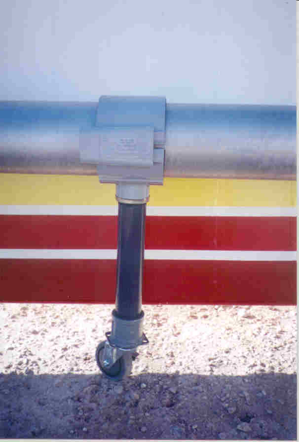

I just saw a picture in the photo gallary of a boom tube dolly made by erich weaver. I could not get an e-mail to go thru to him. Did not see on the list either. Anybody got an idea of what the saddle is made of?

The set up that I have is a plastic water pipe cut in half, just measure the
tube- 6 inches? and buy an 8 or 10 inch diameter piece of the pvc pipe, cut
it in half and put some carpet inside the pipe to cradle the boom tube. The
PVC at that size is big enough and tuff enough to bolt to and handle the
load.
Galen
| Quote: | >>>>>>>>>>>>>>>>
Erics boom tube dolly is a plastic irrigation Saddle that fits the 6 inch pipe and has a 2 inch pipe thread outlet…. When in the trailer it is attached to some type of attachment that goes to the floor of his trailer… during loading and unloading he screws a wheel into the pipe thread attach point…. To try and find the saddle I would try a sprinkler / irrigation supplier.
Boyd

That is called a "saddle tee" -should be available at any plumbing
supply.

Larry, Thanks for the suggestion. DId you attach a wheel to the support?

Thanks for the info. THose saddles are kind of expensive but may be worth
it.

Thanks for the info. I checked on price and they are kind of expensive but
probably worth it for the easy of loading.
