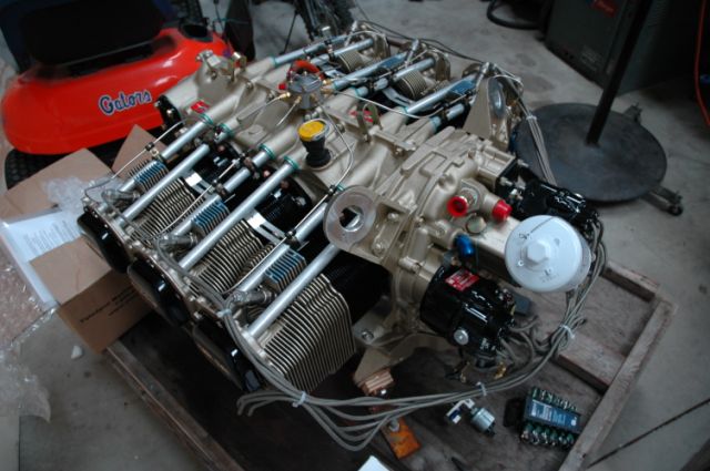

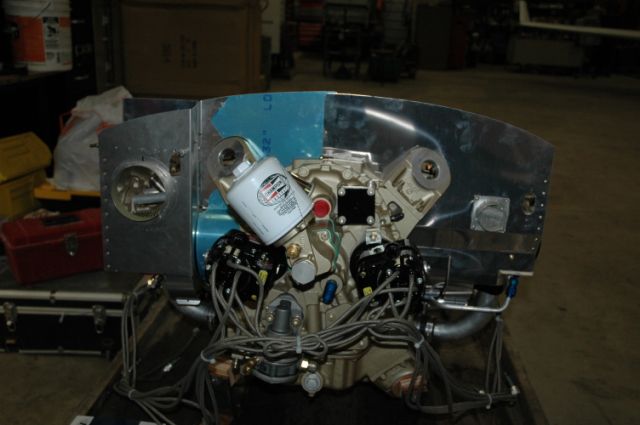

PostPosted: Thu Jun 15, 2006 8:05 pm    Post subject: Oil Filter Adapter Incompatibility Reply with quote
Is yours supposed to be in this position?  Where is the alternator supposed to go?
Do not archive.
Jesse Saint
I-TEC, Inc.
www.itecusa.org
W: 352-465-4545
C: 352-427-0285

PostPosted: Fri Jun 16, 2006 6:24 am    Post subject: Oil Filter Adapter Incompatibility Reply with quote
Jesse,
Yes, that’s the position.  Alternator is a 20 amp auxiliary unit (http://www.bandc.biz/sd20desc.html) that goes on the vacuum pad (all electric plane).  Interference is between the corner of the filter adapter/spacer closest to the vacuum pad and one of the case screw bosses on the alternator.  The folks at B&C have a “clocking adapter” that they believe solves the interference problem by rotating the alternator 45 degrees and moving it aft by 5/8”.  They are also looking at changing one bolt for a cap head screw on the oil filter adapter.  They are going to try the combo tomorrow and if all goes well will let me know.
Another builder (Ed in Oregon) also reported this to them about 2 weeks ago.  Apparently B&C understood that he was using a 2.5” spacer instead of the 1.4” and based on that it was proclaimed a “no go” by B&C.  Based on updated info on the size of the spacer they are certain that it will be a simple fix.  Standby for confirmation of the simplicity…
Bob

I think mine has the 2.5” extension.  Based on your calculations, will that be a clearance issue with the firewall or engine mount?
Bob

Based on actual installation (not calculations) the 1.4” spacer is the minimum needed to clear the diagonal cross member on the engine mount. I’ll take a look tonight and let you know if another inch will cause problems.
Bob

Actually, I just have the horizontal for now, and had the intention of
possibly adding a remote mount firewall mount in the future.
As it turns out, I don't know that I'll bother. Yes, the filter comes
toward the rear a ways, but it fits right in that firewall cutout
box. Using a 1" socket on a stubby wrench, it's been do-able. Not
perfect, but do-able.
I put a cut-down tupperware container under the filter, and it drips
into that, no drips on the engine at all. I fear that with a vertical
mount, I'd be dripping things down the filter mount when pulling the
filter. I like the remote mounts, when you can remove them
upside down...perfect for no mess. But, as I said, the horizontal
one hasn't been a problem....and I myself am surprised.
Also, I have used the Champion filter, the Kelley Aerospace filter,
and now the Tempest filter, and all work fine, even though
they aren't of the same lengths.
I just bought, for $5, one of the rounded oil filter twisting
pliers. (not the band type, but 2 big curved jaws) Got it
from Harbor Freight on sale. I'm going to see if that's any
easier than the stubby socket for removal, when you don't
care about torque values. I personally don't use a torque
wrench on the filter, and never have, on cars or planes.
After doing literally dozens of changes, I've never had a
seep out of any of them. The tempest filters supposedly
have a better seal too. So unless you're planning to torque
your filters with a torque wrench, I'm not sure if I'm seeing any
reason to go with any adapter other than the cheap horizontal...and
if I were going to get away from that one, I'd go remote mount
and make it really clean.
When someone gets the angled adapter going from B&C, I'd like
to hear how your changing experience is though. If it's great,
it would be nice to know.

The horizontal one gets very tight with the firewall.  In fact, without that box, I think it would not even fit, and certainly not be removeable, which would kind of defeat the purpose.  The angled one will be much easier to change, and from my research it sounds like punching a hole in the filter, especially the angled one, will allow air in and allow the oil in the filter to run out before removing it.  There will still be some left, but not as much as with the horizontal one.  Remote would be nice, but that adds more complexity as well.
As far as reports on how it works, we hopefully will have some in about a month.  If we aren’t doing an oil change by then, we will be way behind schedule (knock on wood).
